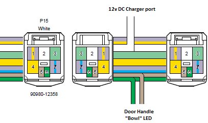

    Ground to any door bolt.

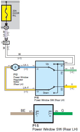

    Working on opposite mating connector part# to P15.(P14 & P16 also same)
    Fused Power terminal is female 090/2.3II type.

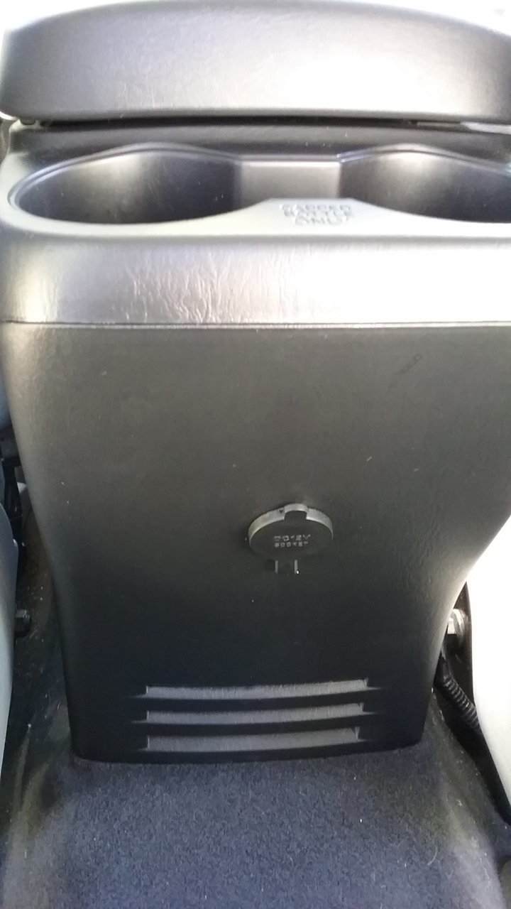

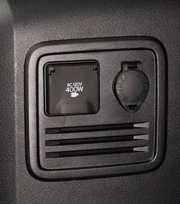

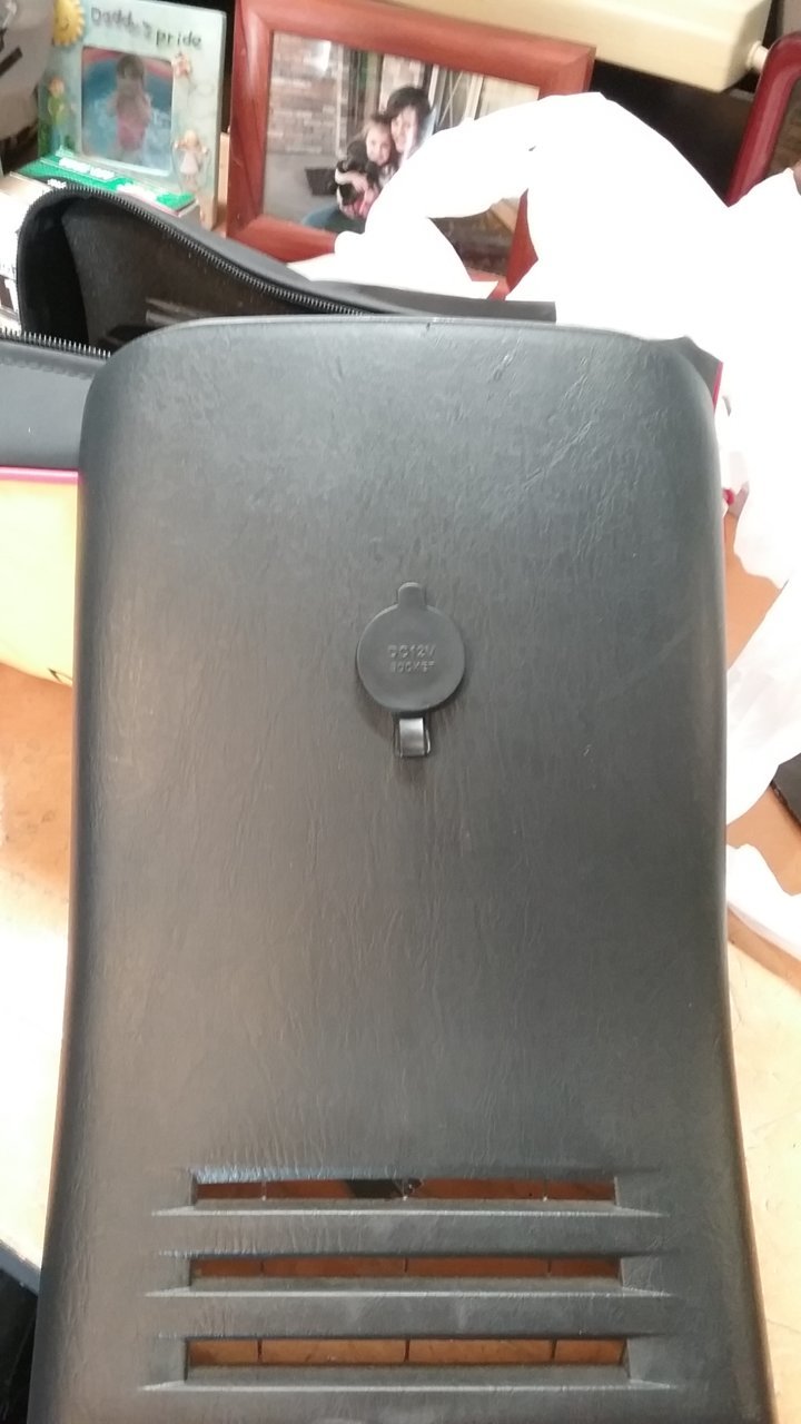

    For rear passengers back of center console via 400w always on inverter mod and combo 110 / 12v w bezel. Cutting the back of the center console is pretty easy.

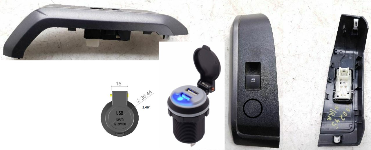

    Something to keep in mind; pretty sure that dual usb is going to be quite a bit bigger in diameter than the circle you have drawn on the window roller upper piece. Probably won’t lease too much material on each side. Just something to think of.

    You're stating that there is less than 2" on that door piece? There are so many choice usb in the market one could select. I won't do a drop down list.:D

    No. I’m saying that the size of your drawing doesn’t represent 2”. Maybe 1” at most. So, double the circle in your drawing that that will tell you how much is left. :)
    Of course, that’s assuming the USB is 2”. If it’s less cool.

    No,dos por uno. Can do straight 12v port on back of center console. Can do combo 12 and 110 at the same time and make it look nice. Better location, one spot serves the entire back row. And super easy to cut, no water concerns, easy access to wiring for add a fuse or piggyback or ...

    1.46"...it's tiny in the pic

    Ahhh. I see it now. Thanks for pointing it out.

    Something about kids, feet and short wire to their Nintendo Switch...

    I think back of center console piece would be a perfect spot for a MESO mod. He sets up the injection mold and figures out the right curves to beat that sort of lame and overpriced bezel. Which I tried as hard as I could but still didn’t get to sit flush.
