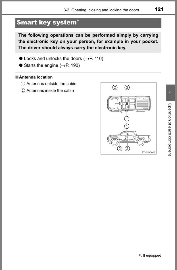

    The key antennae are at the centerline of the cab; one just forward of the Qi cubby above the airbag control box and one under the armrest storage on top of the inverter (if equipped ;)).

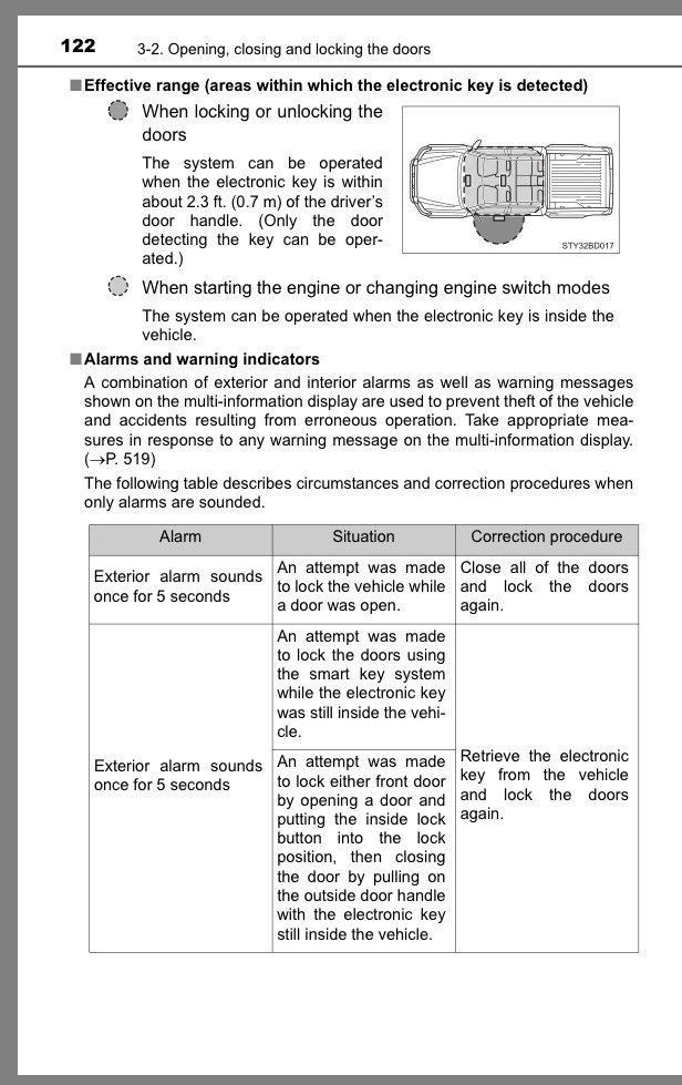

    The handles are also antennas.
    You can test this by putting your key on the passenger handle (if you haven’t done this mod) and attempting to open your driver’s handle (it won’t work).
    The handles are antennas that you need to be within 2.3 feet of, and also touch sensors you need to touch.
    The sensors inside the vehicle are used to start the vehicle, and one used for the keyless entry remote buttons.

    Ha, perhaps I should have RTFM.
    I am however dubious of the range lines. I have unplugged one of the interior sensors and it still detects the key; albeit, at reduced distances. I don't think I tried to lock/unlock at the door.
