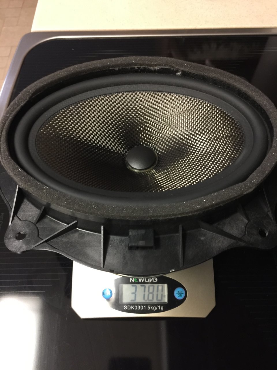

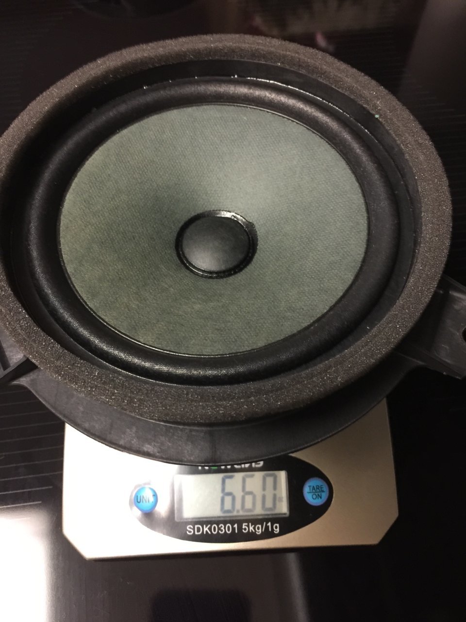

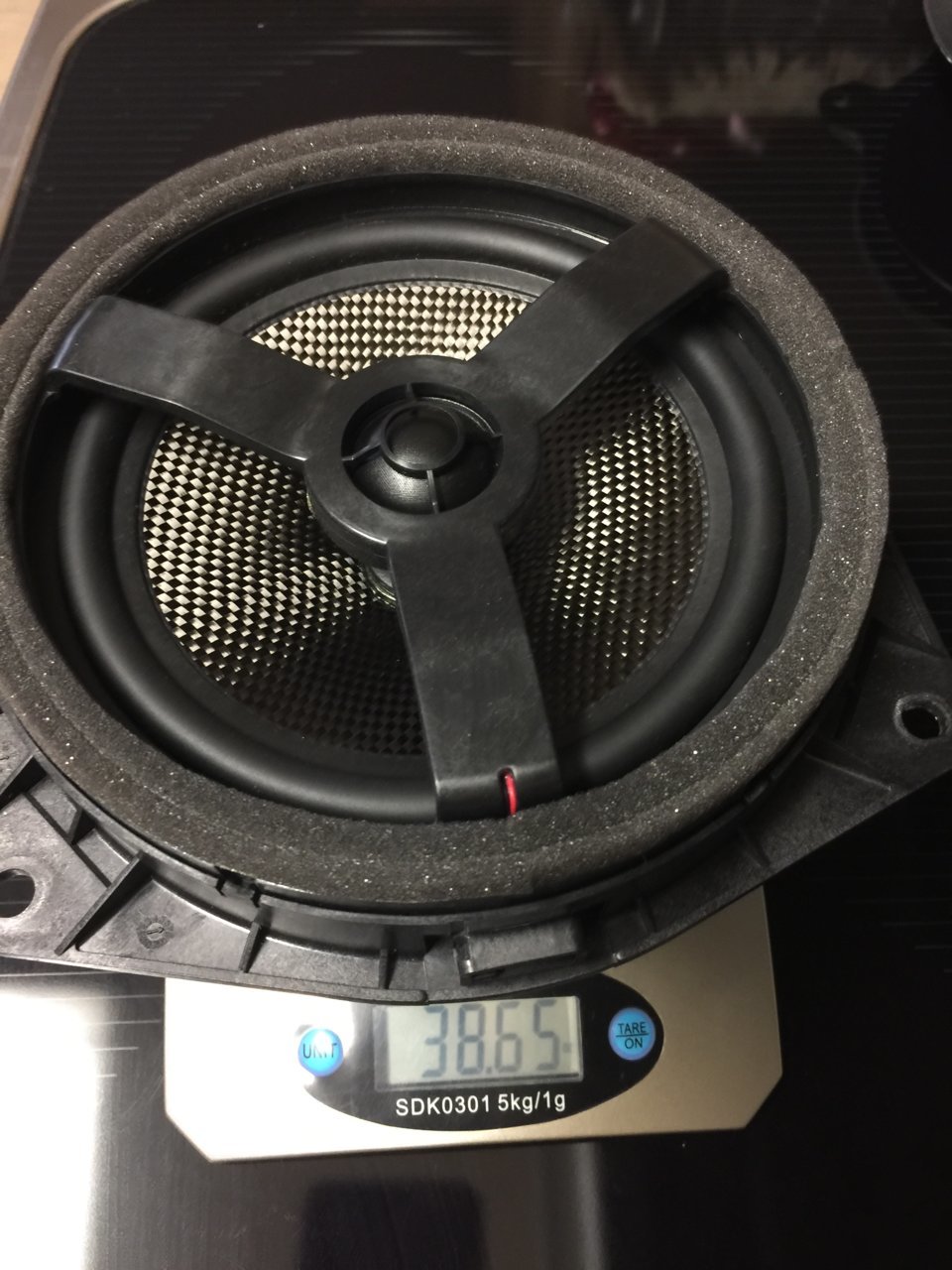

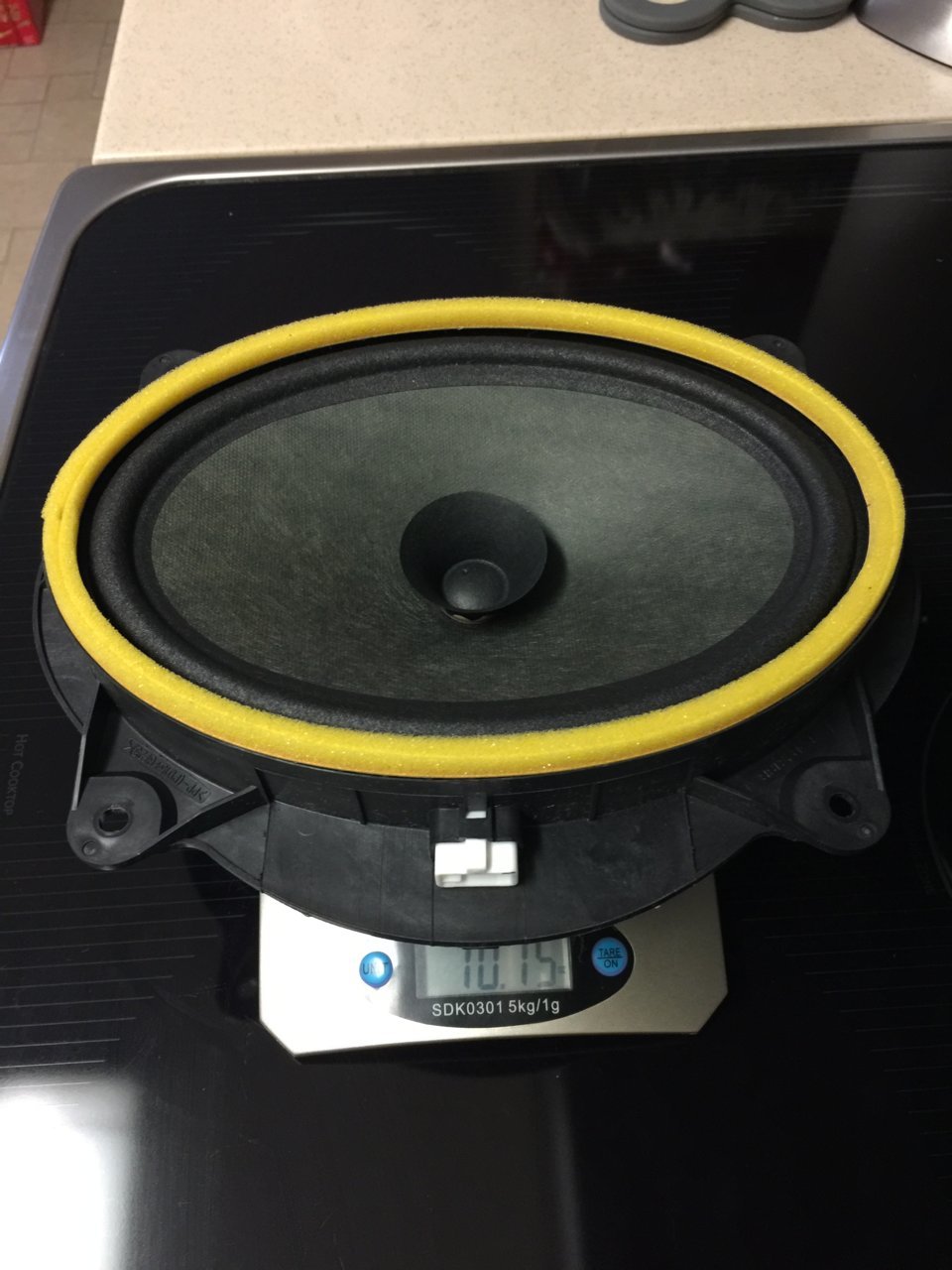

    Stock compared to OEM+ speakers.
    E9925DFD-A362-483E-913F-734CFDEF8447.jpg F1E2B76F-6A3D-4AA9-8C84-6E607FAD3EF5.jpg 23EEF268-6DA4-4B87-90E4-1A7E73F24003.jpg E20FB874-5550-48F6-9B69-B6C2497B1CBB.jpg
    Didnt mean to hijack thread but had to show how light the stock speakers are.
