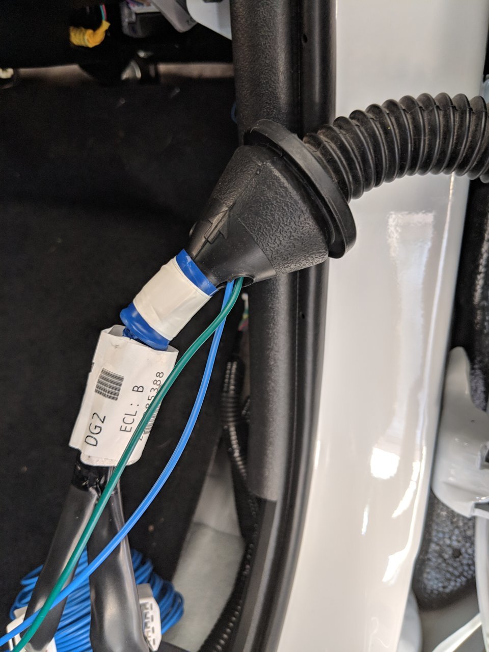

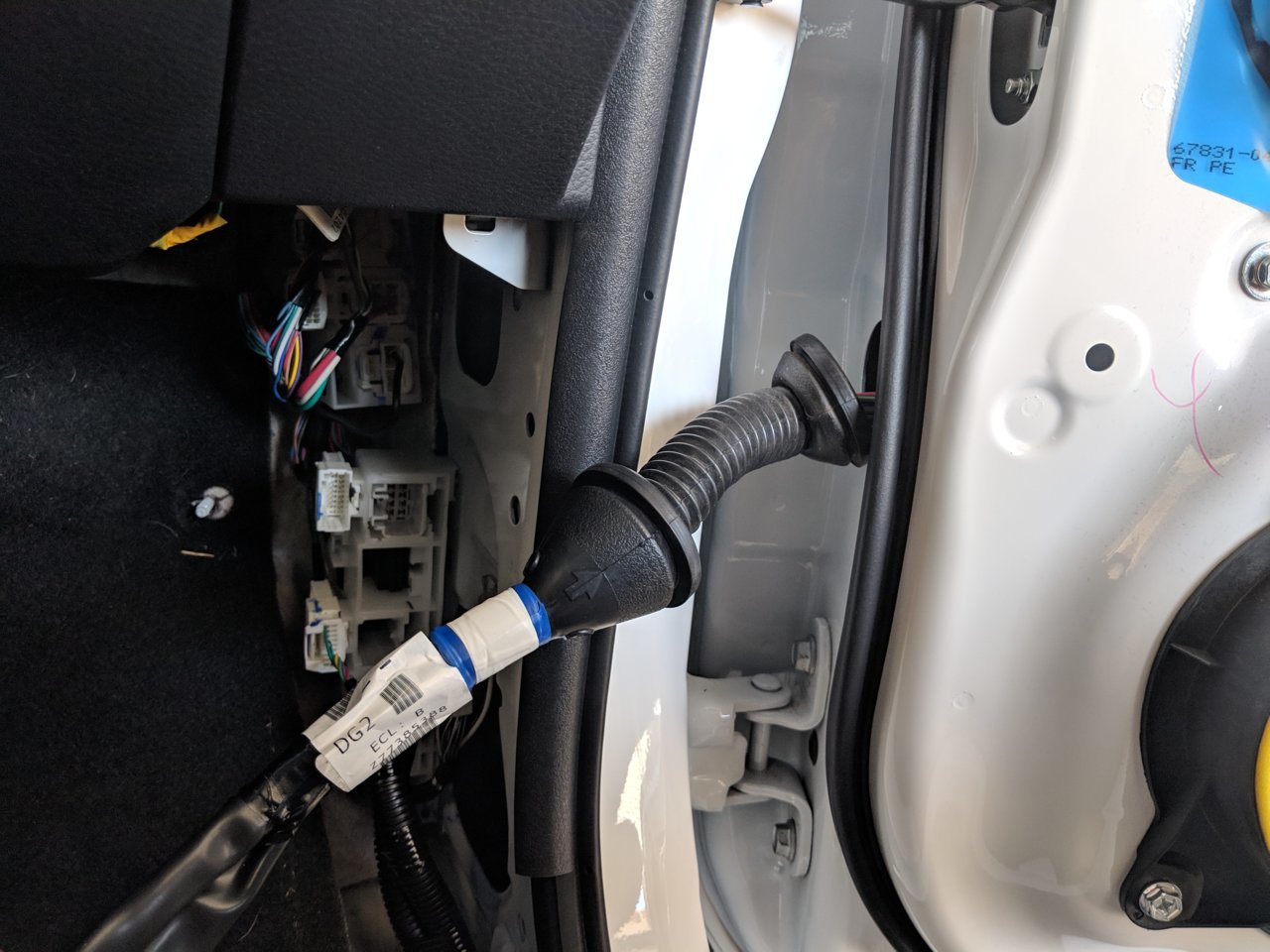

    Just in case some extra pics help. I used 12 gauge solid strand wire as my fish line starting from the cab and pushing into the door. It was fairly quick and easy...maybe dumb luck!IMG_20181029_142041.jpg IMG_20181029_143221.jpg
