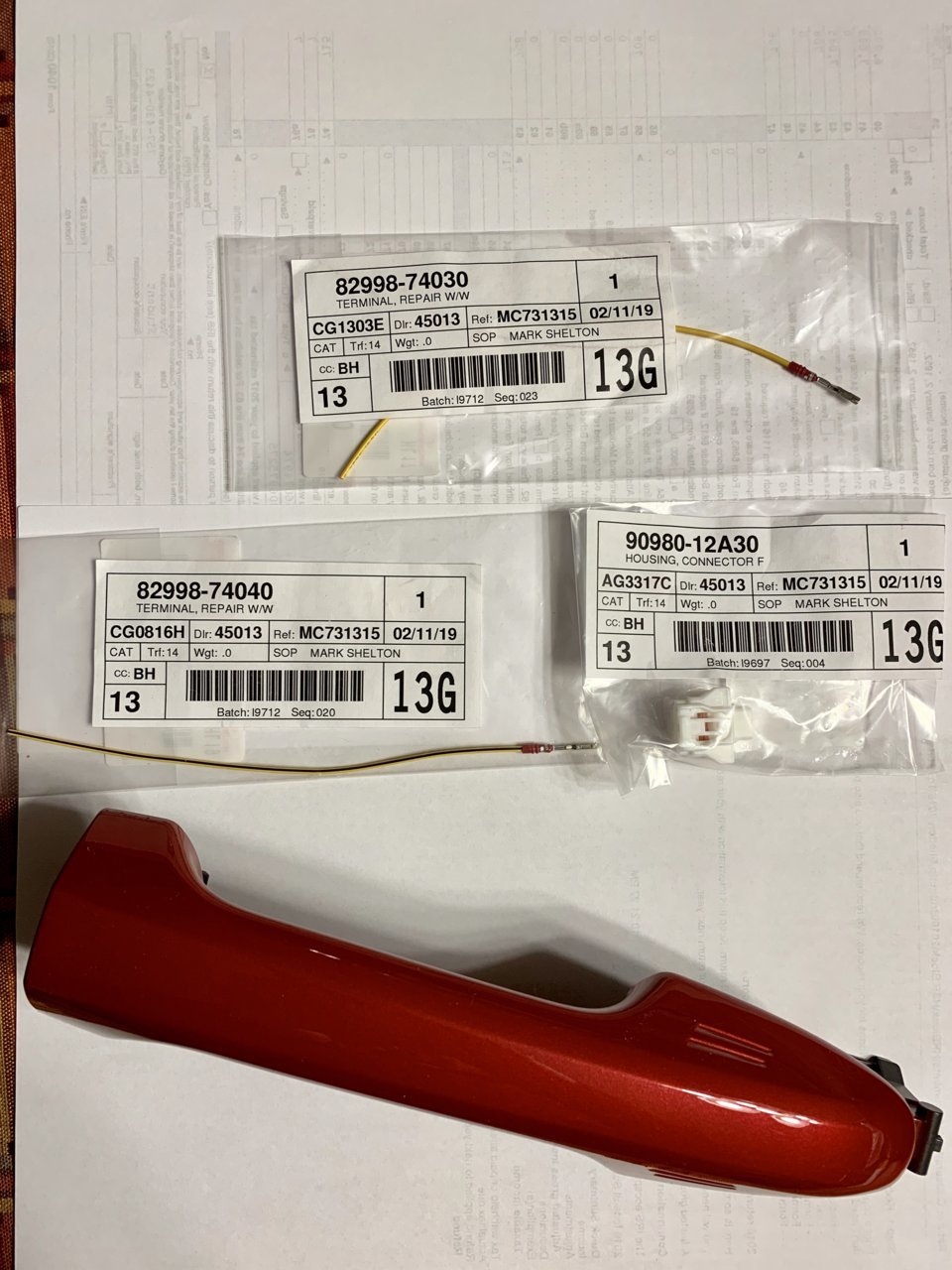

    This came today. It’ll have to wait until it quits raining and warms up a little.

    Adding Smart Key entry to my new 2019 Toyota Tacoma passenger door
    I just purchased a 2019 Tacoma TRD. I'm going to add the smart key door handle to my truck. But, the color I selected for my truck was Barcelona Red. The smart key door handles don't come in that color. I was able to purchase a can of spray paint sold at a local auto parts, that is manufactured as a exact match for Barcelona Red. Do you think there will be any issues painting the door handle? I noticed that there is a rubber back on the inside of the handle and I was going to tape that over to prevent paint from getting on it. I'm concerned about to the line on the outside upper part of the door handle being sprayed over. I was also going to lightly sand with a fine grit sandpaper to hopefully get the paint to stick better. Appreciate any suggestions. Thanks

    The handles do come in Barcelona Red (the red listed on the first post is Barcelona red, just wasn’t using the full name)
    Part number 69210-0E080-D1
    I think you would be better off with the factory paint on such a handled plastic part.
