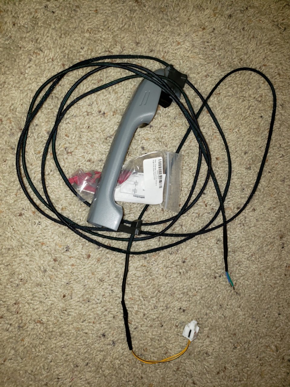

    Anybody know the exact length they used to run the wires from the handle to the BCM?

    I measured about 11 feet (of each +/-) to start and it was almost perfect. I’d suggest giving yourself a bit extra and you can trim it at the taps.

    Ready to plug 'er in!
