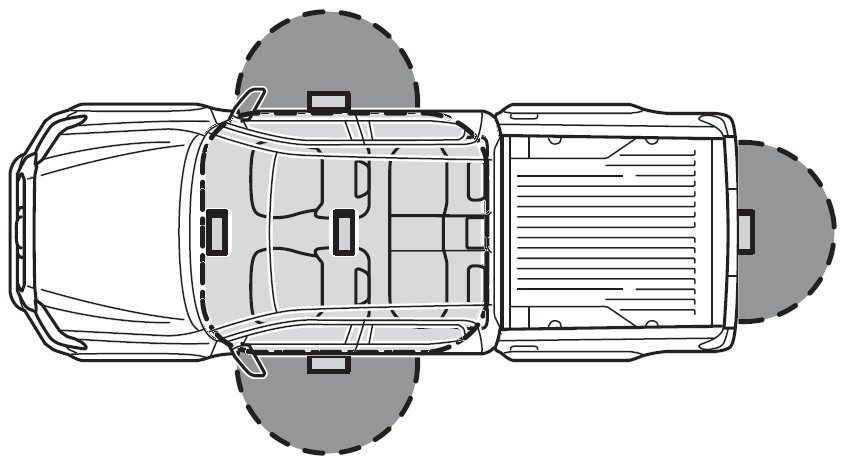

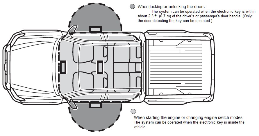

    The vehicle owner's manual mentions either door. but only shows driver's, OP got what was intended and now an add-on in the newer model.

    Now that I have my passenger door sensor installed I wish it would reach to the tailgate. I hate getting my remote out to open it. Gettin lazy.

    At least the sensor. I’m sure somebody out there can make a way to mount the sensor to the tailgate. If only the signal would reach.

    Next person that does an install, run a paired wire thru the opened rear window up to the tailgate and do a test...:notsure:

    The sensor is also the antenna, so signal will reach anywhere the sensor sensor or handle is installed.
