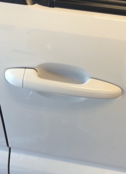

    We want the part number that would be for the DRIVERS SIDE even though we will be installing on the passenger side.

    If you look at your driver's door handle, it actually has the lock sensor lines on the top and bottom. Toyota probably did this so they could be reversed.

    The handles have sensors top and bottom and are the same when flipped over. They only make smart handles or not smart handles. The drivers door smart handle will install without issue on the passenger side.

    My dumb ass just learned there is a sensor on the bottom. Wow, all this time I thought it was on the top only. Now I wonder if my Corolla had the same. Thanks!

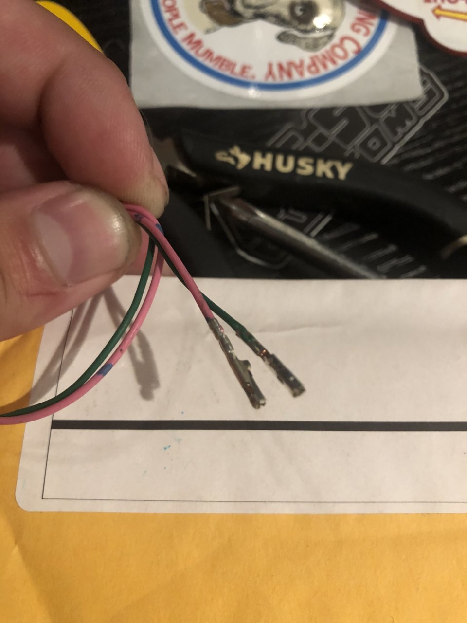

    Were these a good fit? I’m considering getting these instead of the ones from Toyota since it’s like $3/ea vs $12 or $13. You purchased from this seller I assume?
    https://www.ebay.com/ulk/itm/191328057918

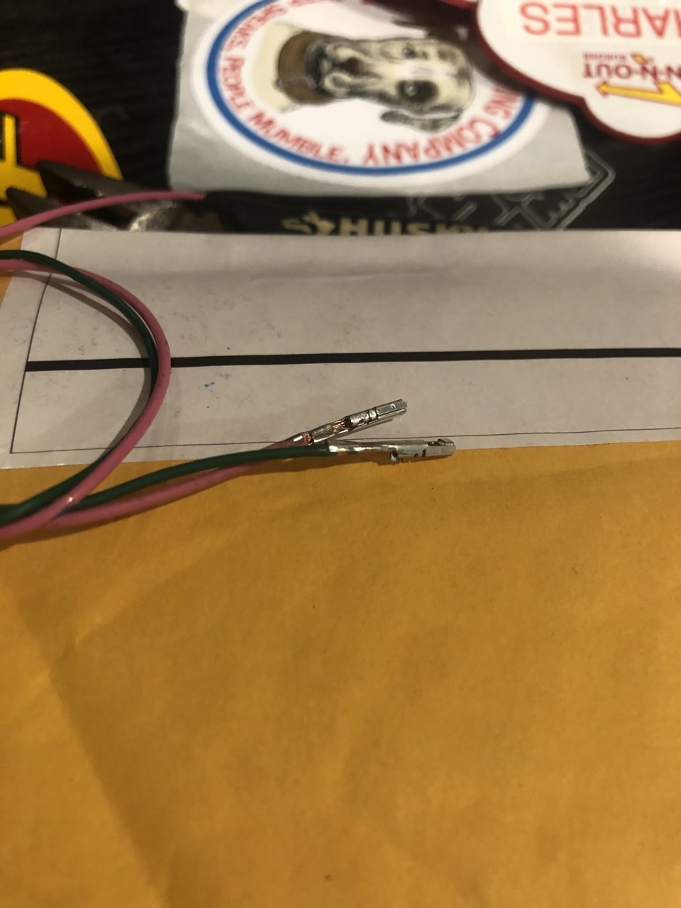

    Been to busy to actually get around to installing this( and my puddles) but they are the solid connection for way less. Just make sure you tel him which colors you want in the “notes” or messages.

    Oh good call! Did you do green and pink? Can’t tell with my phone screen

    Wellll It was meant to be green and red but close enough haha
