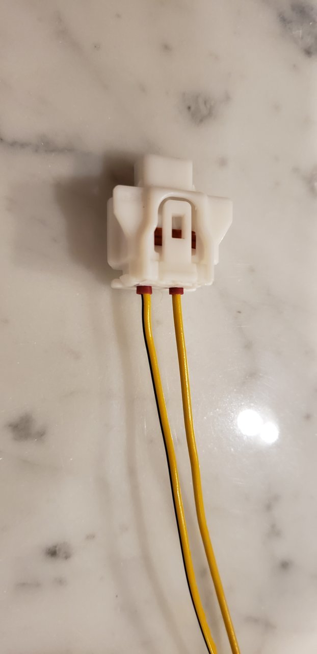

    So solid yellow wire to green and yellow lined wire to blue?
    I wish I paid attention to which was on top. I guess I could just pull the handle off quick.

    Wire it up. If it doesn't work switch them. Ask me how I know.
