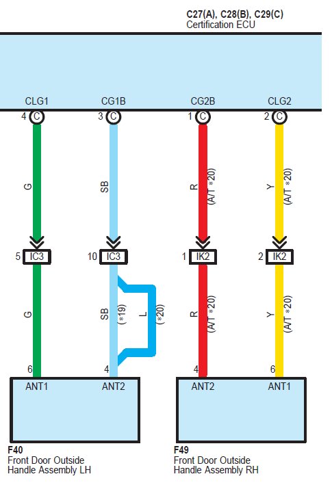

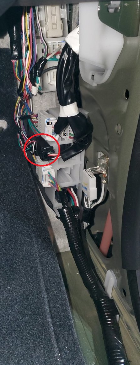

    2020 Passenger's side Smart Handle connectors
    porterx likes this.

    Goes to the same pins on the computer as we thought it would (same as the highlander) unfortunately it isn’t just about wiring, the computer must be programmed as well.
