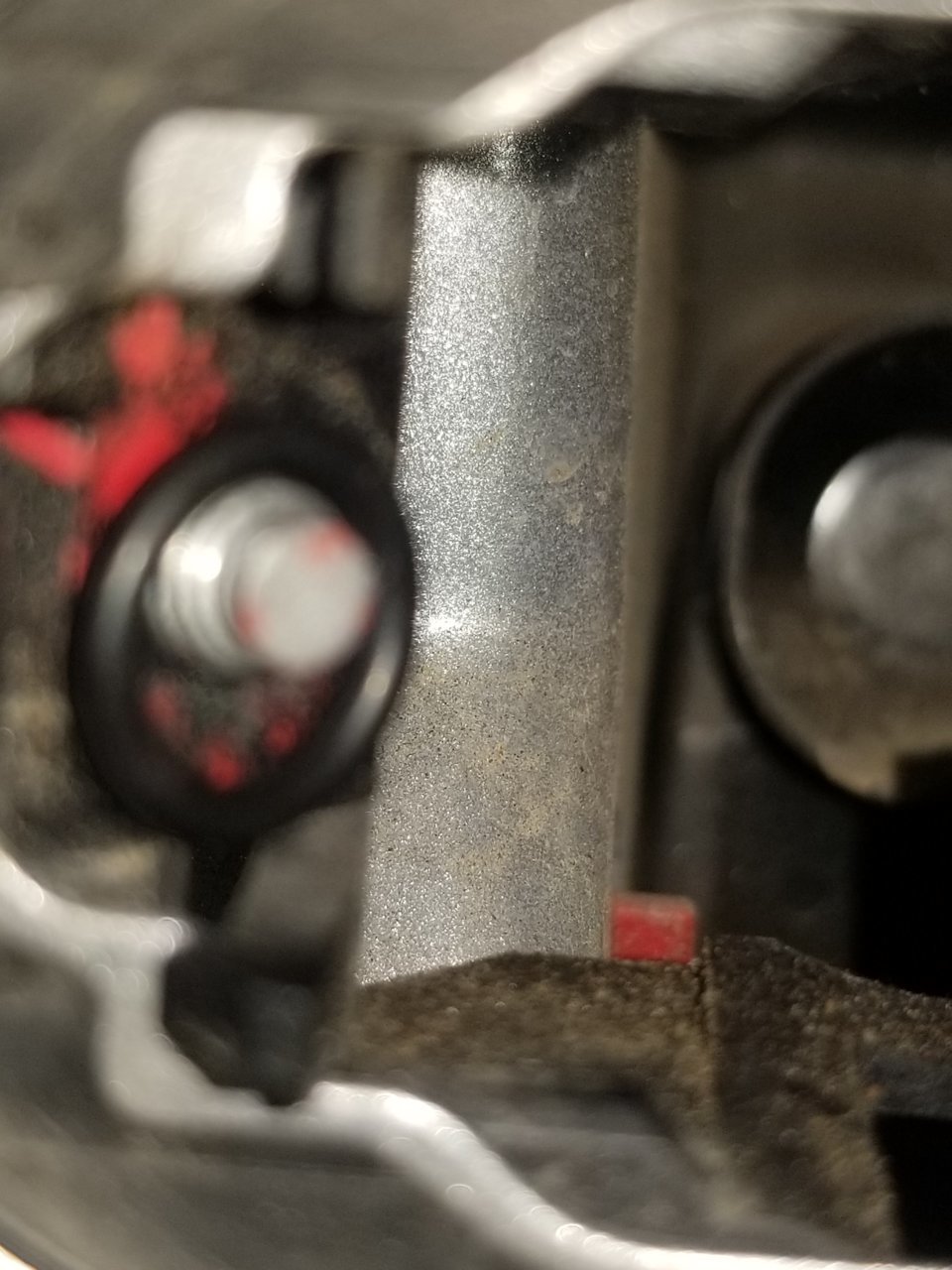

    Feel any resistance when pulling on the handle?

    Great idea Jake!!!:thumbsup: I’m just afraid that being rubber may loose a little over time with the vibration of the truck etc. An aluminum washer may be better(?)

    Doesnt feel any different than before I put in the o-ring

    Aluminum washers or shims may indeed work better, just a bit of trial and error getting the right thickness. I'm pretty confident the o-ring will hold up though. High quality, high temp and I can squish it to right where I want it(the bolt is tighter now than when I disassembled to install the smart handle).

    Honestly I have no idea, I randomly pulled that o-ring out of a bag of parts off my duramax. I'd guess its about 1/16th" think and you'd want around 5/16th ID. Mine was far larger in diameter than needed so it took some finagling to keep centered when tightening the bolt.

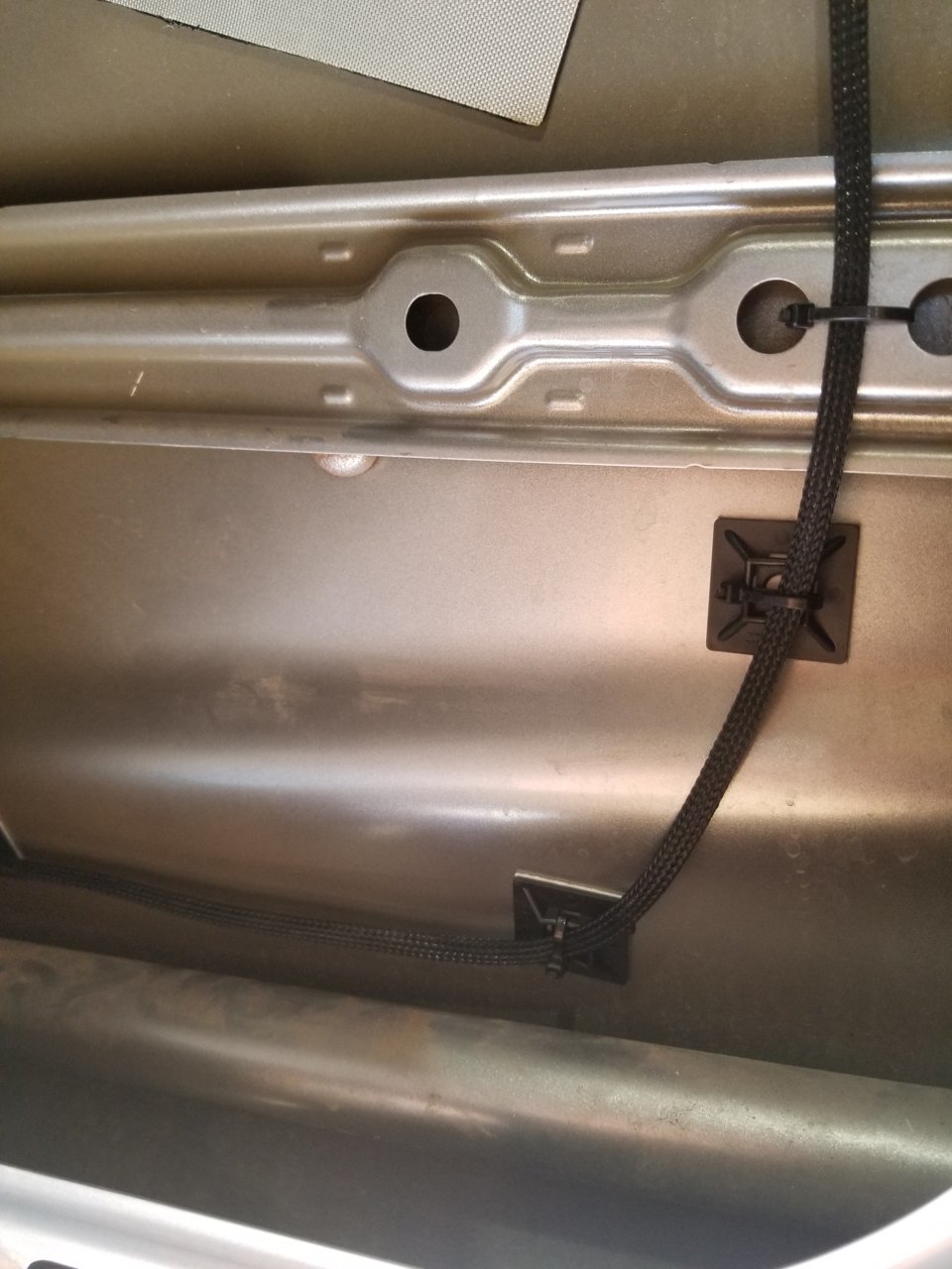

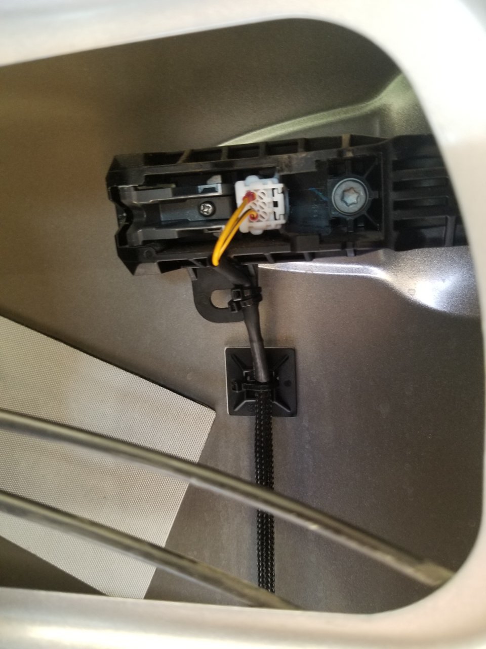

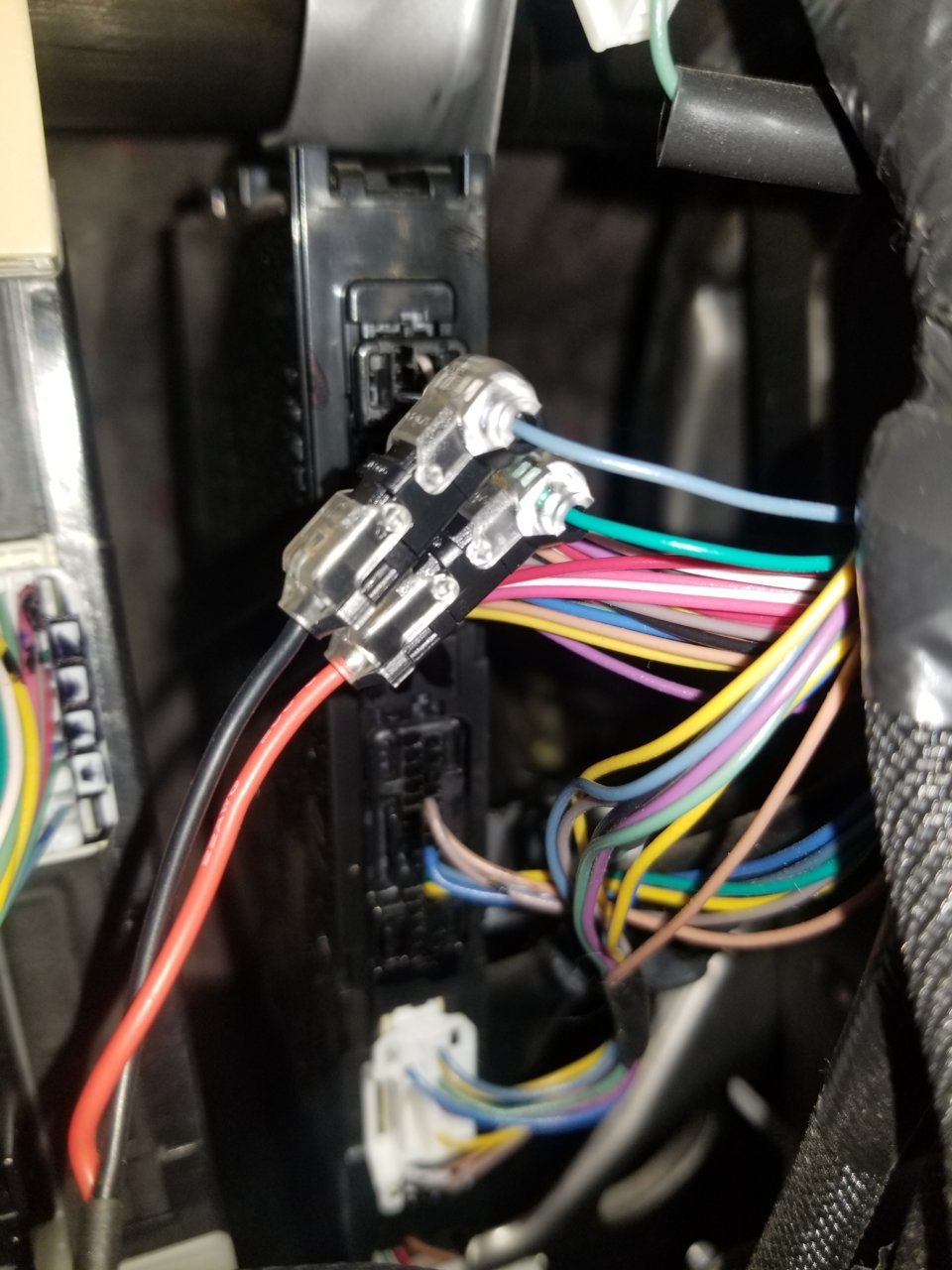

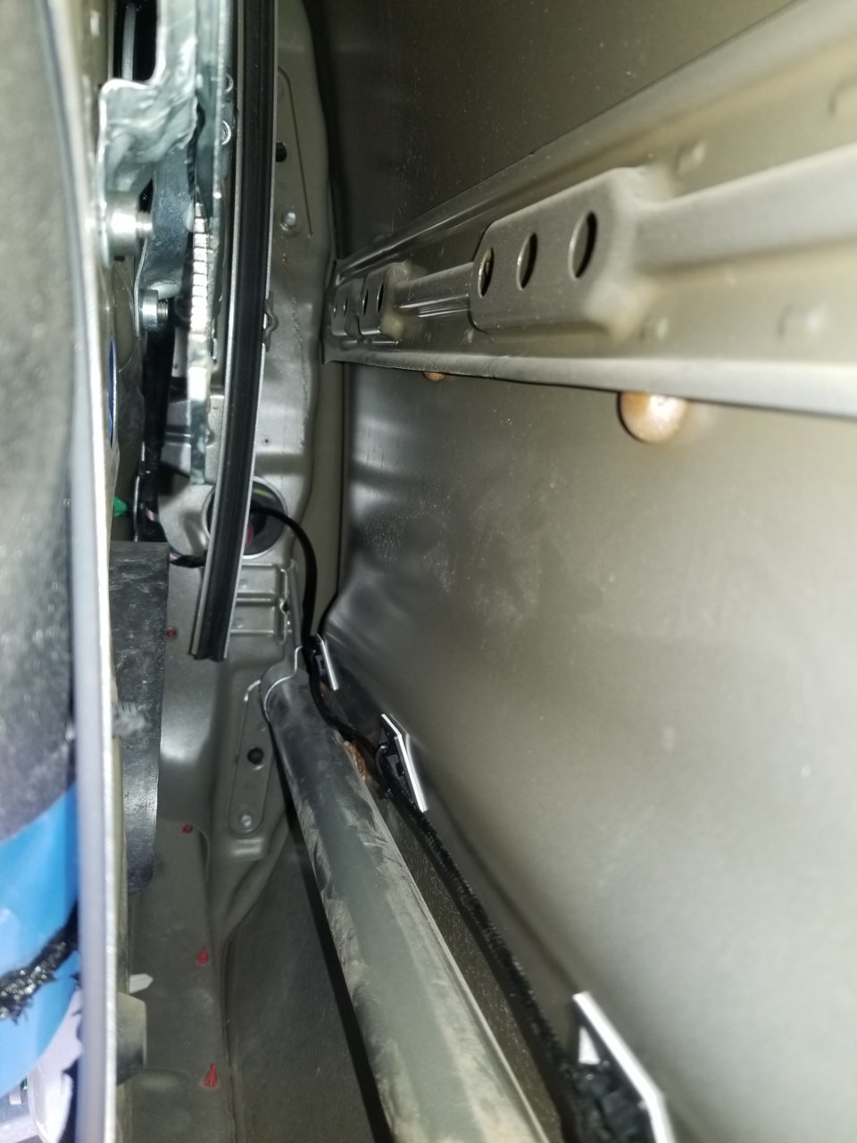

    Finally got around to wiring it up today.
    20200616_174051.jpg 20200616_174055.jpg 20200616_174104.jpg 20200616_185057.jpg
    cshrum and DSRamsey13 like this.

    Great job! The only hesitation I have with the sticky anchors is that with the heat, they may come loose down the road.

    They may but I'll cross that bridge when/if I get there. Nice to finally have it done. I still cant believe they didn't come from the factory this way.
