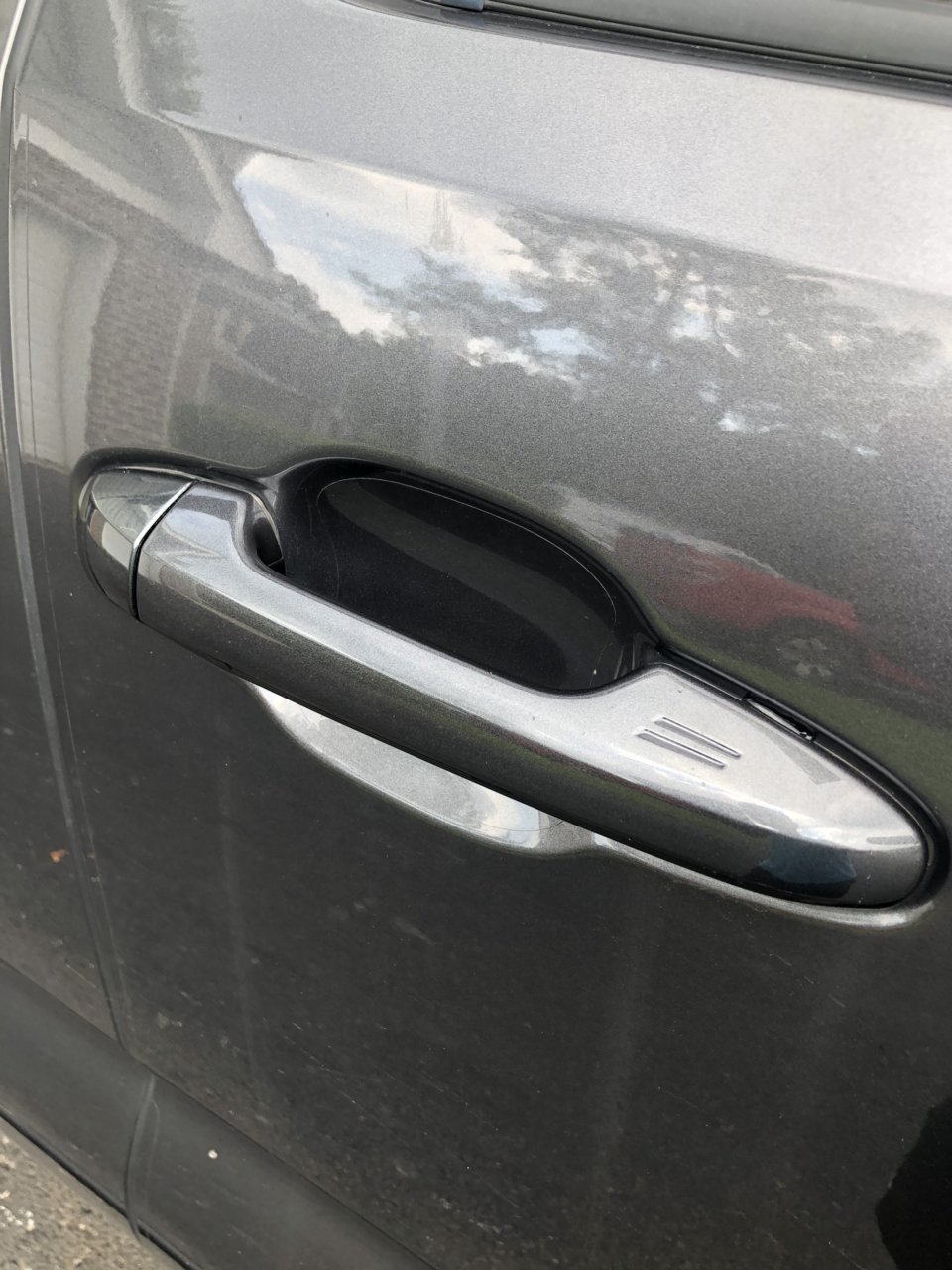

    Cement ‘18 OR 4x4
    I heard these are now on the '20s from the factory... are there any updated OEM parts available? I would assume the door handles on 2020s have the sensor on the bottom now at least.
    Edit: assuming makes an ass of me - the smart handles are the same top/bottom.
  15. Jul 11, 2020 at 6:06 PM
    #835
    Tacoma1845
    Tacoma1845 Well-Known Member
    Jun 13, 2018
    #256302
    521
    Anthony
    Central Virginia
    2018 Tacoma TRD Sport DCLB (Inferno- Premium/Tech)
    The sensor is located on both sides of your 2018 handle. Just flip it for the passenger door.
    Loan Wolve[QUOTED] and cemented like this.
  16. Jul 12, 2020 at 6:04 AM
    #836
    Victory
    Victory [OP] Well-Known Member
    Mar 13, 2016
    #181167
    1,048
    St. Pete, FL
    2016 White Tacoma TRD Off Road
    2020s use the same parts. Toyota only makes two handles, smart and regular. They don’t make left and right. The handles are flipped to install the opposite way, there is no top or bottom, they are mirror images.
    Internal pins and clips for the back of the handle are also the same.
