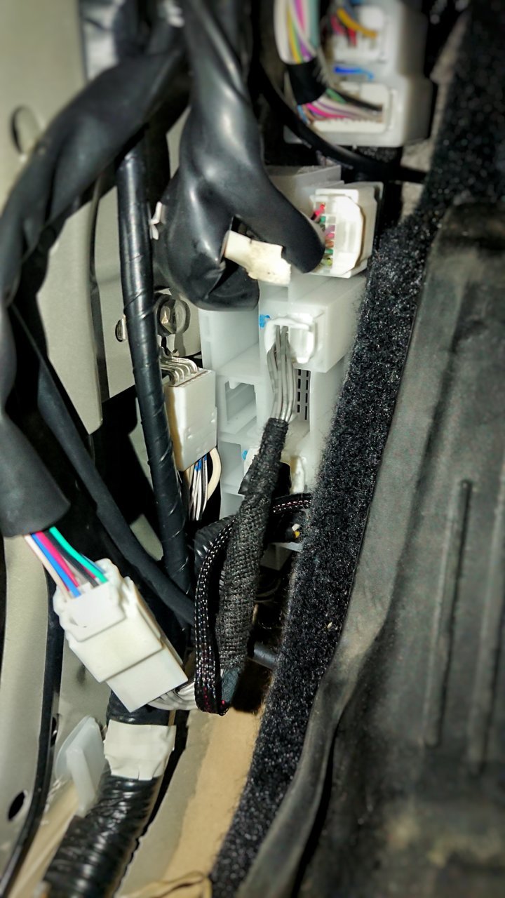

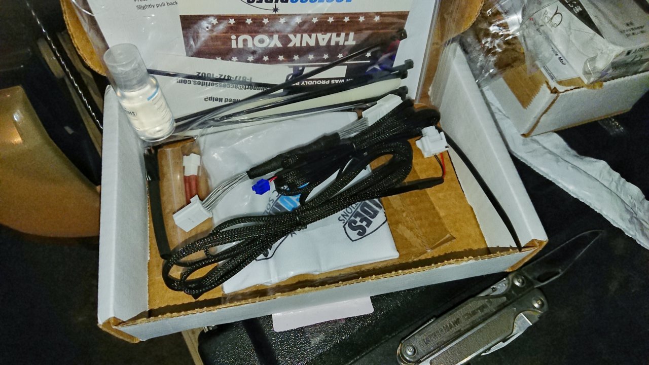

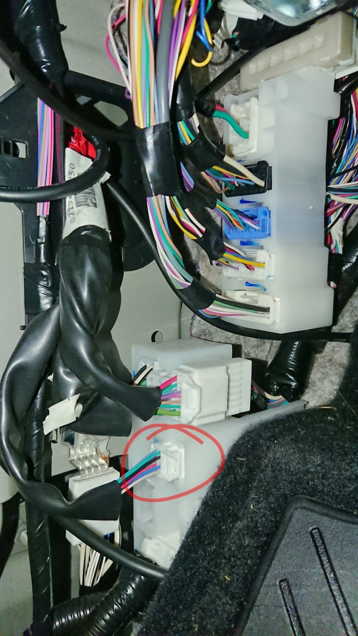

    Oh so I got my @Accessorides harness. I have not installed it yet, as I am still waiting for the passenger side handle and Lexus wallet key to arrive.
    Really well made and installation process is really well thought out. The wire that goes through the door boot is tied around a long ziptie for easy pass through. After, the plug that the pins insert into is even color coded. The whole harness then plugs into IC3 in the driver side kick panel.
    This harness makes everything idiot proof.
    As simple as it can get.
    Also thanks for the hand sanitizer and hankerchief (? haven't opened it)

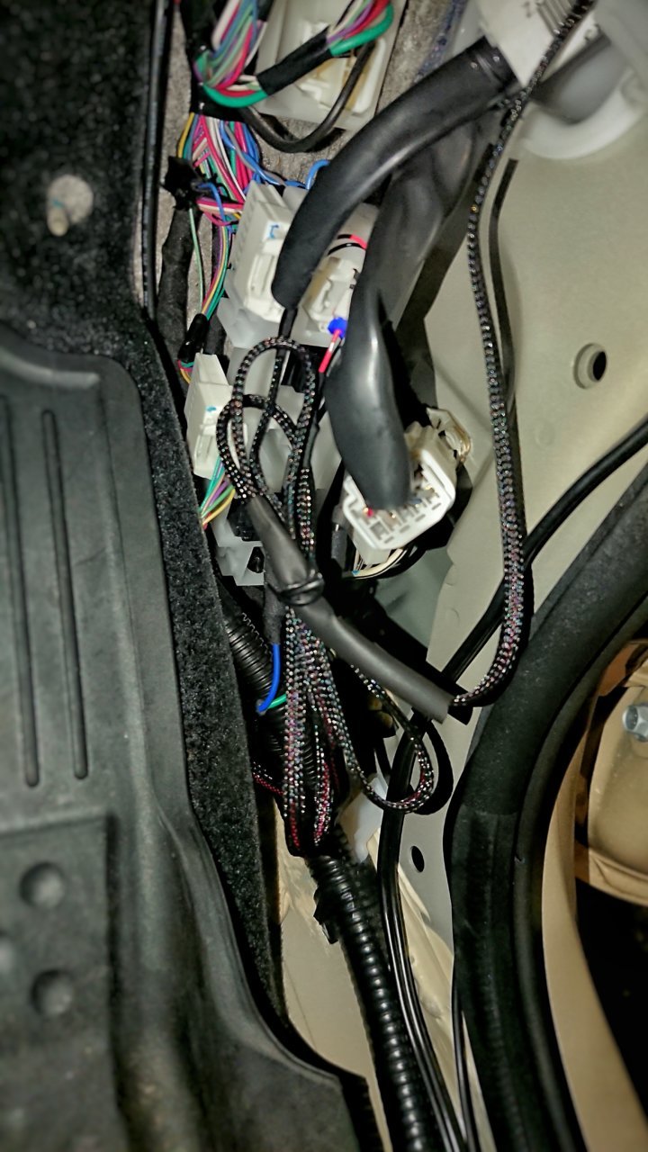

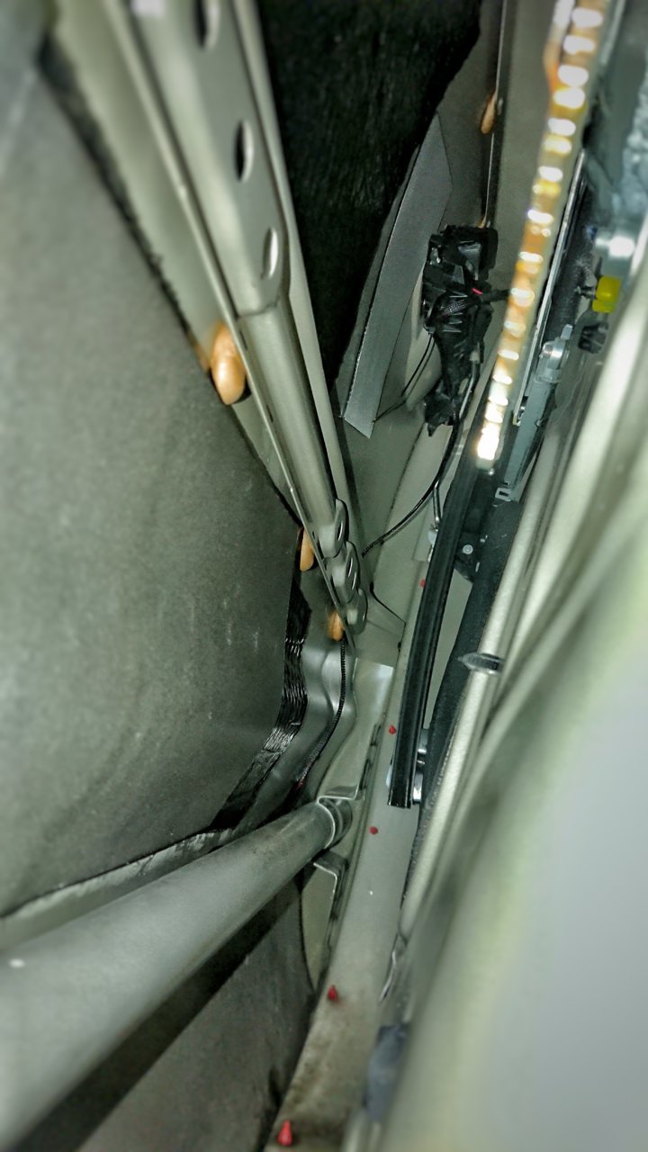

  15. Sep 26, 2020 at 8:55 AM
    #895
    Rainoffire
    Rainoffire Well-Known Member
    May 31, 2018
    #255034
    3,109
    2017 QS DCLB TRD Sport
    Installed my passenger smart entry handle.
    Had a couple layers of sound deadening, so I had to do everything through the speaker hole. Got everything zip tied and out of the way, one handed mode.
    With @Accessorides PnP harness, it makes everything effortless. Even getting the wire through the boot was easy. All the excess wiring is kept in the passenger side kick panel.

    For those that have installed this mod harness do you still need to set your radio control to "unlock all"?
    I don't want to unlock all four doors if not necessary.
  17. Sep 26, 2020 at 1:11 PM
    #897
    Rainoffire
    May 31, 2018
    #255034
    3,109
    Yes.
    If you don't, I assume that touching the passenger side will only open the driver's side door.
    Since this mod will piggy back on the driver side's door handle wiring.
