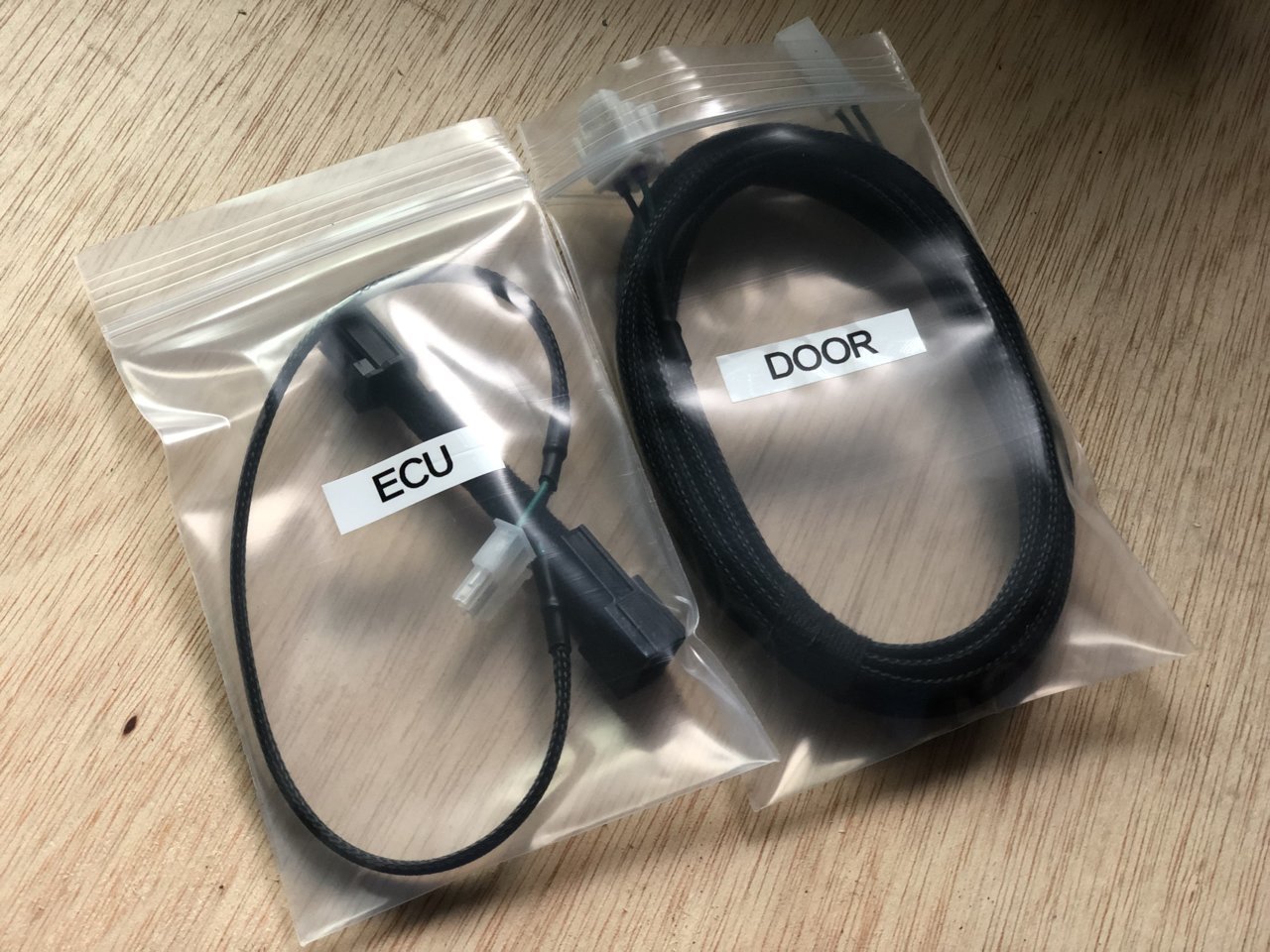

    Yellow is the driver’s side. Green and brown (not black; I only had black in 20) is the color for the passenger addition.
    It is broken in 2 parts to facilitate easier wire running

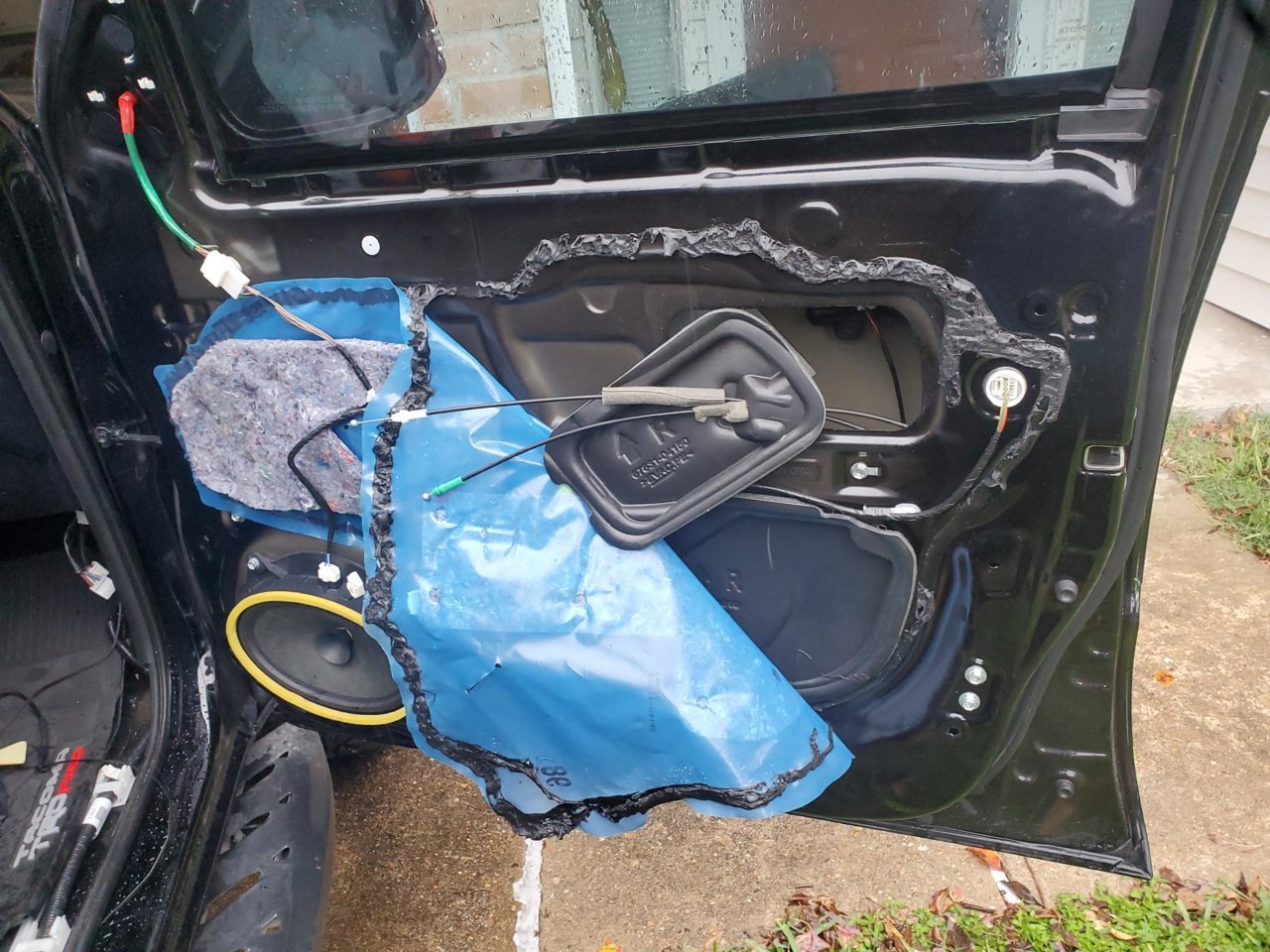

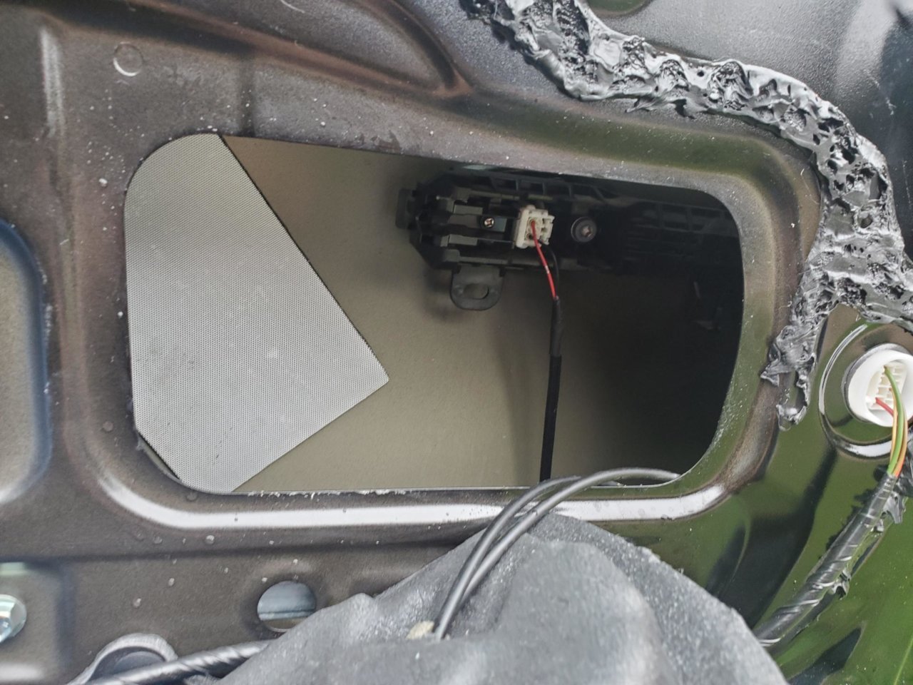

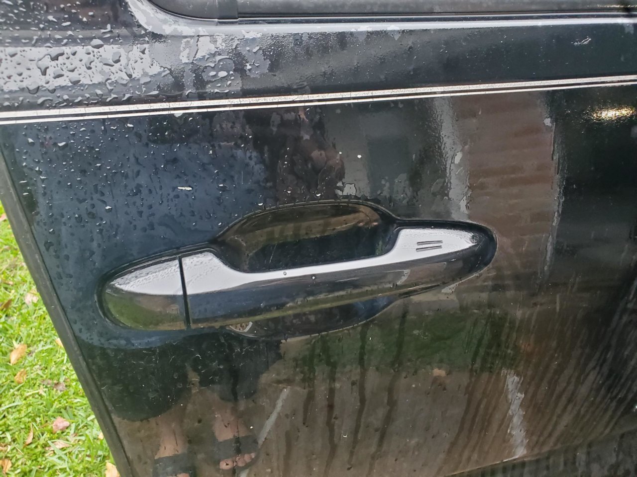

    Just installed the passenger door handle and it works perfectly.
    Also you dont have to run and splice wire. This kit has a plug in wire harness that makes it really easy to install.
    All you need is T30 torx, phillips screw driver, and some electrical tape. Took about an hour to install.
    I fished the cable behind the brackets in the door to make sure it wont get snagged by the window. It cut up my hands a little trying to get it through. Easily pulled it through the grommet and then used some longer zip ties to pull it behind the radio. Zip tied everything. Works perfectly.

    Was thinking I was going to have to do this mod on my 22, but was very pleasantly surprised when it showed up and already had it! Had no idea when I ordered it. Mostly my wife that is happy, very convenient for her.

    Just put it on this weekend and am STOKED!!!
