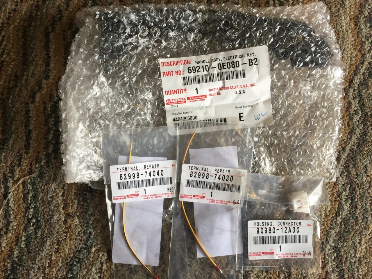

    According to my USPS tracking, my parts should be arriving today. However, I am still waiting for the rest of the materials from Amazon that are arriving next week. :thumbsup:
    Edit: i just checked the status of my Amazon order and it is at my local post office also! This may be my project this weekend!:yes: :bananadance::dancingbacon::broccoli::jellydance::kona::taco:

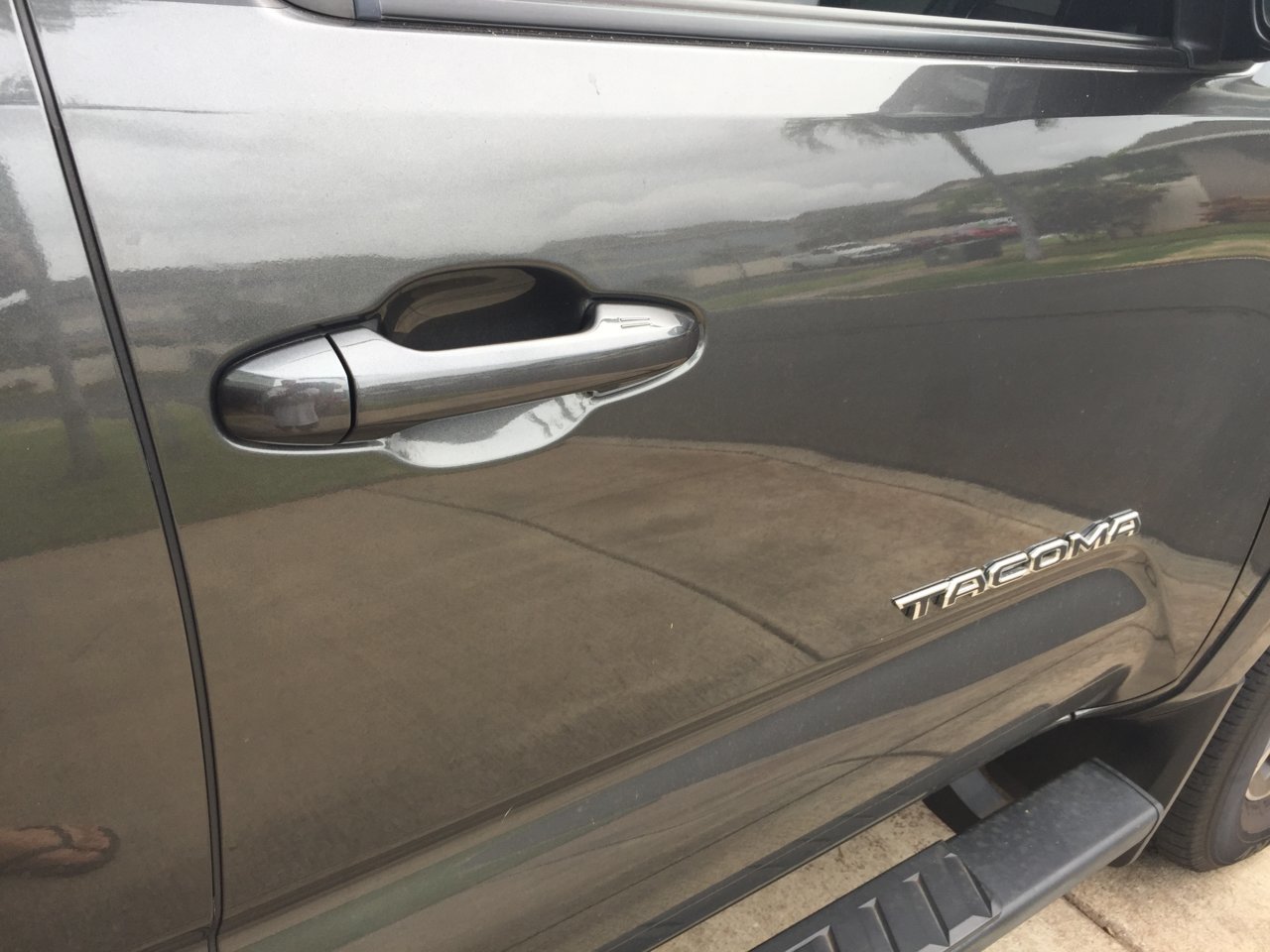

    Ok. I couldnt wait till the weekend. Its installed and works great! Thanks @Victory ! You rock!
