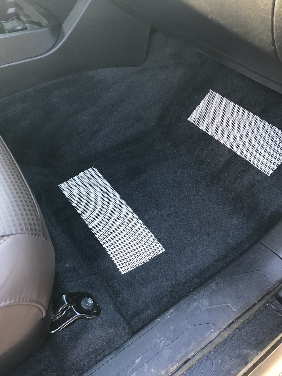

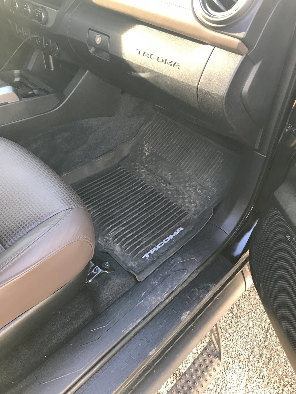

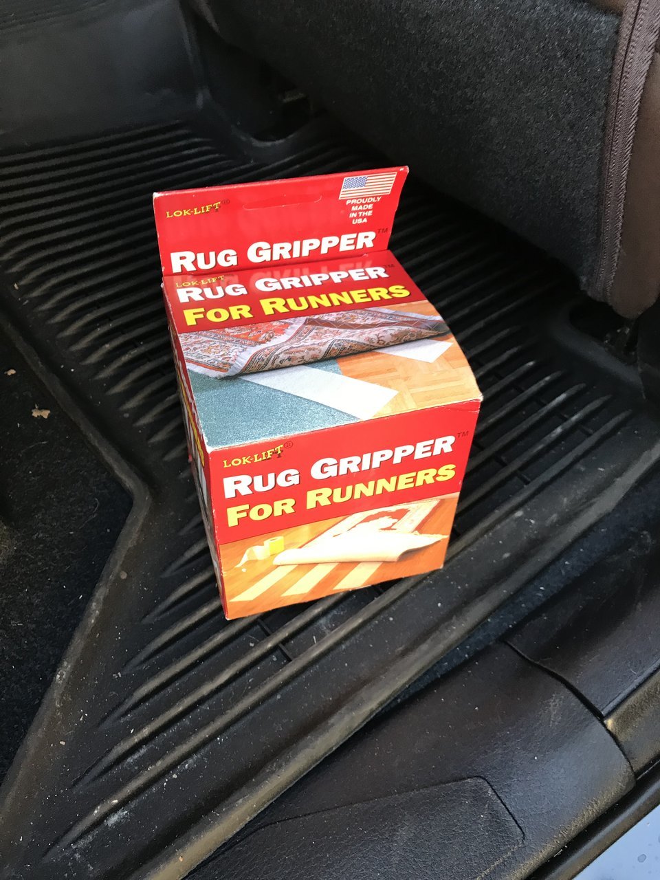

    Here’s what I did.
    I had some carpet tape and it worked great

    Very nice. Well done :thumbsup:

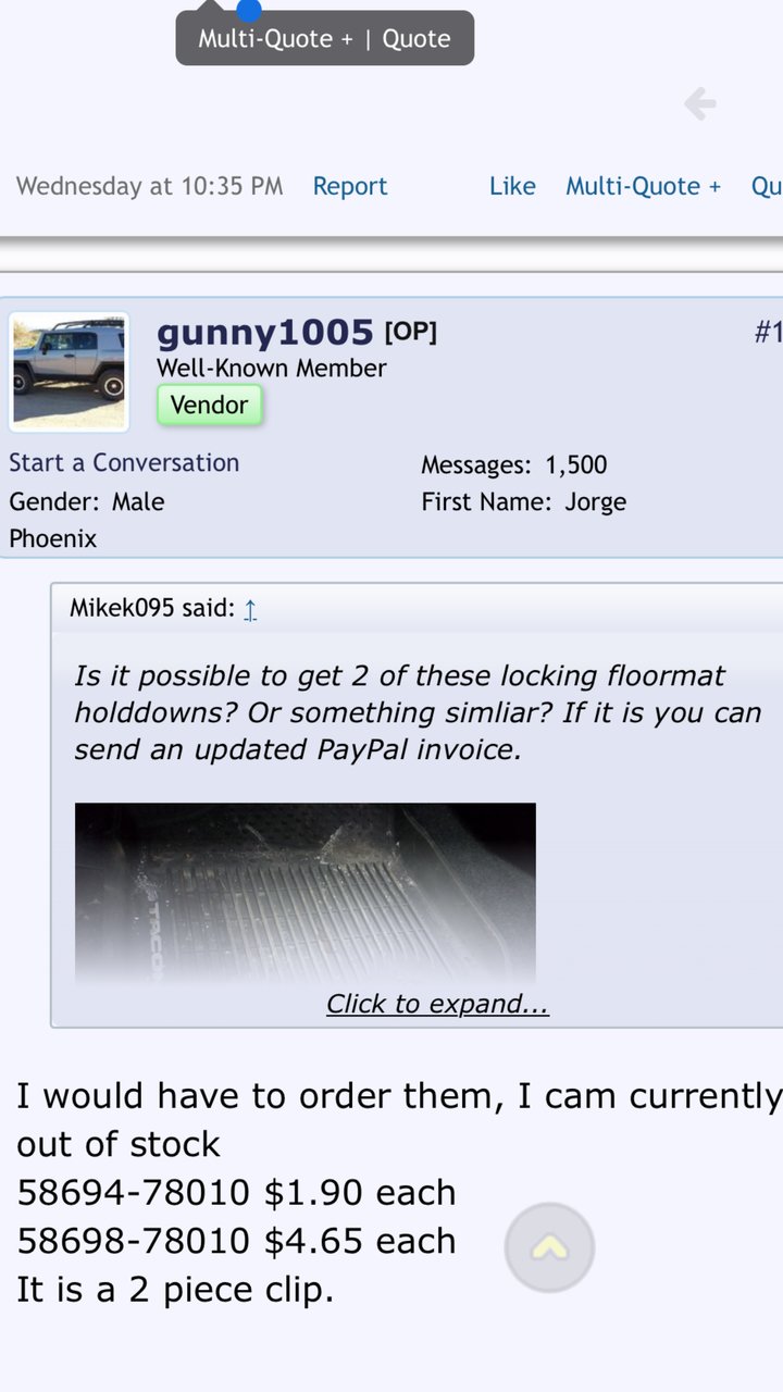

    So I’m wondering how we could find the part number to the anchor on the passenger side floor for the 18s since they are both mats anchored? To me that would work. Heck, I’m willing to buy different mats since the OWM ones are not that great.

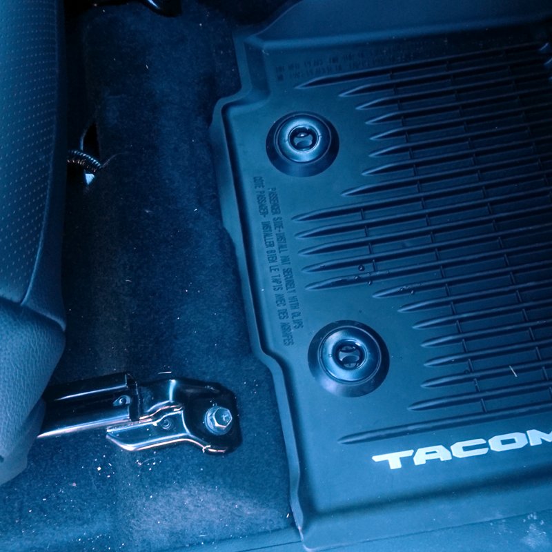

    Yes, I just installed the VW carpet screw clips today in the passenger side of my 2017 Tacoma and they fit perfectly with the 2018 Tacoma OEM All-Weather Floor Liners.

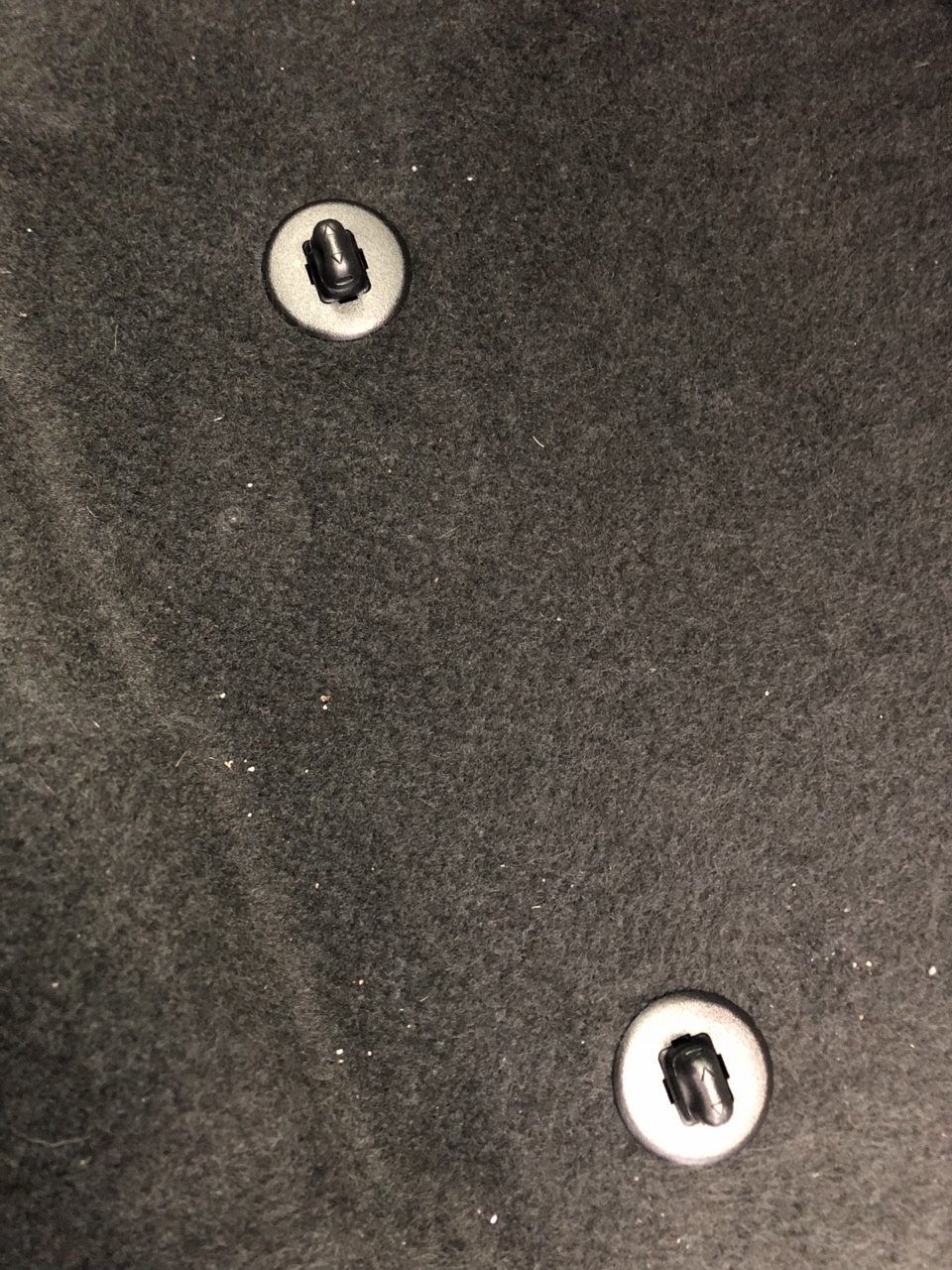

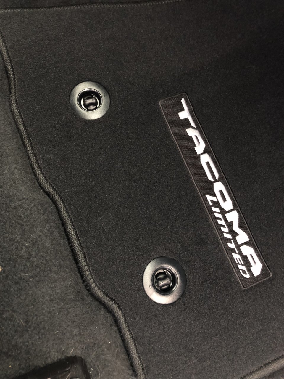

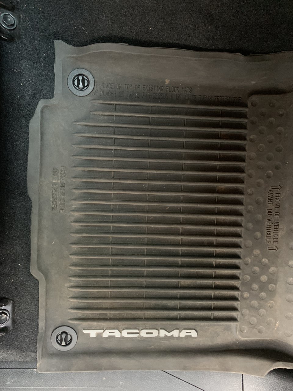

    Oh man I'm so glad I found this thread. Since day 1 this was the biggest annoyance about my truck! Finally installed the fix yesterday. Seems to hold up against my stress tests. We'll see over time.
    Also I bought the 10 pack off Amazon so if anyone needs a set of these, hit me up! IMG_1200.jpg
