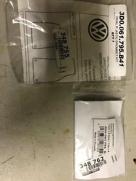

    Ok I may have a solution. I've tried the stick-on velcro, the spray-on rubber adhesive, the Gorilla Glue, and I ordered the 3M Weatherstrip Adhesive in one of the previous posts. Nothing has worked.
    I did some research, ordered and just received the following parts.
    Floormat Screws: https://www.ecstuning.com/ES348762/
    Floormat Securing Hardware: https://www.ecstuning.com/ES348755/
    I'm hopeful that this will do the trick. I'll post pictures once it's done.

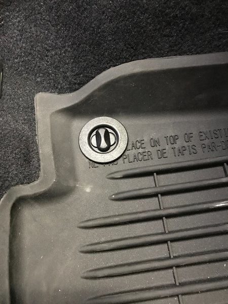

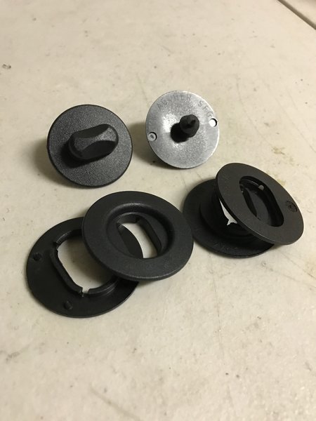

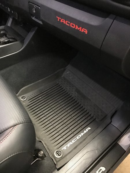

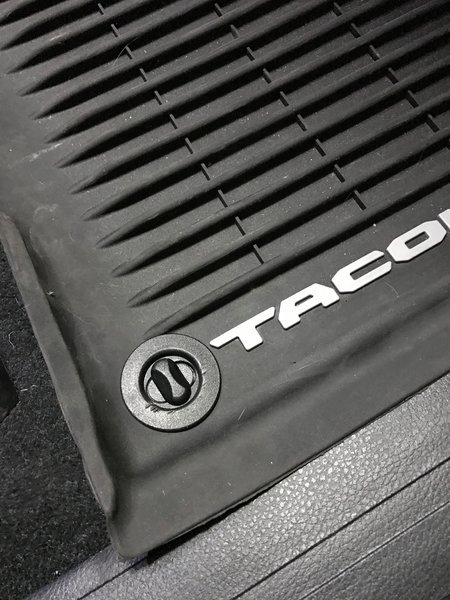

    Here are the pictures. Tested the fix last night and today. Works great!

    It looks like a good solution. Are they easily removed if necessary for cleaning? Without becoming too loose with repeated removals?

    Same as the OEM anchors for the driver side floormat.

    Looks great! So the screws just screw into the carpet? Any lessons learned?

    It's pretty straight forward. Just plan where you're going to cut the mat accordingly. I used a tiny drill bit to poke a hole into the carpet to get the screws started.
    Make sure to leave enough room for the "washer" part of the screw when planning on location. I installed the anchor into the mat first then installed the screw.
    Also, clicking both sides of the anchor together with the rubber mat in between is a bit hard. I actually used a rubber mallet on a hard surface to get it done.
    Common sense rules all. Measure twice, cut once.
