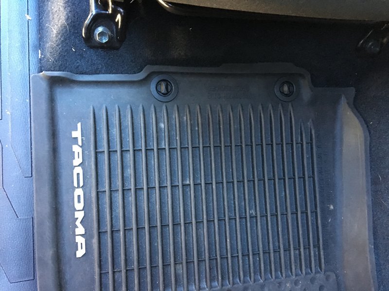

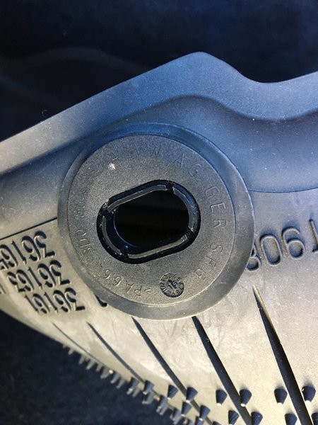

    I got to install my floor mat locks today. After carefully examining them I decided I need to make a rubber spacer to place in between to make a tight fit. I cut out a round donut from an old inner tube. This helps fill in the gap when the 2 plastic pieces are snap together thru the rubber floor mat. I cut 2 oval holes in the corners nearest the seat. To assemble I put the rubber spacer on the top side plastic piece and installed on top of the mat. The other plastic piece goes under the mat. I put a piece of wood under the mat lock and then I hit it on the top side with a rubber hammer to join the 2 plastic pieces together. After the plastic grommets were installed in the rubber floor mat I centered the floor mat on the passenger side floor. Then using an awl I poked a hole in the center of each mat lock into the carpet to perfectly align the carpet screw. Then just lift floor mat and screw the carpet screw locks in. Replace floor mat and lock mat down by turning the lock. All done. Looks great. Works perfectly. This is what Toyota should had done in the factory for us. I highly recommend doing this mod. Works on the factory rubber or carpet mats. Thanks again for bringing these carpet locks to our attention!

    I ended up doing this as well, I punched out rubber shims to place on the bottom. Without the rubber washer the locks were sloppy since they were made for carpet mats not the thin rubber mats. I placed my locks more similar to the the factory location of the driver mat to make it easier when I vacuum (can lift up the edges of the mat).

    Finally got around to install... Simple but effective.
    Hardest part was cutting out the holes in the rubber floor mat, so the peices could connect. I used a exacto knife, after I had the initial indention. Put some tight rubber gaskets under top peice to help with the extra space, as others have suggested.
    Also, use a drill & small bit (I used a 3/32) to drill through the carpet, so the screw fasteners will grab and install easier.
    Put mine out on the corners to ensure no movement.
