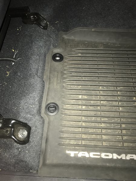

    Now that they are on mine for a while they do see really secure. Really good addition if you have the OEM All Weathers

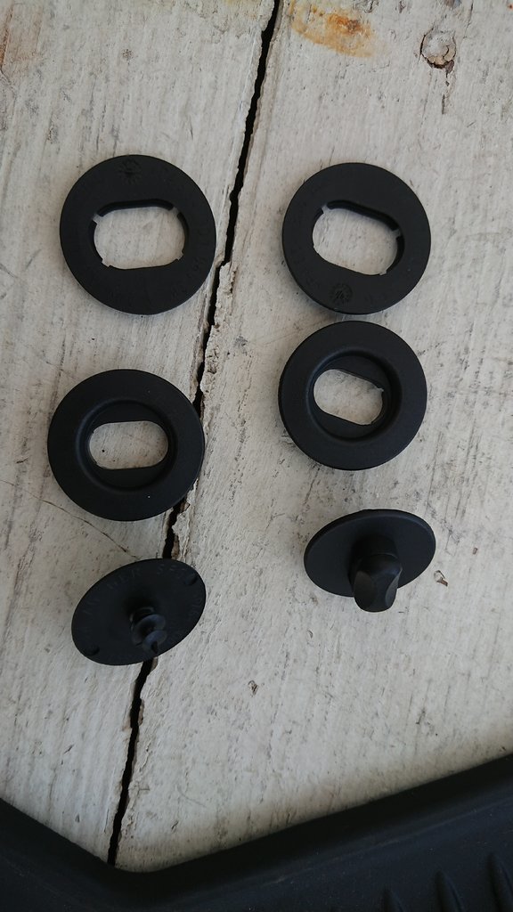

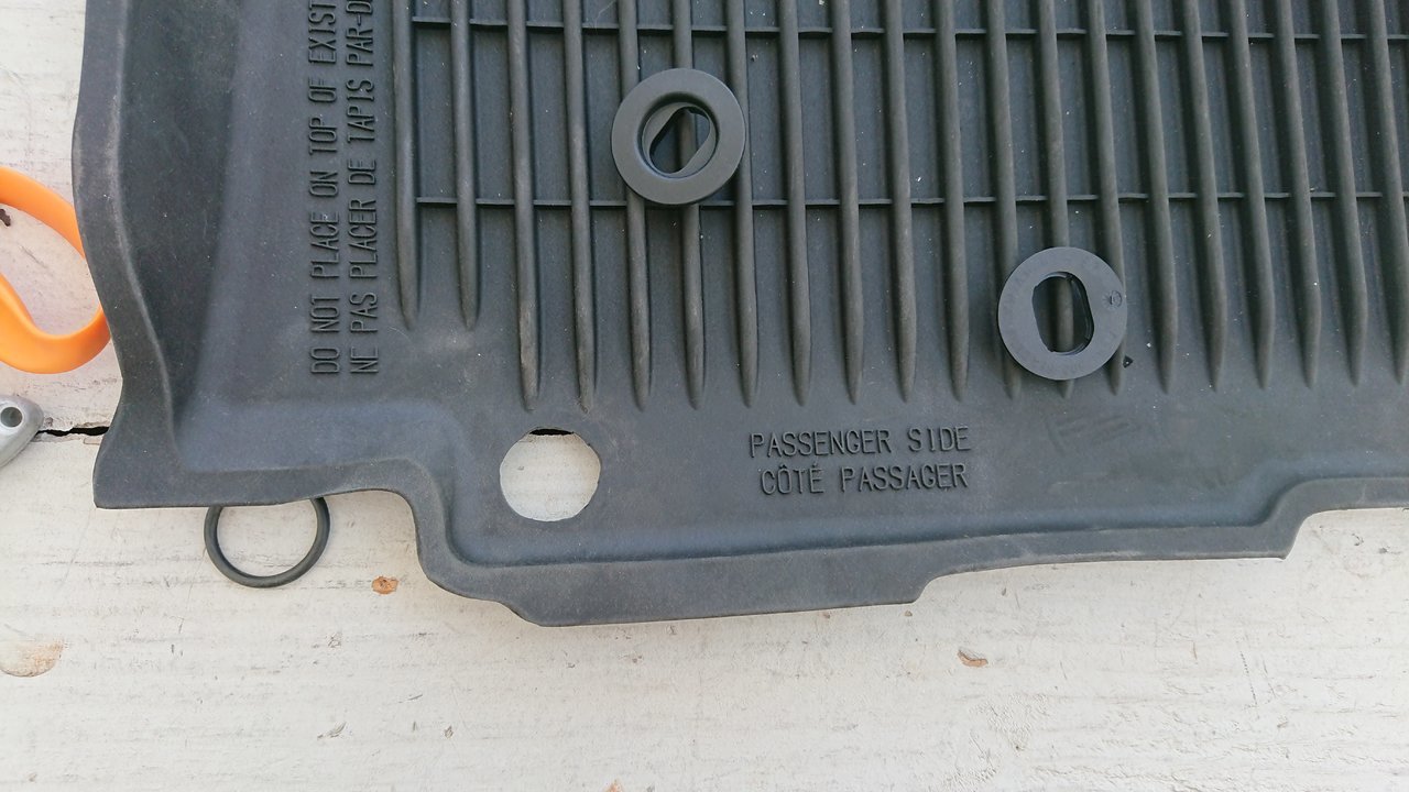

    Cut a circle 1inch.
    Align the top and bottom button.
    Smack with a rubber mallet to lock in

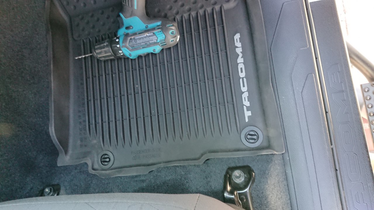

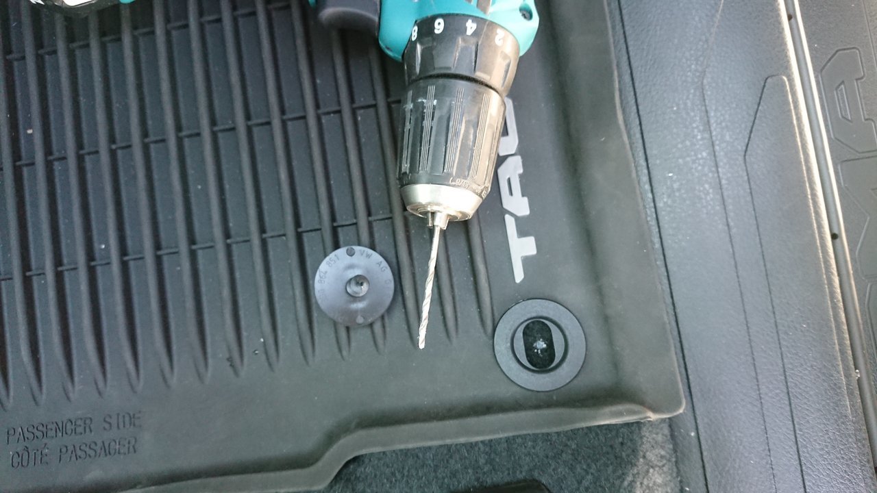

    Small drill bit to drill the carpet in the cab to start the hole
    Hand screw into the carpet with the button screw. Put over and latch
    ****sold****
    I have a set of 2 for $11 PayPal. I put the o ring so you can trace it. Pm me ship within 48 states USA only. Or pick up riverside, California

    Just the carpet to make a hole. The screw goes in the carpet only

    2017 Tacoma TRD Sport
    Drill bit smaller than the screw u less you buff to screw in lol

    I installed mine a while back, but I didn't drill the carpet. Just bear down hard when starting to twist the piece into the carpet. Once it gets started it screws in easily. Mine have been installed about 6 months and I haven't had to touch them since.

    It's just easy to start a small hole before you twist to insure its in perfectly.

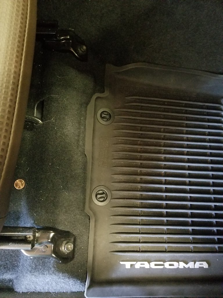

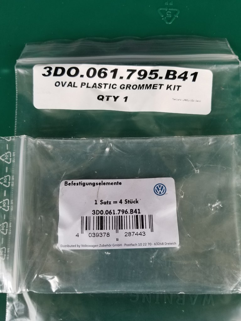

    Did my floor mats on Sunday. Pretty straightforward. Took about 45 minutes. Got parts from Amazon. Cost around $25.20170813_152547.jpg 20170813_152317.jpg

    What? 45mins?
    It only took me 5 mins haha
