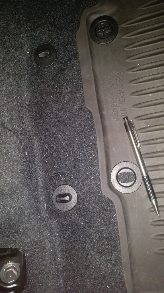

    I just did the VW anchors with the info in this thread, works perfectly. Expensive for what it is, but looks factory and solves the problem.

    You will get mixed opinions any time you ask about OEM but my OEM all weather mats have been just fine. They are far better in quality than my second gen OEM mats were. I have had no issues except for the passenger mat not staying put (same issue for all of my cars not named Audi/VW) and I will be getting the floor mat retention posts for that.

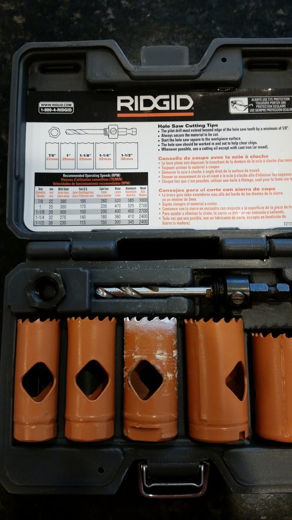

    I used this type of hole saw to make the hole. I think I used the 1" saw. It produced a very tight fit and I had to stretch the hole I cut around the "fixing parts" then snap them together. When cutting the hole I used a piece of 2x4 behind the floormat, and held the floormat firmly to the 2x4 while drilling s-l-o-w-l-y.

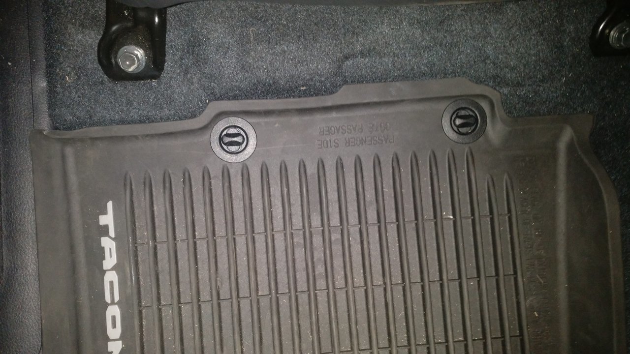

    I just did this mod today. I traced the medium sized hole on the round plastic piece to a sheet of paper to make a template, then after cutting the paper out I placed it on the rubber mat and drew the circle with a pen. Then used a razor blade to follow my lines. Worked perfectly. The whole process took maybe 10-15 min.
