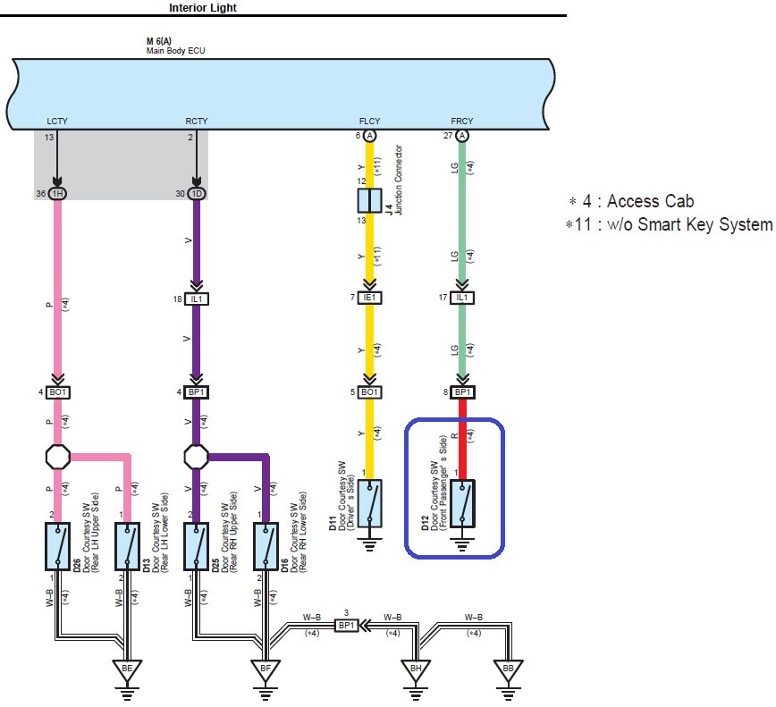

    I have a 2016 Access Cab. When I open the passenger door, the map light doesn't come on. When I open the passenger access door, both the map and the dome lights come on. I've jiggled the booted switch on the access door figuring it was a stuck switch, but that didn't do anything.
    Do I have a bad door switch or is there an option buried deep in the settings menu I need to turn on?

    Check out this wiring diagram.
