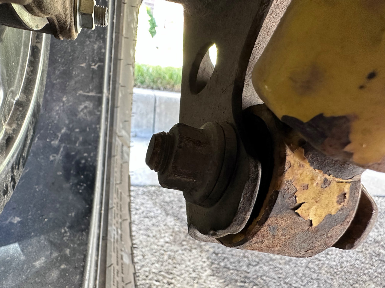

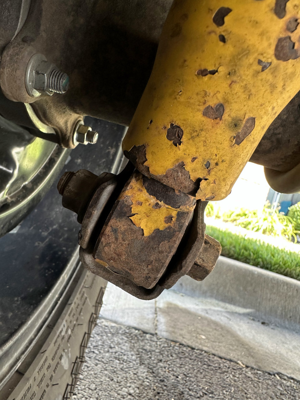

  17. Sep 1, 2023 at 10:51 AM
    #17
    whiteknight4x4
    whiteknight4x4 [OP] Well-Known Member
    Sep 28, 2020
    #342195
    278
    Drew
    Missouri
    2008 SR5 Reg Cab Taco
    2.5 inch lift: Full Dobinson's suspension kit, Freedom Off-road UCAs, 265/75r16 tires on factory Baja alloy wheels. x2 Baja Designs Squadron Sport Led Pod lights. CBI Moab 2.0 Aluminum Bumper w/full hoops, Warn Evo 8k winch. Ultraguage. Midland CB radio with 3ft Firestick Firefly. Tacomabeast/Spyder Headlights. Rear diff breather. Cruise mod. A.R.E. Topper. Prinsu topper roof rack. Hail damage mod.
    Okay I have some evidence for you guys. It seems like the bushing in the shock may be bad.
    Passenger side (the one making the noise):
    Driver side (for comparison):
    As you can see, theres more bolt sticking through the driver side mount... On further inspection, it looks like the bolt in question has a washer on it...driver side doesn't which would explain why I see more bolt sticking out on the driver's side. It's the same size bolt too, I've measured it.
    Here are videos of it. In the first one you can see I can move it with my hand. In the second one I can bounce the truck up and down and reproduce the clunk I've been hearing over bumps.
  18. Sep 1, 2023 at 10:57 AM
    #18
    Kwikvette
    Feb 27, 2019
    #284735
    81,304
    Fresno County
    4 run, 2 don't
    Holy shit...those are only a year old? :eek:
    TnShooter likes this.
