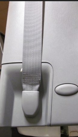

    Does anyone else have a Tacoma with the passenger seat belt assembled backwards? On mine it looks as if Toyota used a drivers seat belt assembly on my passenger side. On the passenger side the catch latch for the seat belt faces the plastic interior trim instead of facing out like the drivers side. This has cause all kinds of nicks in the plastic on the passenger side. I bought my Tacoma as a certified used with 41,000 miles in Nov. 2016 and my wife started to complain about the seat belt and I just took it as she was short and the truck didn't fit her well. That is until I sat in the passenger side and went to use the seat belt and stared to fumble with the catch latch. Since I bought this used I didn't bother taking it back to the Toyota dealer I purchased it from because I didn't believe they would do anything for me on a 6 plus year old truck at the time. I just issued a complaint with NHTSA as a safety issue. I did get a response from them for more information and pictures, but so far I'm just waiting.

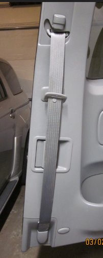

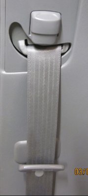

    I'll try and add some photos. The photos will show it more than just flipping one end. The whole assembly is reversed. Not only the top of the slide/pivot mechanism, but the securing point at the bottom is backwards.

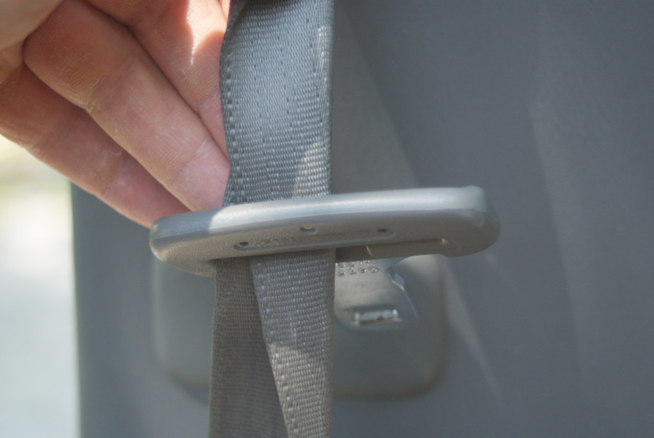

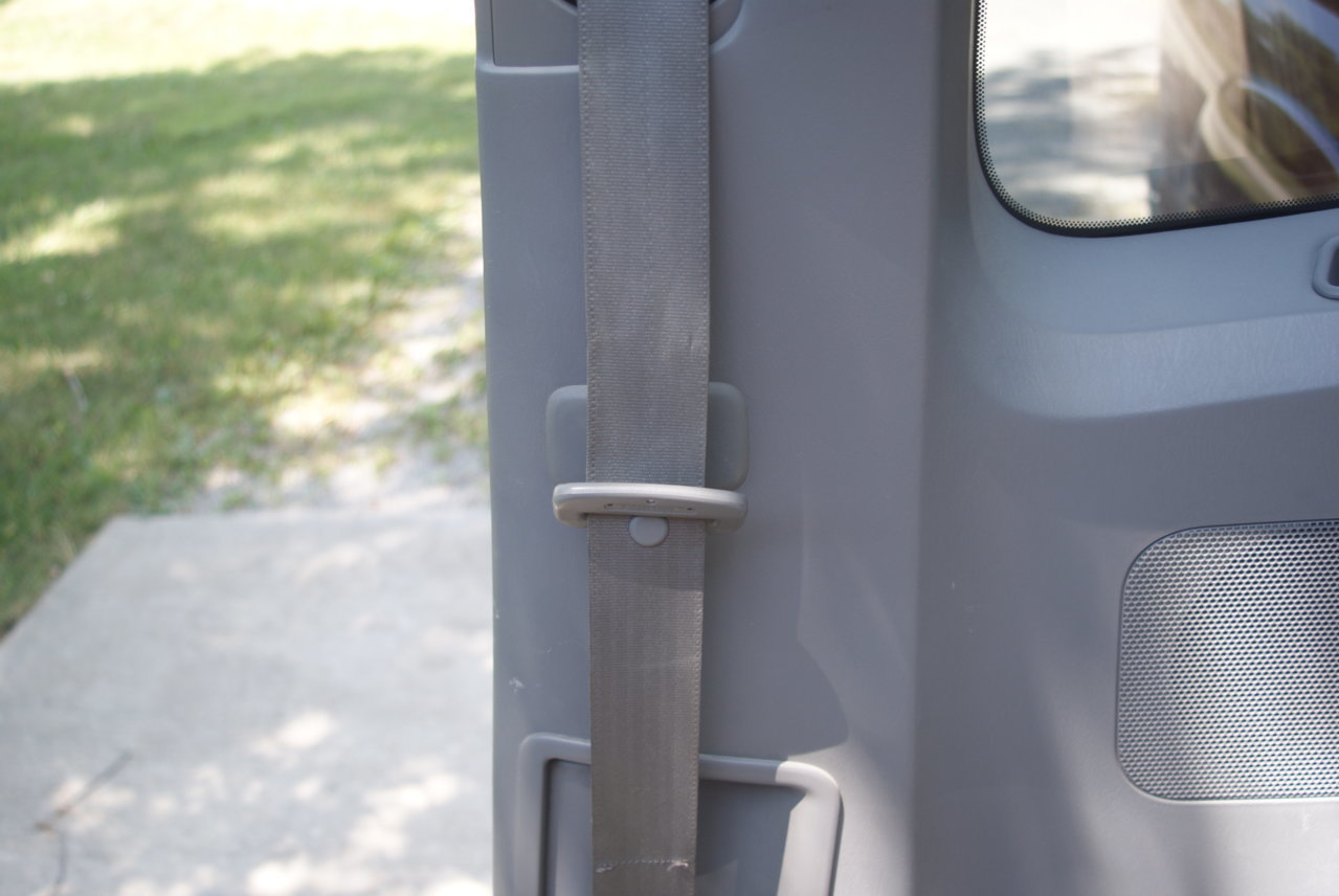

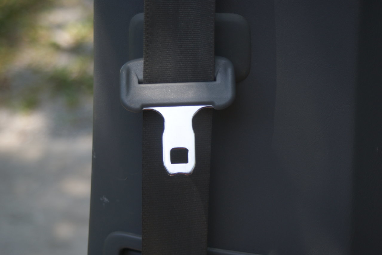

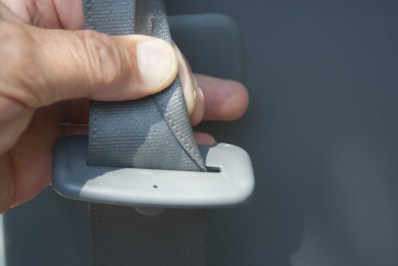

    I agree with the others here, all you need to do is flip the clip around.
    Like this:
    Before:
    Start like this:
    Keep pulling:
    Done:
  10. Jul 15, 2018 at 10:36 AM

    Thanks for the pictorial @fathomblue. Exactly what I was trying to suggest above.
