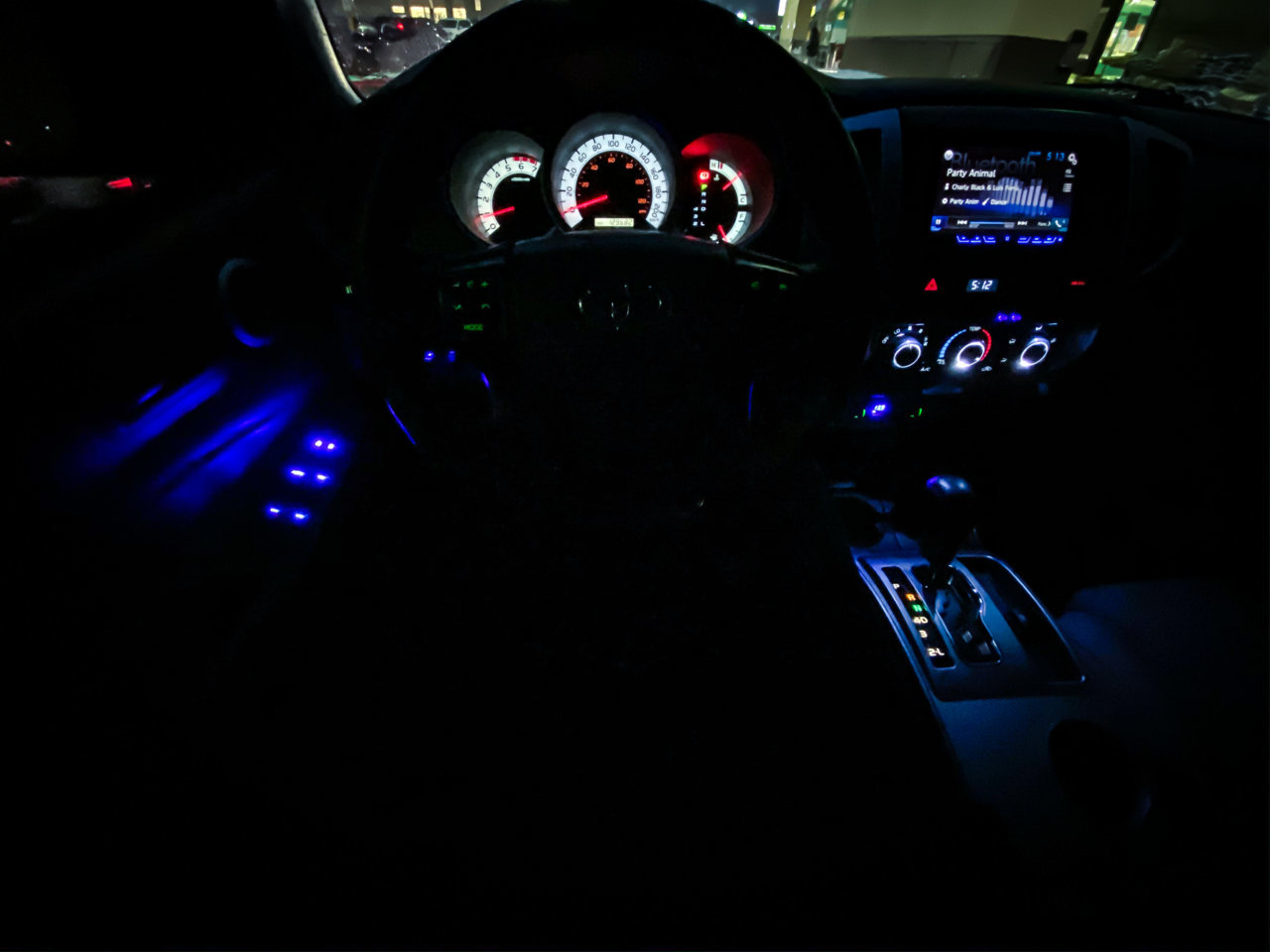

    The driver side window master switch from a 2016 Sequoia does NOT work in my 2015 Tacoma. The connector is exactly the same, the pin configuration is exactly the same, but the windows don't work. One of my back windows went down but not up. Nothing from the "auto" switches. Putting the original back in and everything works as before.
    Looks like something different inside the switch, despite having the same apparent pinout.

    TegoTaco
    TegoTaco Well-Known Member
    Sep 29, 2016
    #198555
    7,252
    Ontario, Canada
    ‘13 SUPERCHARGED DCLB TRD SPORT

    ^^Nice. Is that the AliExpress switch? I almost went that route for $73 but was afraid it would eventually fail.
    :( Good to know. Mine arrived today & will be able to confirm this later. It was a long shot but had to try it. Odd that the plug config was changed for newer models when other models still use the obviously different plug.
    Was yours a new or used one?
