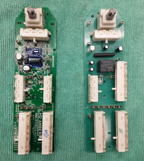

    @4xdog CONFIRMED :mad:
    Circuit board is different. Switches are the same unlike other variants. May look at the pin assignment to see if it's still doable.

    aktaco12
    aktaco12 Well-Known Member
    Oct 19, 2019
    #308434
    104
    AK
    2012 4x4 DCLB TRD Sport
    Our pcb uses 13 of 15 pins. Sequoia uses 11 of 15. Some pcb markings are identical & obvious and could be repinned while a few are not. So unless one knows what LIN, LED, (locks?) & +B refer to, it's a no-go.
    Sorry for getting any hopes up.

    #149
    aktaco12
    Oct 19, 2019
    #308434
    104
    AK
    Sequoia pcb has over 2x the circuitry of the Taco's & has 2 Auto UP/DN switches as seen in the pic. Only way to make it work would be pin reassignment. I will play with this more since I have the switch but am doubtful I'll get anywhere.

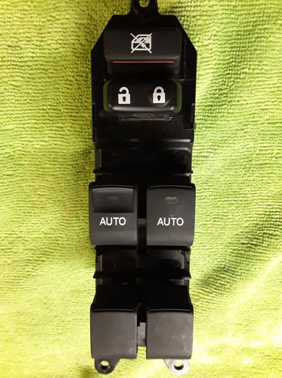

  12. Jan 15, 2020 at 8:12 PM
    #152
    aktaco12
    Oct 19, 2019
    #308434
    104
    AK
    2 fronts are AUTO UP/DN and LED lit. 2 rears aren't. But only on fancier Tundra/Sequoia models. I think base models are the same config as Tacomas.
    The boxed text "LHD AMBER" tells you it's lefthand drive & lights are amber colored. 1 micro LED is next to each front switch.

  14. Jan 20, 2020 at 4:09 AM
    #154
    aktaco12
    Oct 19, 2019
    #308434
    104
    AK
    So the Sequoia switch seems to be a hybrid between the other 2 styles. Looks like some functions can be re-pinned to work but others are directly controlled by the ECU. There's no direct pins for the locks or passenger window. As-Is it's a No-Go. @4xdog The right rear window pins are identical, probably why they worked one way for you.
  15. Jan 20, 2020 at 4:52 AM
    #155
    aktaco12
    Oct 19, 2019
    #308434
    104
    AK
    Don't suppose you'd pop it open and post a few pics...
    I can say the Sequoia AUTO switch is identical to the Taco's. The UP & DN detents are in the swivel button but unless the pcb is configured to respond to it nothing will happen.
