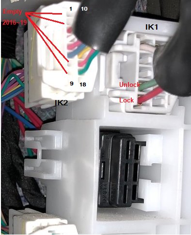

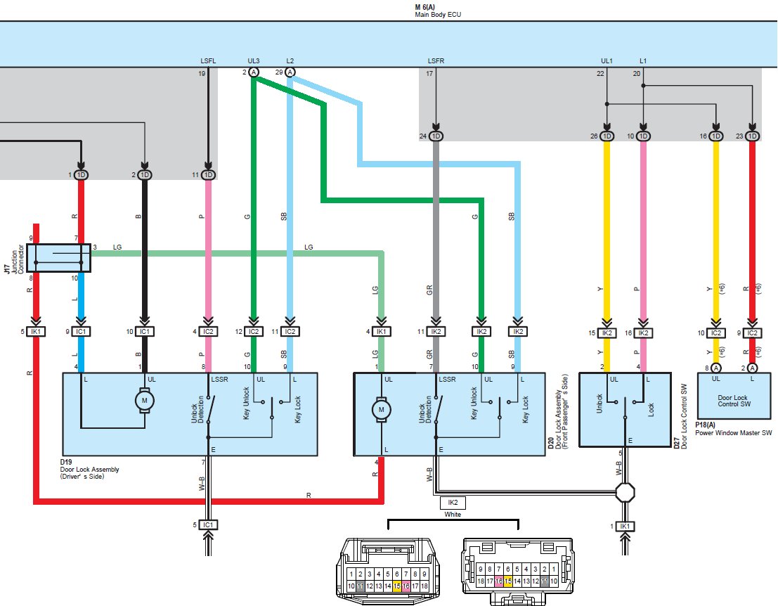

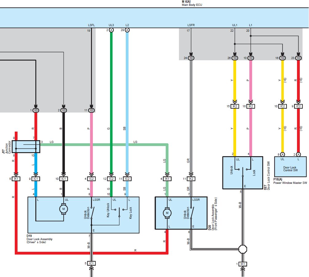

    Maybe from this:
    To this:
    IK2 has a few empty slots,
    both missing wires after the IK2 would run to the Main Body ECU connector M6.

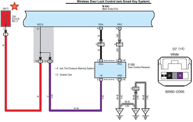

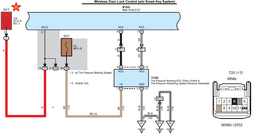

    Another highly probable $olution:
    or
    Adding the missing Door Control Receiver and programing some FOBs.
