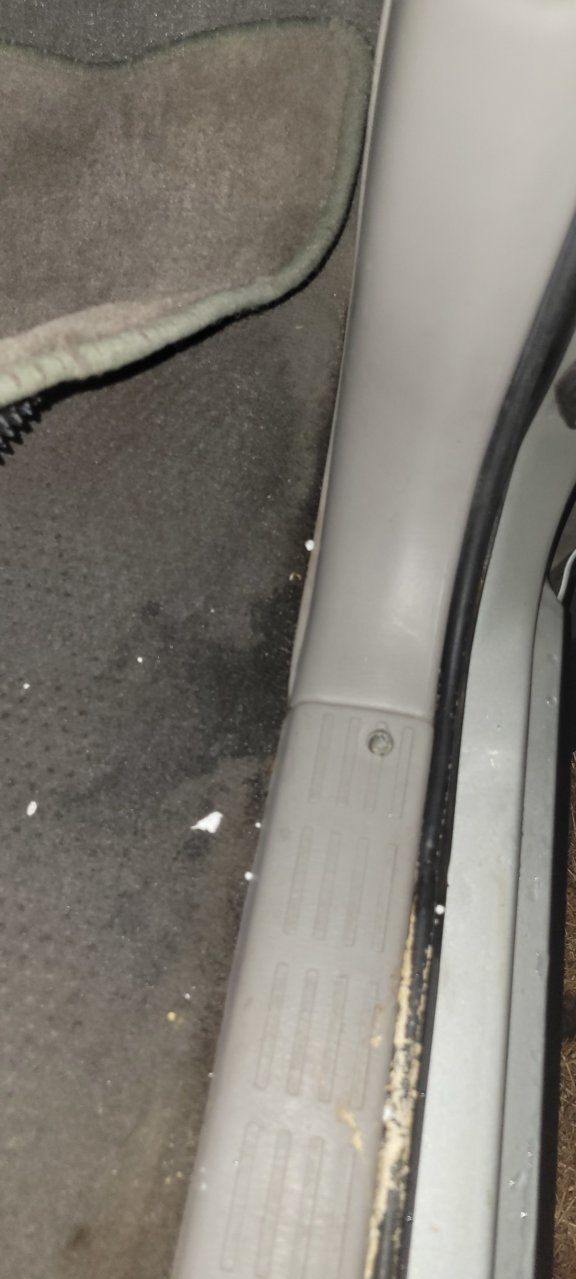

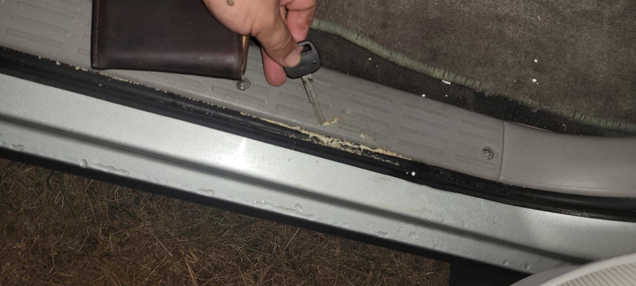

    Now I'm wondering what could it be. It seems like the floor gets wet each time it rains. So I'm wondering can it be the trucks door molding?
    I'm a bit worried because it's gotten to the point that the inside of my Tacoma a thick coat of water condensation forms on all the windows, and anything I leave inside feels damp, specially papers, and documents.
    I am inclined to think it may be the door molding as I do not see any wet spots or leaks coming from the AC or that area in particular.

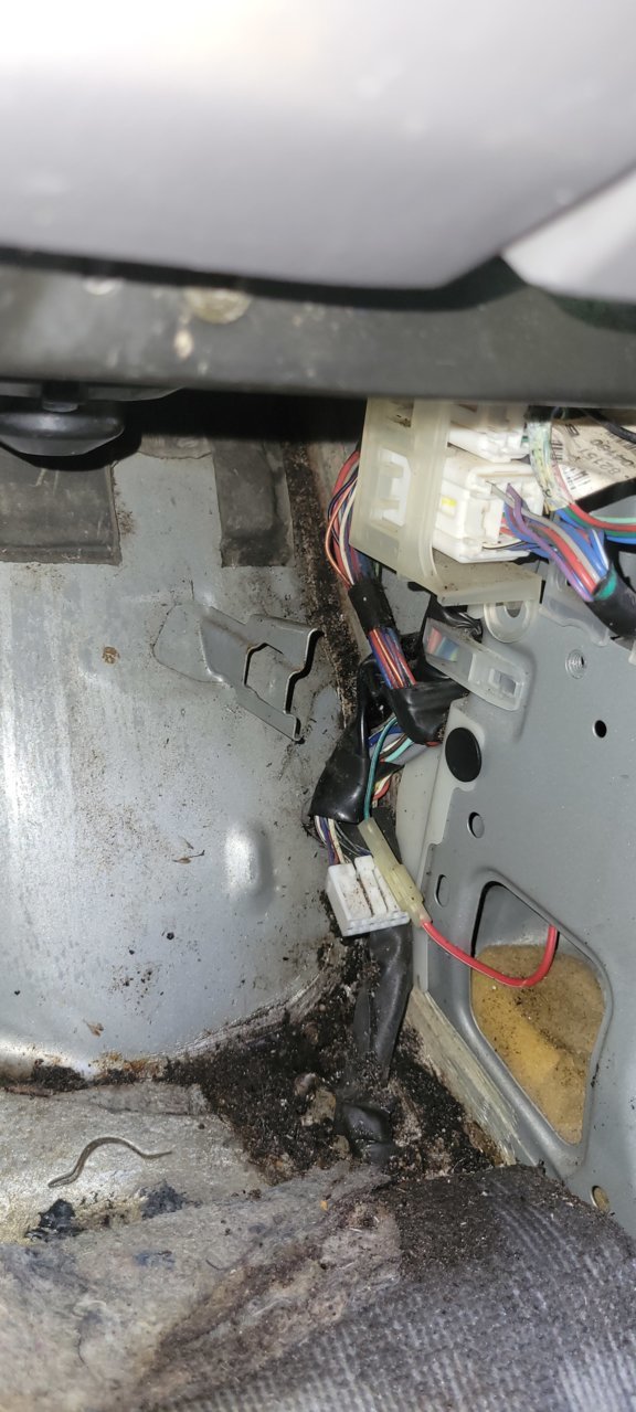

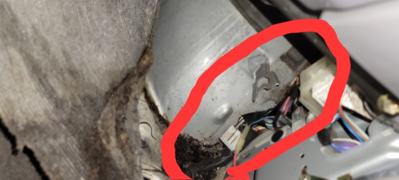

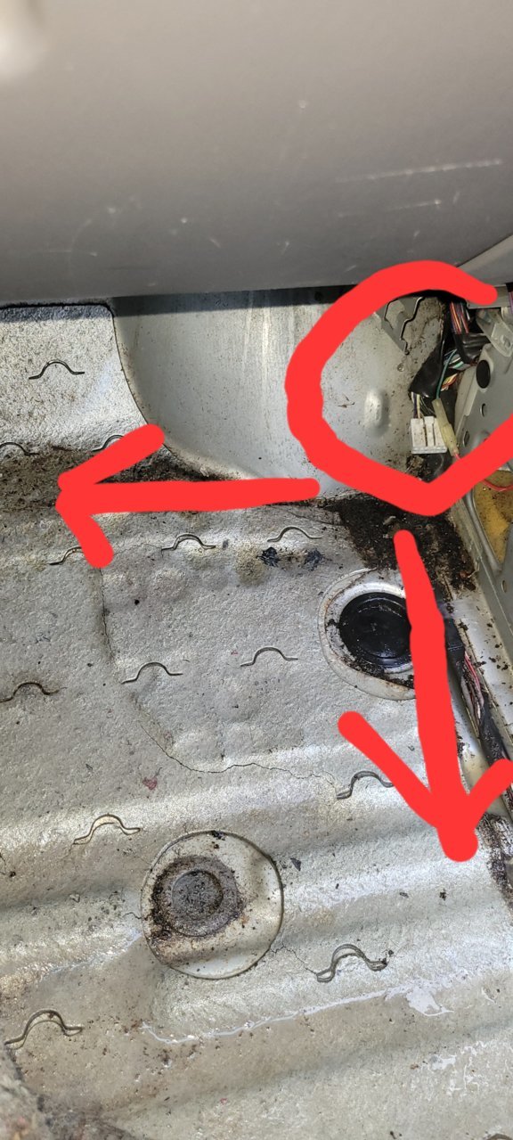

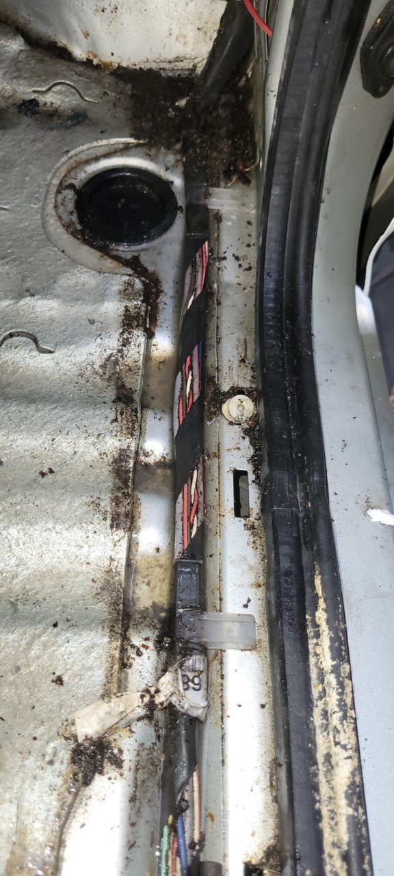

    Update:
    I just decided to remove the carpet. This is what I found. Seems like there's a look coming from the areas I marked highlighted in the pictures. If so where can these leaks originate from? Also in that area there's a trail of little ants.
    I also checked the door molding and it was dry.
    All the images are on the back right side under the glove compartment.

    198
    I just posted some new images of the floor without the rug and what I believe may be the source of the leak. Not sure if it is but there's an ant trail and it's all wet in that area.

    Oil leaks
    Search around this forum for a leaking cowl, sealing a spot welded area etc. I don't remember exactly, buts it's a known issue.

    01 Dbl Cab
    X2 on the cowl leak. I had that happen on both sides of my truck. Pull that trim piece off and run some sealant along the seams and it never came back. My situation under the carpet was waaaay worse too.. luckily tubbing it cut away the worst of it.

    All of the above :thumbsup:
    Is that black mold? if so, a good steam clean/disinfect of the carpet. Before putting it all back in, get rid of all that black stuff. If it is black mold, you don't want to leave it unchecked.

    198
    I checked if it was black mold but it seems to be dirt, it seems like the ants have built a little trail from that side that is wet. Even if it is dirt I will clean and disinfect the area to prevent mold or mildew from growing.

    Maybe see if it leaks into the truck while it's running. Could be a partial blockage allowing it to fill up.
    I'm still leaning towards the cowl leak, mine does the same but I haven't fixed it.

    I just found a small hole where it seems the ants are going through underneath the cowl right above the passenger side. I think this may be it since the ants have formed a trail inside the truck.

    198
    Little update. Seems like the leak definitely is coming from the cowl area.
    Today it rained quite a bit and I found a small stream. Here its is...
