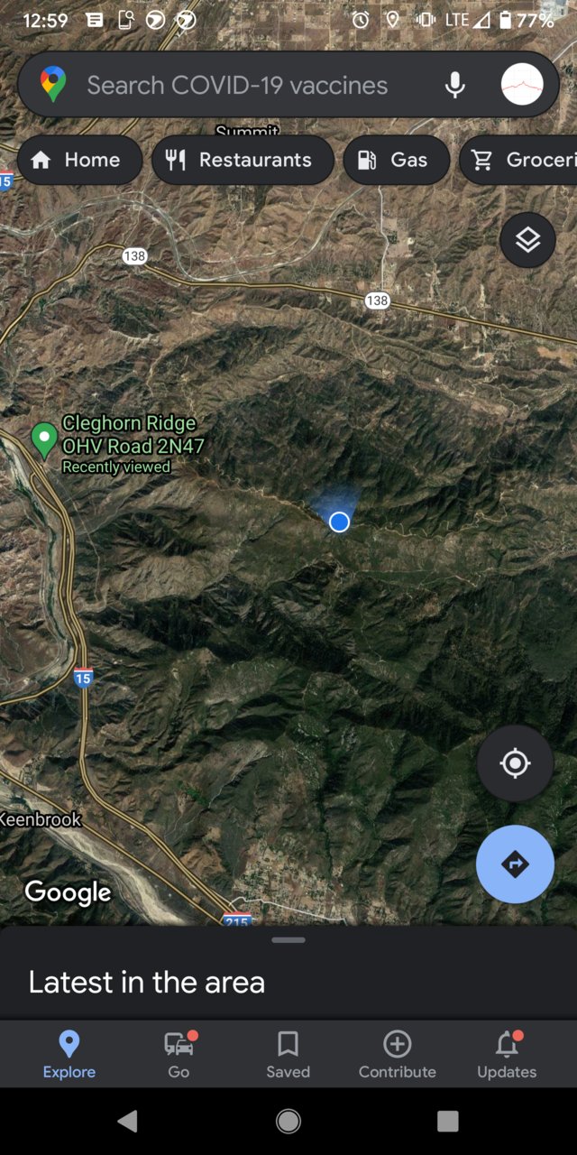

  3. May 22, 2021 at 12:55 PM
    hoffengineering
    hoffengineering [OP] Well-Known Member
    Mar 9, 2020
    #321727
    802
    Taylor
    Orange County, California
    2015 DCLB 4X4
    I'm in socal, on Cleghorn Ridge trail currently
  4. May 22, 2021 at 12:56 PM
    tcjacado
    tcjacado Well-Known Member
    Aug 29, 2016
    #195947
    41,570
    Are you in a offchute or on the fire road? You should probably edit the title to "stuck on Cleghorn "
    Hobbs likes this.
  5. May 22, 2021 at 1:00 PM
    hoffengineering
    Mar 9, 2020
    #321727
    802
    Taylor
    2015 DCLB 4X4
    I'm on the main trail that goes from the 15 and dumps out at Silverwood lake.

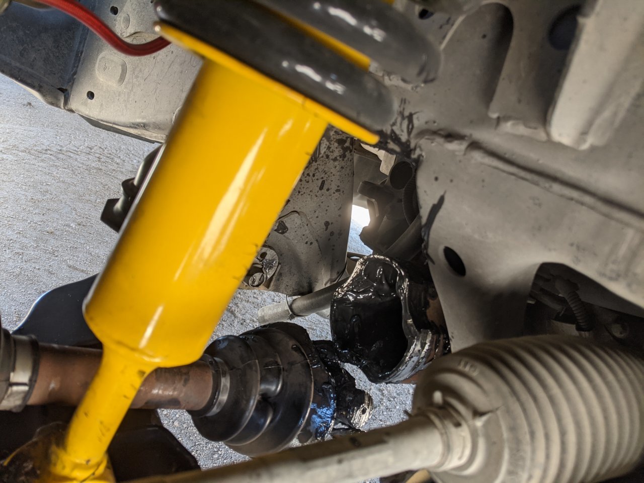

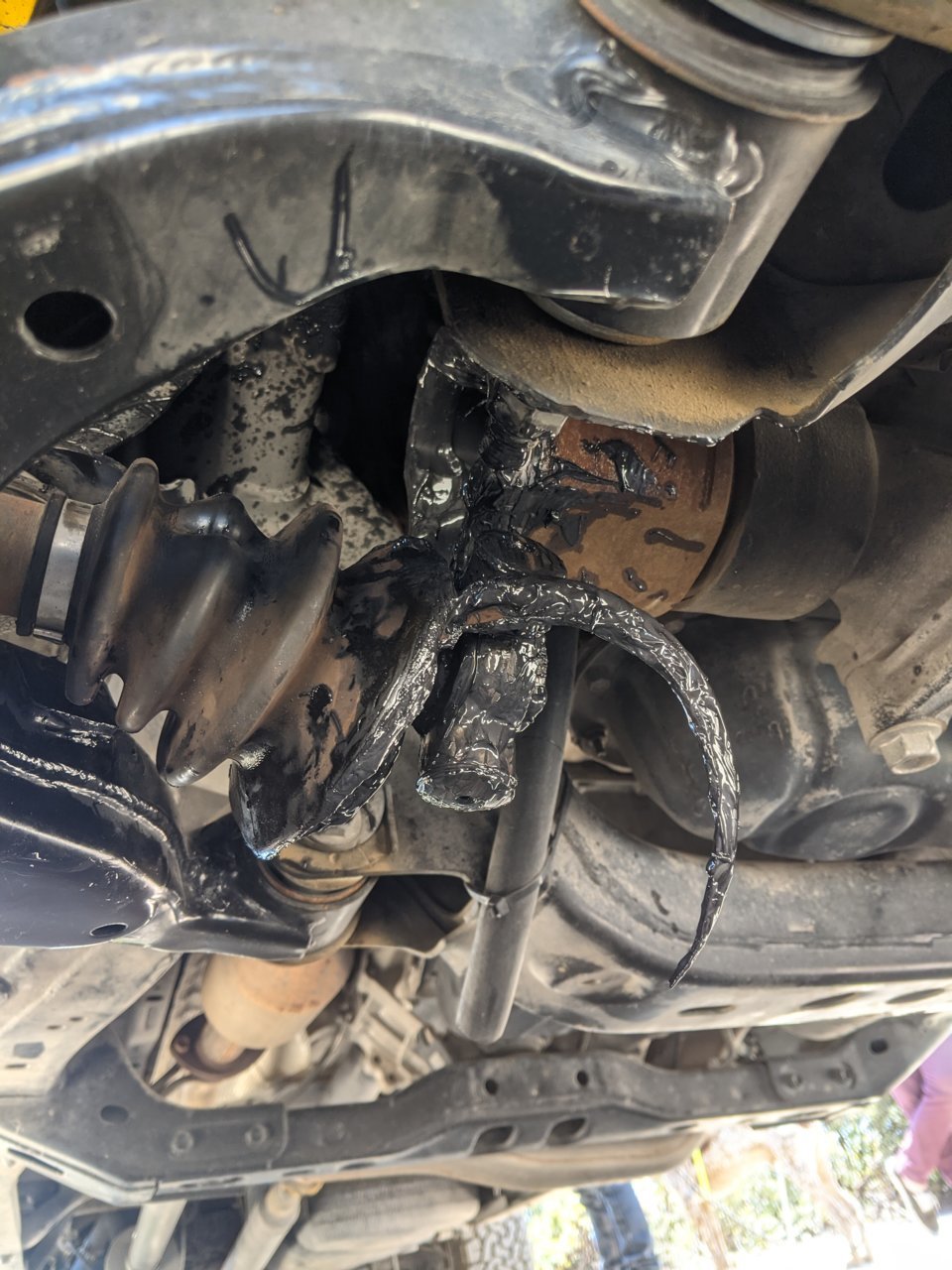

  9. May 22, 2021 at 1:12 PM
    hoffengineering
    Mar 9, 2020
    #321727
    802
    Taylor
    2015 DCLB 4X4
    Current state of things.

  10. May 22, 2021 at 1:15 PM
    mysubiewasalemon
    mysubiewasalemon Well-Known Member
    Oct 18, 2018
    #269886
    2,466
    Can you get out of 4wd and use wire or zip ties to hold it as center as you can to get off the trail and then get it towed

  15. May 22, 2021 at 1:20 PM
    TnShooter
    TnShooter The TacomaWorld Stray
    Sep 2, 2010
    #42625
    21,220
    Deogee
    07' TRD Off-Road, Auto
    STOCK
    I think @EatSleepTacos might have done something like this once?
    I think there is a way to “make it work”.
    But you’ll for sure need to retain the hub side shaft with axle nut.

  16. May 22, 2021 at 1:21 PM
    #16
    azzwethinkweiz
    azzwethinkweiz Well-Known Member
    Sep 6, 2016
    #196623
    974
    Tucson, AZ
    2013 4x4 DCSB V6 6-Spd, TRD OR, Tow Package
    I'm not sure how the halfshafts are held together on the outboard side but would it be possible to cut open the boot on the outboard side (nearest knuckle) and remove the axle shaft itself and go home in 2wd?

  18. May 22, 2021 at 1:24 PM
    #18
    EatSleepTacos
    Mar 24, 2015
    #151688
    59,838
    Randy
    West Valley, AZ
    2017 4Runner
    On the diff side, there is nothing that holds the joint together, hence why it slipped out. I would just slip it back in there and head to the nearest auto parts store.
    you’ll likely need to remove the cv axle from the spindle to get it back in, then reinstall.
  19. May 22, 2021 at 1:24 PM
    #19
    hoarder23
    hoarder23 Truck fell over
    Aug 14, 2012
    #84787
    12,884
    Shay
    NJ
    15 Pyrite Mica DCSB Sport
    Scratches
    If you can get it to seat back in the cup you may be able to limp it off the trail. Or get someone to run to autozone for a replacement CV, not a terribly hard trail fix.
