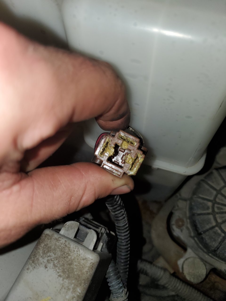

    Pic of the yellow sticky crap.

    Im kind of confused how to get at the bulb. It seems like its a whole assembly... Where as the yellow running lights are easy to get at. Ill go take another look at it though.

    NVM! remove the plastic boot and there is a clip. Im a switch them here one min.

    You guys were right! I can see a piece of the filament inside the broken one. And switching them also confirmed it. Thank you guys!!!
