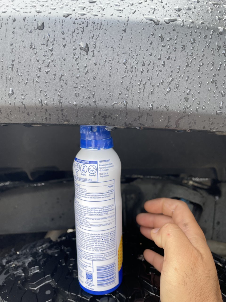

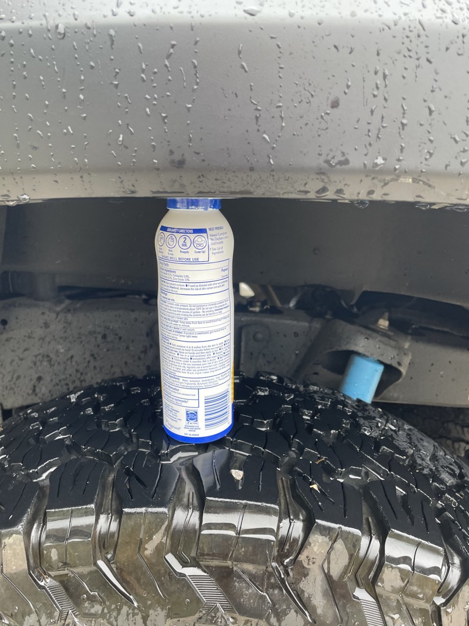

  19. Oct 9, 2021 at 11:54 PM
    #19
    Grand Masta Flex
    Grand Masta Flex Active Member
    Sep 20, 2021
    #377547
    25
    2017 Taco OR- Sold!!! 2023 Taco OR
    Dreaming
    I believe I may be having the same issue. Driver side is lower then the passenger. Hopefully no cause for concern. Don’t mind the measuring tool
