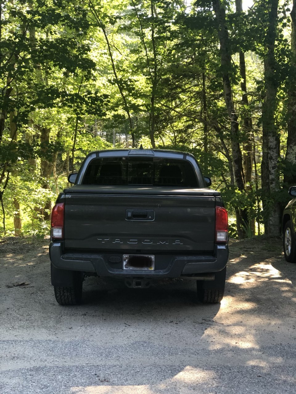

    Stepping out the other day and noticed I had a slight “lean” but it was on the passenger side, not drivers side. Any idea what could cause this?

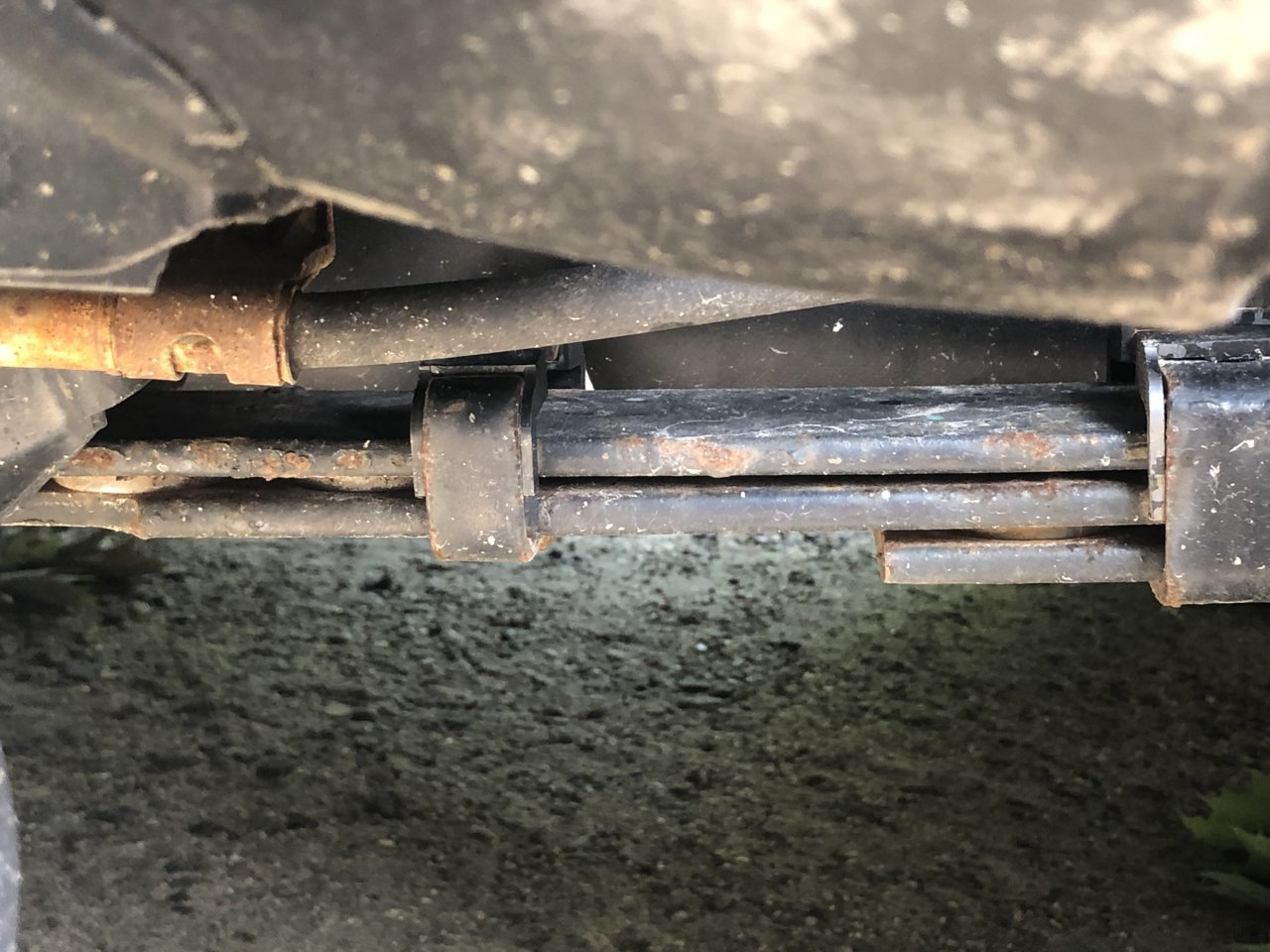

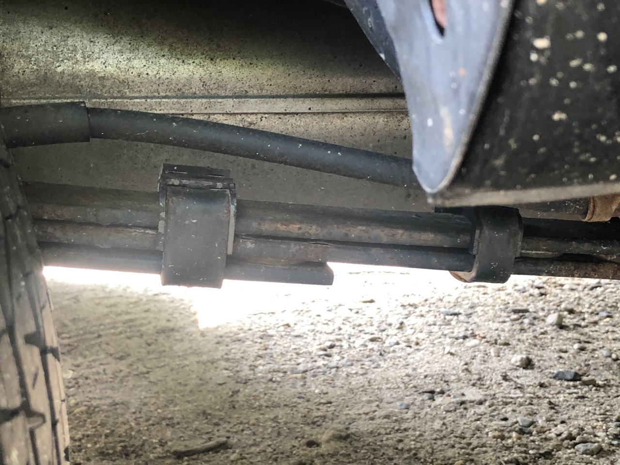

    Nothing really seems to different from what I can see. Right side should be first pic

    Compare everything suspension related to the other side. Spot the not. Break out the tape measure even.

    Ck where the leaf springs are joined together at the axle. make sure there are no cracks in any of the leafs. Did u try moving the truck to known true flat surface to be 100 % sure ground is not the problem ???

    My knee jerk is to say it's just uneven ground because you are in a dirt parking lot after all. Even if it looks level, it probably isn't. I would go to a level, paved area and see if it's still leaning.

    Or if the truck is still in the same spot, 180 it and see if it's the same

    agreed. Pull it in to a garage or parking structure to see if the lean is still there. Gas stations are usually a good option but not perfect. Measure center of hub straight up to fender on either side and compare measurements.

    Ditto. If the OP doesnt have "knowledge on vehicles and their workings" checking the vehicle on a level ground would be the easiest place to start for the OP.
