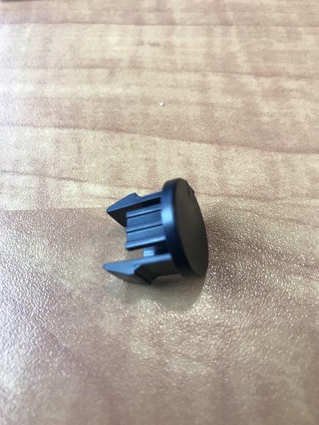

    I 'm still at dealership and this is what they found that was causing the rattling noise on passenger side of truckIMG_1303.jpg

    Where was that?

    Where was it found? Just looks like a snap in screw cover.

    They said it was at the speaker cover on passenger side dash

    Strange, I don't ever recall seeing a cap like that on the passenger side. I've pulled the A pillar and speaker cover area apart several times already. Probably fell in there as a loose item from the mexican assembly line.

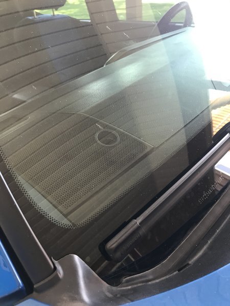

    Sorry it took so long, but it was underneath the pictured speaker coverimage.jpg

    Was it a part that belonged under the speaker cover or some errant piece that fell in there or something?

    They way they talked it was something that snapped off in there but didn't say much else the dash has never been messed with or taken apart and don't never sit anything up there on it

    Plug used to cover the hole where the light sensor goes if it had automatic headlights!

    So this is something that was left under the dash during production?

    See that lil hole. Well that's what that snap in part goes

    But that doesn't mean you have automatic headlights. From the looks of the sensor slot, there is not a sensor, the plug is likely the cap for it.

    Mystery solved, went out and popped mine off. Blank Cover for those of us without auto headlights
