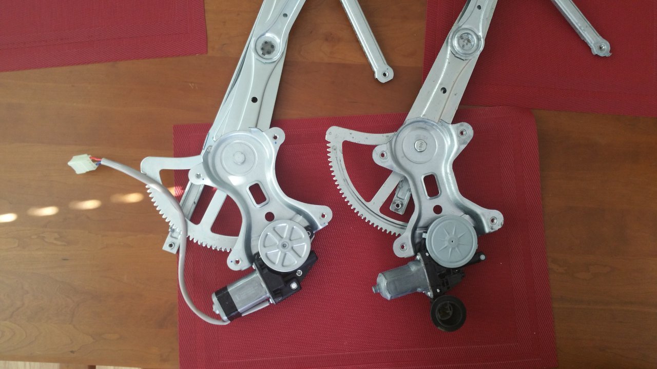

    The part I received has a cable with a female end on it. The original does not. While it fits, the motor only goes in one direction. There are only two prongs in the receptacle. The original has more.
    Does anyone know what part number I need? Or should I just buy the motor? It seems the motor alone costs more than the whole regulator and motor.

    One on left is wrong one
