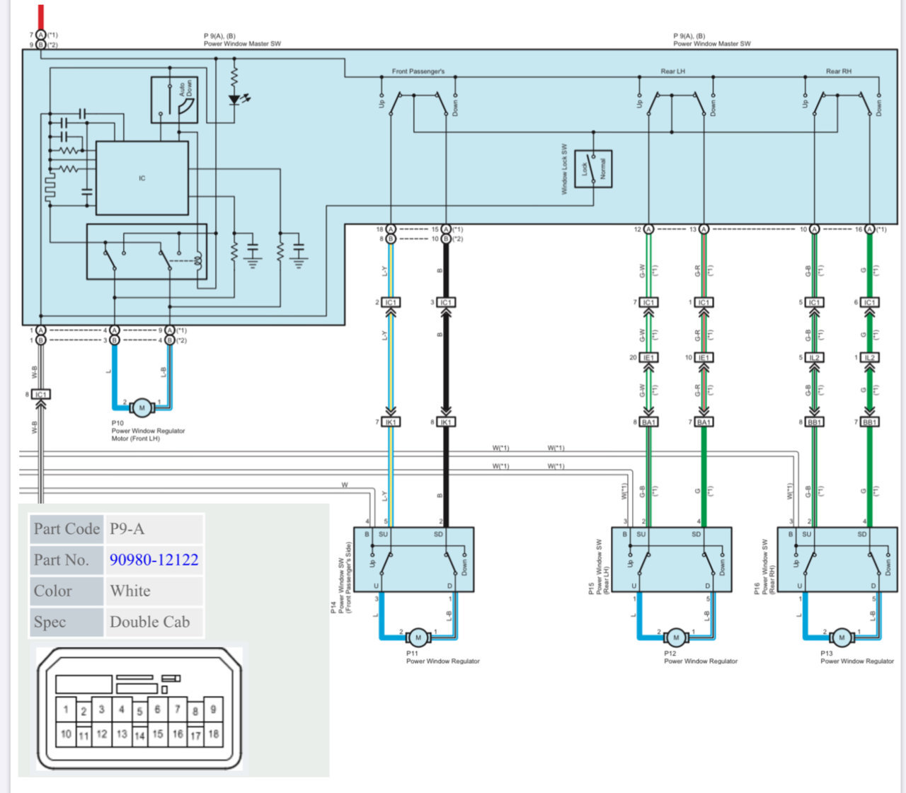

    I had the same problem. Rear passenger window would roll down ok but not up using either the door switch or the driver master switch. Finding this diagram https://twstatic.net/attachments/625411ea-6784-4c22-b7be-3f1063dc8b8e-jpg.5252453/ I could see that the two switches are wired in serial. Since it would roll down fine that told me either there was some kind of gearbox problem with the motor or one of the two switches was faulty. Since I frequently ride with that rear window down and a dog hanging out of it the switch gets wet from time to time so that was my first suspect.
    The short story is I managed to pull the switch out and then took it apart. As I feared because it is not weatherproof or waterproofed in any way after 9 years it had accumulated a good amount of internal corrosion. It is a double pole double throw mechanism with 2 V-shaped copper levers. So there are 4 contact points and 2 friction contact points to go bad. The friction points were in good shape but the contacts had accumulated a white-green chalk over them. I cleaned them up with a wire brush and sprayed some contact cleaner on for good measure. I also cleaned the 5 connector terminals which were also in bad shape but I doubt that was a problem since they are tight fitting. I put the switch back together (easy) and plugged it in and then heard the glorious sound of the window closing up tight again.
    I found this video after my first failed attempt to remove the switch from the door https://www.youtube.com/watch?v=iQmDoZSZuY4. It's a good walkthrough of the whole fix. A couple of things he doesn't mention though. First is it ain't nearly as easy to remove the switch from the door as he shows. It's not just a matter of putting a screwdriver or spudger under the front and lifting it. There is a metal catch that has to be snagged by pushing your tool down and then rearward. You can see it on pics from parts stores. If you don't do that you will likely crack the switch assembly. Second is when you take the switch housing apart be prepared for the 2 little copper levers to go flying. There are no loose springs in it but there are springs built into the switch toggle to eject them. I was able to easily get the housing apart by using 2 guitar picks to unlock the 2 pairs of plastic snags.
