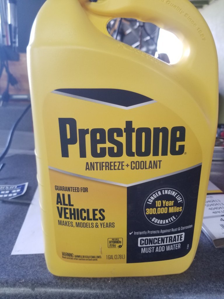

    Will this coolant by ok?

    If you’ve flushed your coolant it will definitely be fine. I’ve used the “good for all makes” coolant in my 08 that uses the pink oem coolant instead of the 04 and earlier red oem coolant. Idk if it makes a difference between the two.
    Most parts places sell Toyota / Lexus / Asian pre-04 red coolant which will match in color and work also.

    I have not flushed, only drained, my bottom belt from rockauto is too short so i have to make a parts run, i will see if i can find a more compatible coolant while im out, again thanks for your help! I have to say im not sure i would take this job on again. very little went smoothly. Probably im out of practice. And feeling old.
