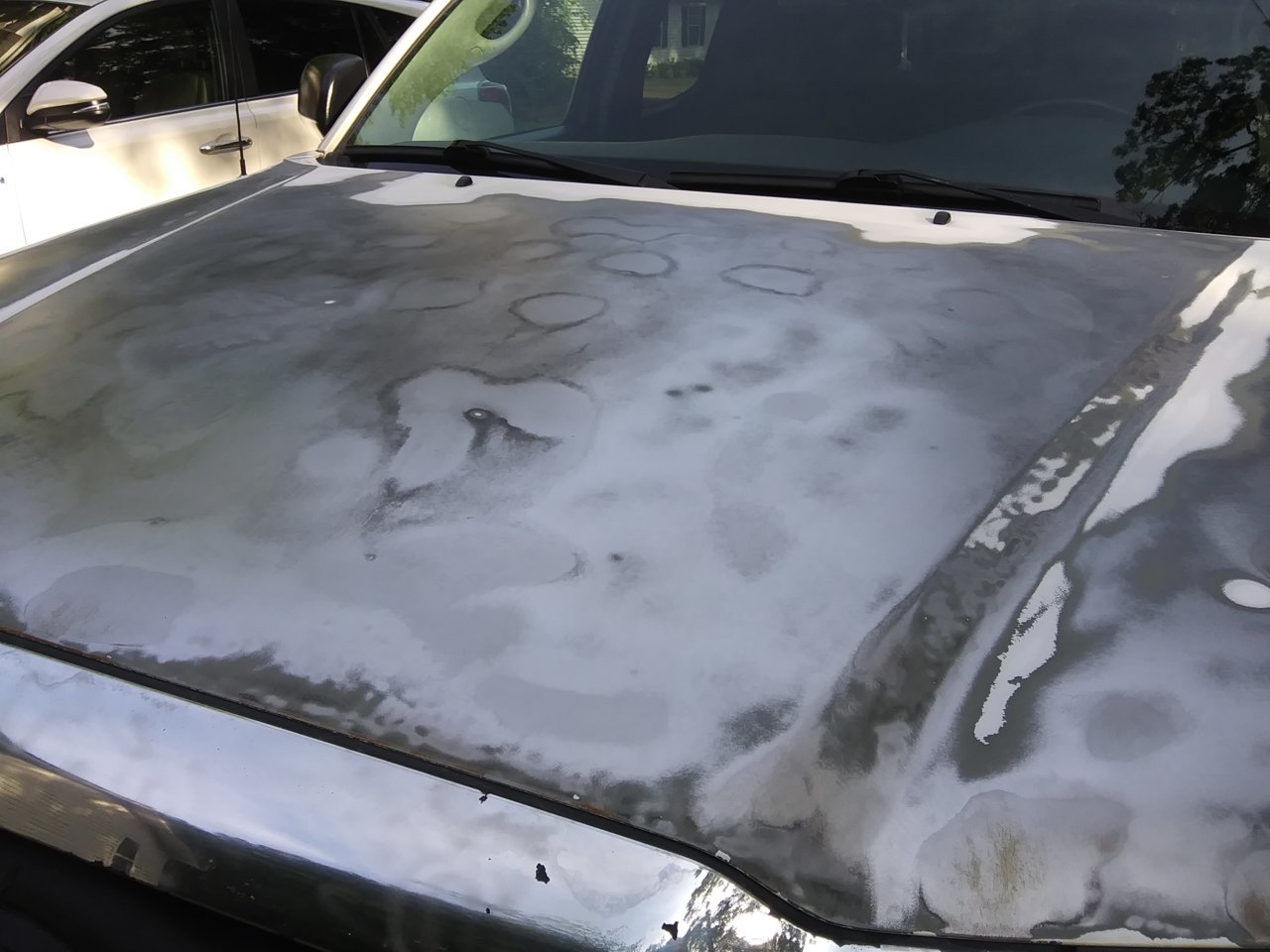

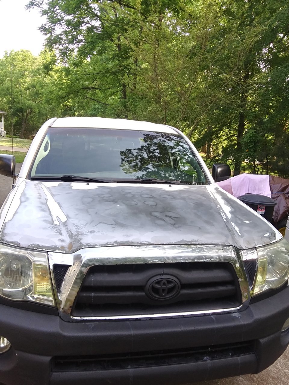

    Wanting a patina on my hood so I sanded it down. Question, do I need to sand it more and can I achieve a faster than waiting for it to rust ? Thanks.

    A solution of hydrogen peroxide, salt, and vinegar will promote rust. Apply with a spray bottle and wait.
    For the extra mile, apply the mixture and then steam the surface with a carpet cleaner - the rust will develop pretty much immediately.
    Take all the loose rust off with fine (0000) steel wool, and then repeat as desired.
    Follow up with Poppy's clearcoat - https://poppyspatina.com/

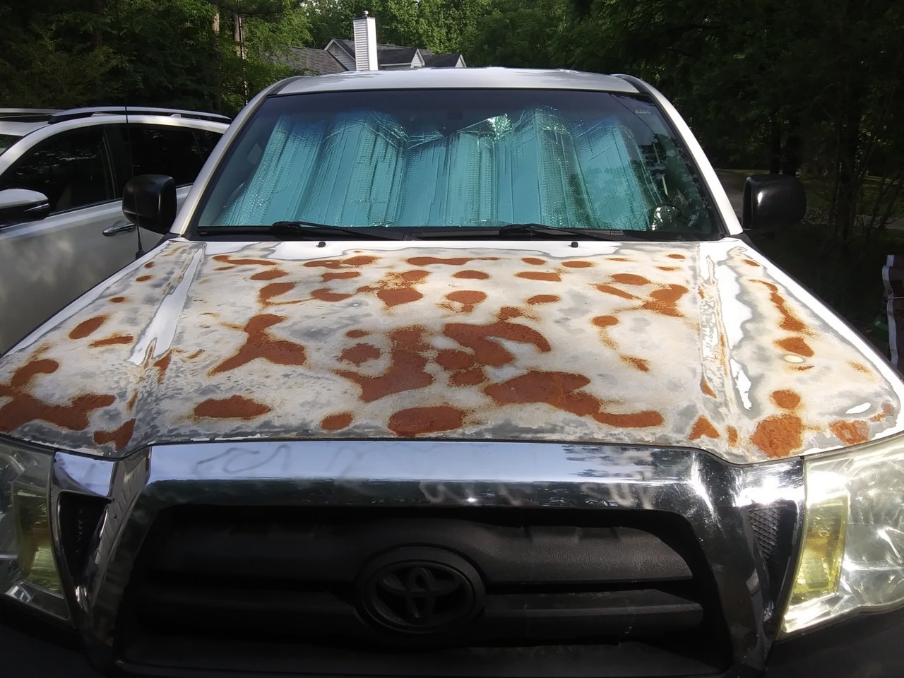

    Updated photo.

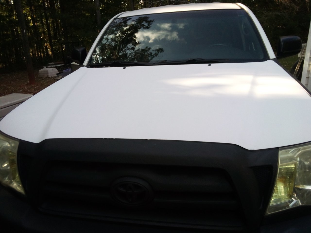

    I think I've lost the plot here- what was the point of intentionally sanding/rusting it if you were just going to paint it again?
