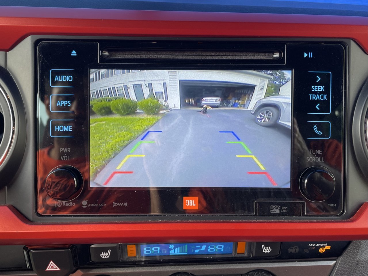

    While I had the dash apart for the USB relocation, I also added in the Anytime Backup Camera F&R kit. I ordered the switch kit and then got the RAAYOO camera from Amazon. Wiring was pretty straightforward and I added the navigation override as well (cut wire on pin 17 and run a switch in series).
    The switch that comes with the ABC kit fits in the small Toyota switch openings but I did not have any open spots left. I had never found a use for the cubby on the driver’s side of the steering wheel so I decided to make a switch panel for that location that would fit three small switches. It’s a tight fit for three switches, but I was able to draw up and 3D print a panel that would fit them. I put the ABC switch in one spot, my push-button switch for the navigation override in the other, and have a blank in the third spot.

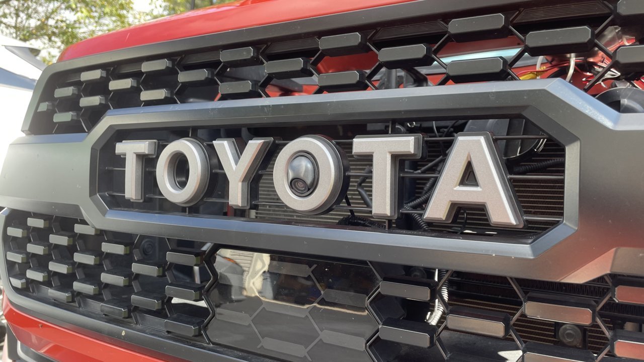

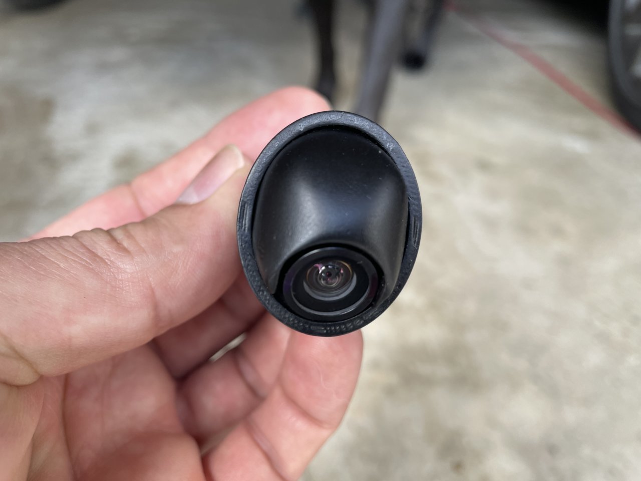

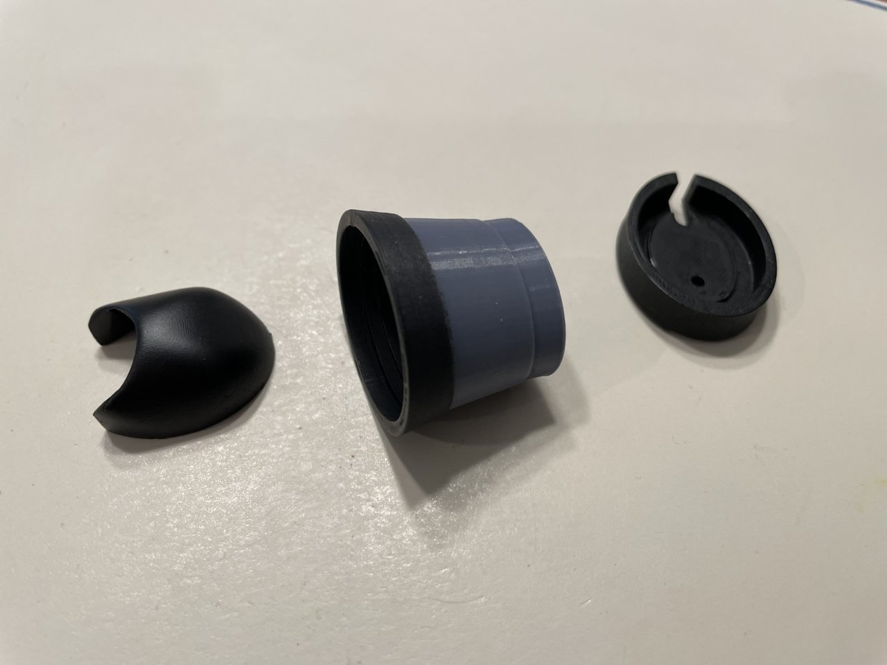

    I’ve been working on a better mounting solution for the front camera and finally got something that I’m happy with.
    Tried something a little different by modeling and 3D printing a 3-piece mount for the camera in the “O” of Toyota. The front cover is superglued in place and then the back piece screws in from behind the O to clamp the assembly in place.
    The fourth image shows the view with this mount - I can just see the edges of the front bumper which I think is going to be perfect in knowing where exactly the front of the truck is.
