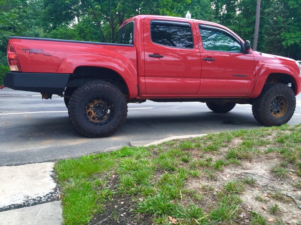

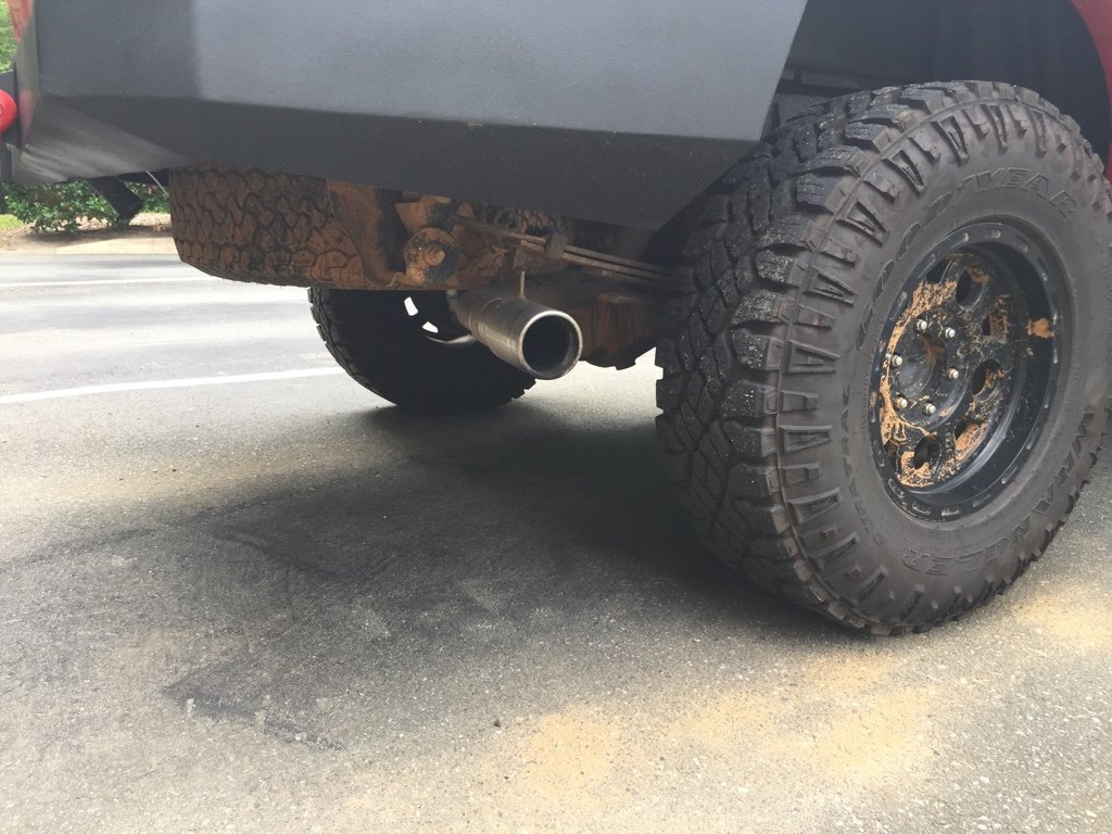

    That does look better. What ya chop it with? I have stock bumper and the exhaust sticking out is bothering me.lol
  7. Jul 10, 2015 at 7:48 AM
    #147
    tacopaulo
    tacopaulo [OP] Tanned
    Apr 4, 2014
    #127015
    4,736
    Paulo
    Raleigh, NC
    red truck
    We used tims cutting wheel
    Lol at this pic
  8. Jul 10, 2015 at 9:56 AM
    #148
    3milecreek
    3milecreek MtnGoat
    Apr 17, 2015
    #153396
    2,703
    Stephen
    Barnwell SC
    Heavily Modified 94 Yota
    Never the same
    Haha I see high clearance really helps you get to rear end alot easier. I'm gonna have to get under mine and chop now.lol

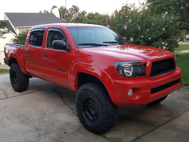

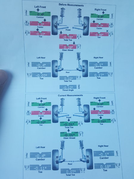

    how far off is your alignment with the stock UCA?

    What did you set your billies at? Or is that lift all from the OME springs?
    tacopaulo[OP] likes this.
  13. May 4, 2016 at 12:33 PM
    #153
    tacopaulo
    Apr 4, 2014
    #127015
    4,736
    Paulo
    Raleigh, NC
    red truck
    Thanks man. I forgot about this thread lol.
    Billies at 0. So yea the lift is coming from the OME Springs plus the top plate spacers.

    sorry for the late reply by here is my latest alignment. this was 2 weeks ago. the guy said he couldn't get my caster up any higher. so the plan is to get some LR UCAs from a member here hopefully, and get an alignment after I put them on.

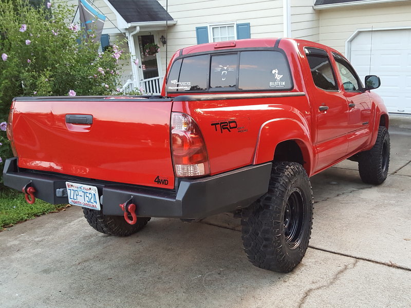

    Just back up...Wait...no, dont move AT ALL! Definitely sitting on the edge of the diff/drive shaft flange.
    Lesson: put your tires on the big rocks.
