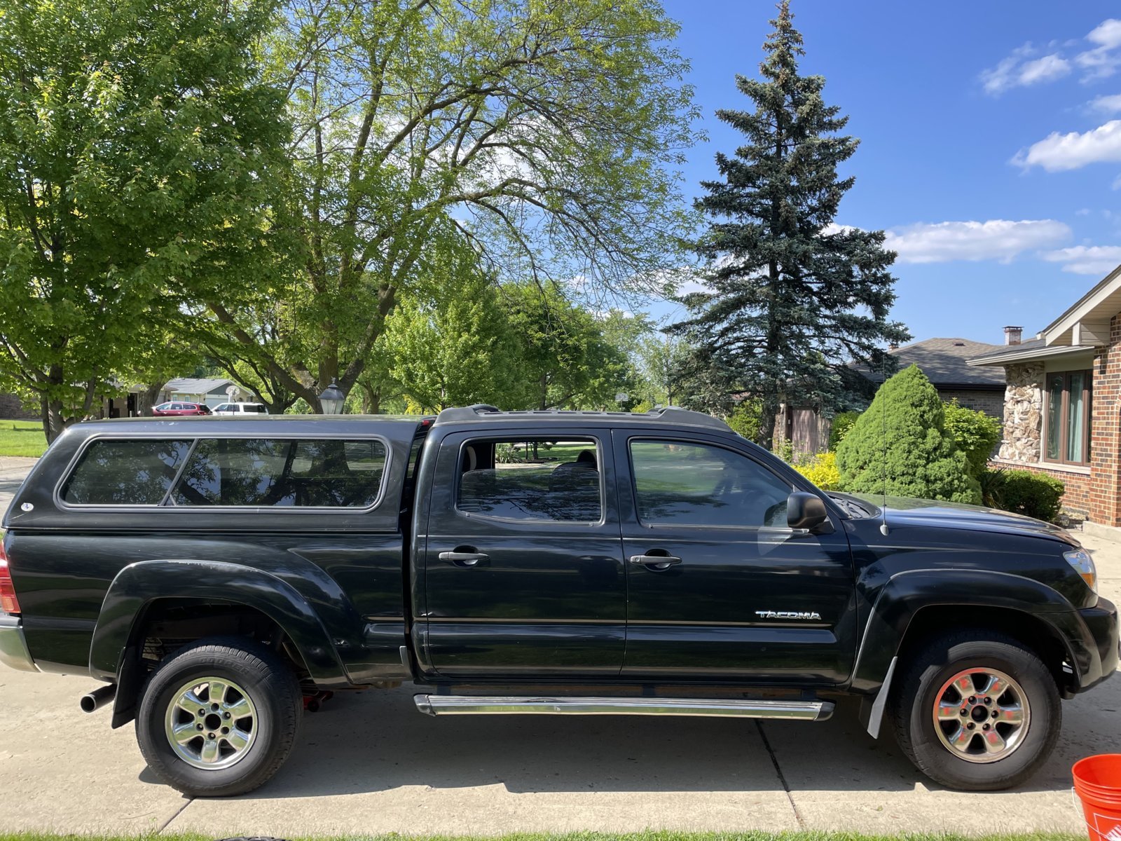

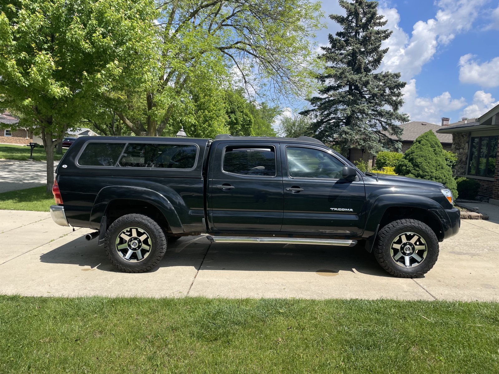

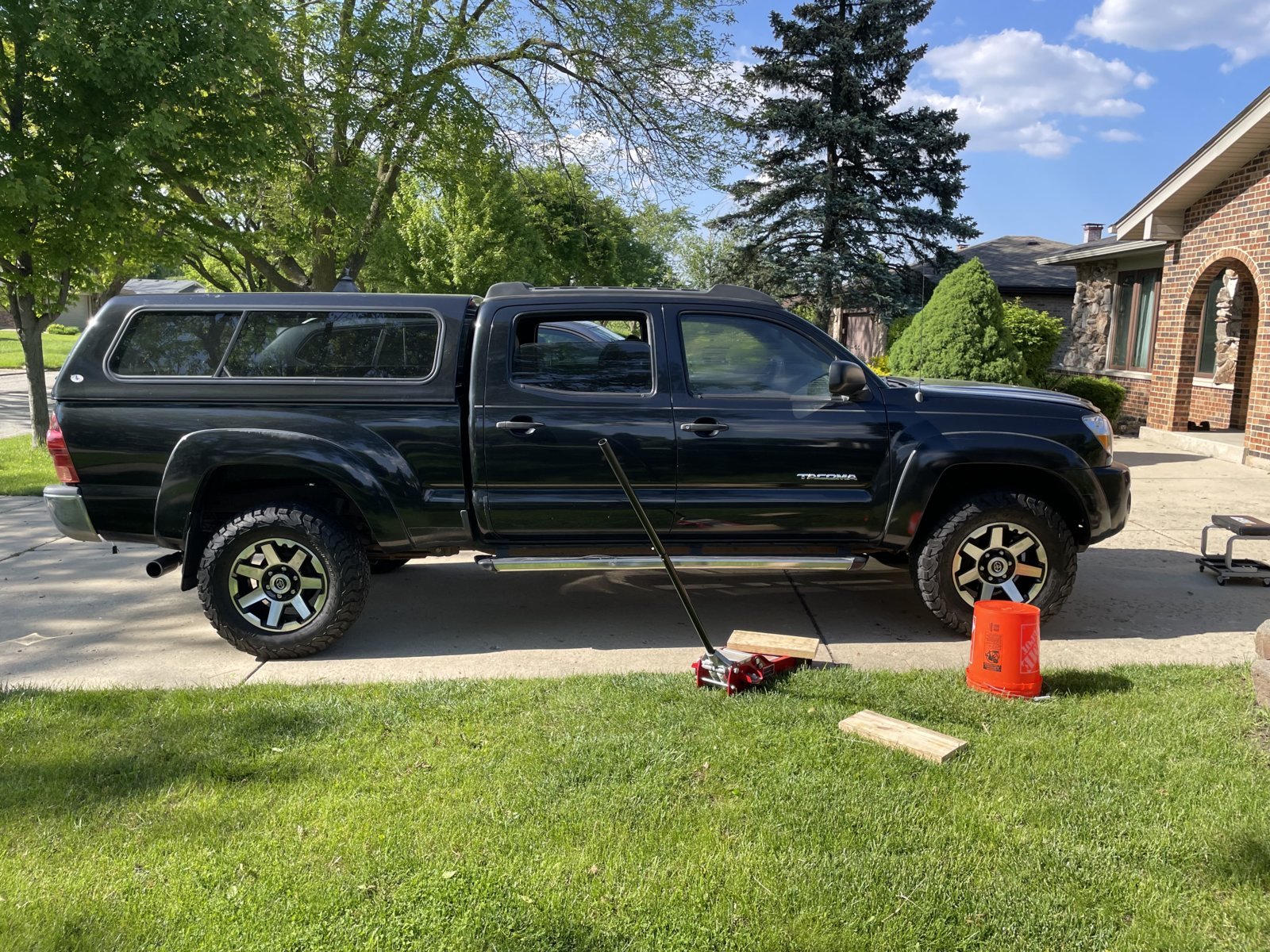

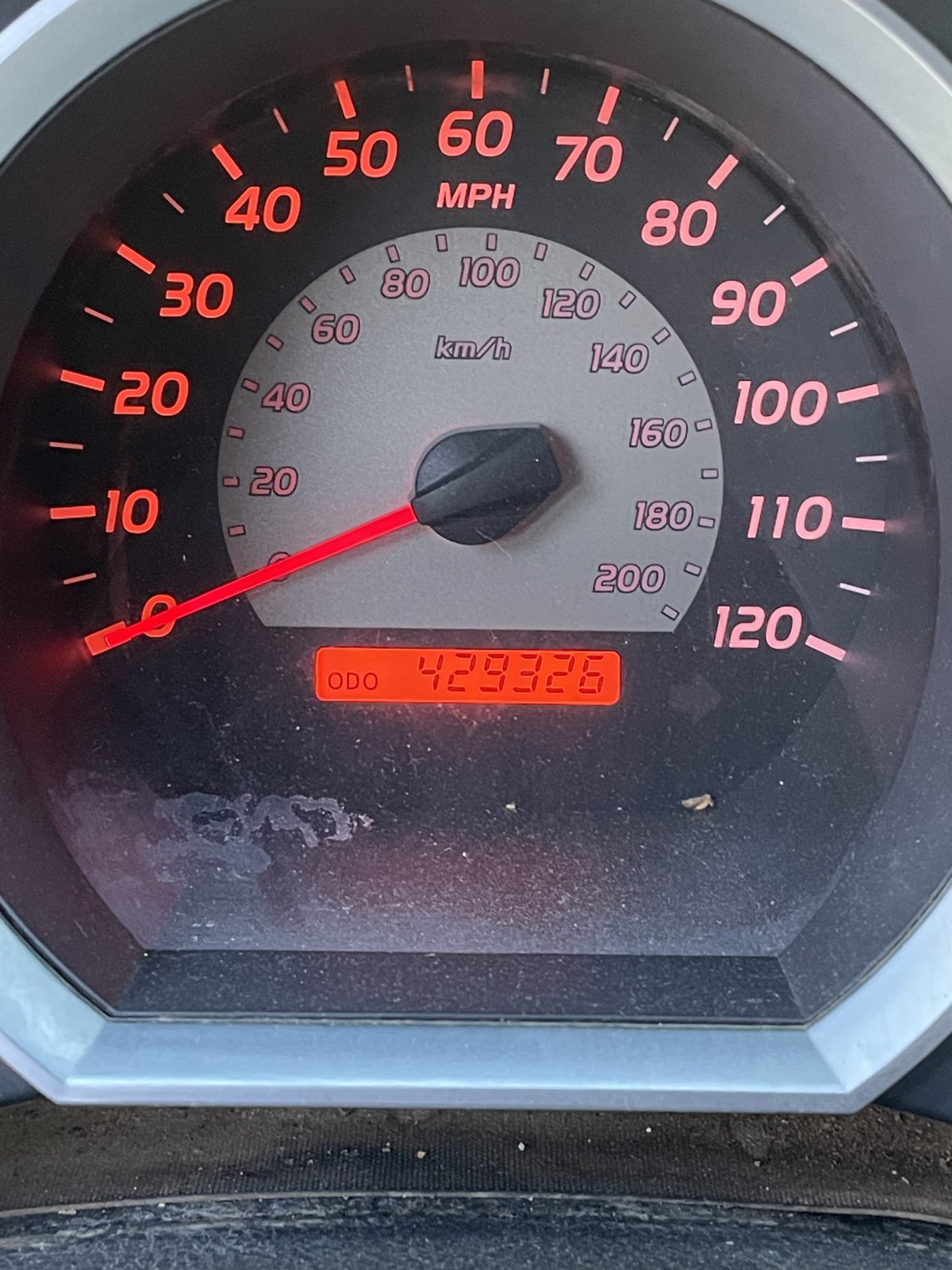

    Hey Y’all, new to the thread. Got my Dad’s old work truck (3 yr old son calls it Pawpaws tuck) that he sent to me when I was in tough times last year. 06 Tacoma just under 430k miles and starting to upgrade a few things. This forum has shed a lot of good insight on some repairs I had to do already and figured to share some things as I go. Got some new shoes today for her. Replaced the stock 245/75/r16 wheels and tires with 2023 4Runner wheels and 275/70/r17 BFG all terrain KO2s. Stock suspension so the tires rubbed a little bit on the front mud flaps so I had pulled those. Only slight rub at the right angle and if I hit a good bump now. I will replace the flaps once I put on a 2” level kit soon. Rear suspension has an added leaf spring that my dad put on before the recall. Happy to share the journey with y’all. IMG_1276.jpg IMG_1278.jpg IMG_1280.jpg

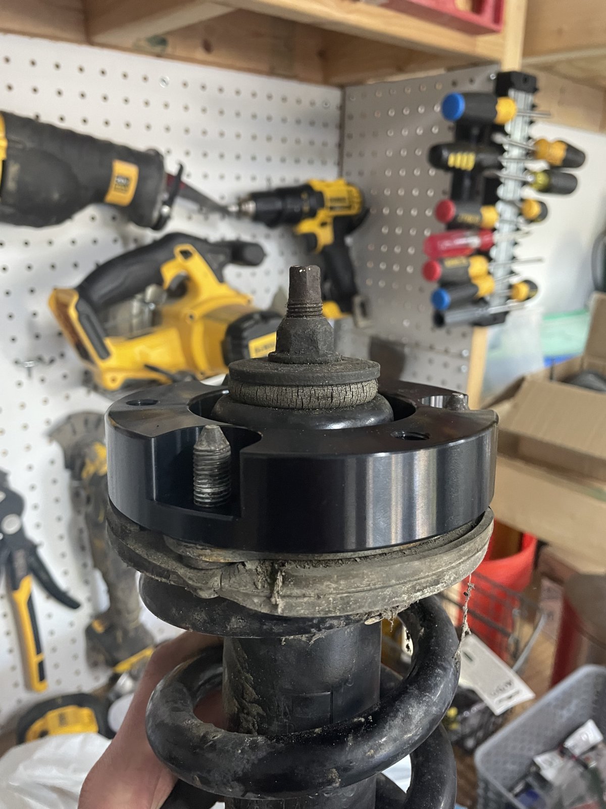

    IMG_1284.jpg IMG_1286.jpg 2” level kit installed. Had to trim down the strut studs 1/4” to fit but no complaints.
