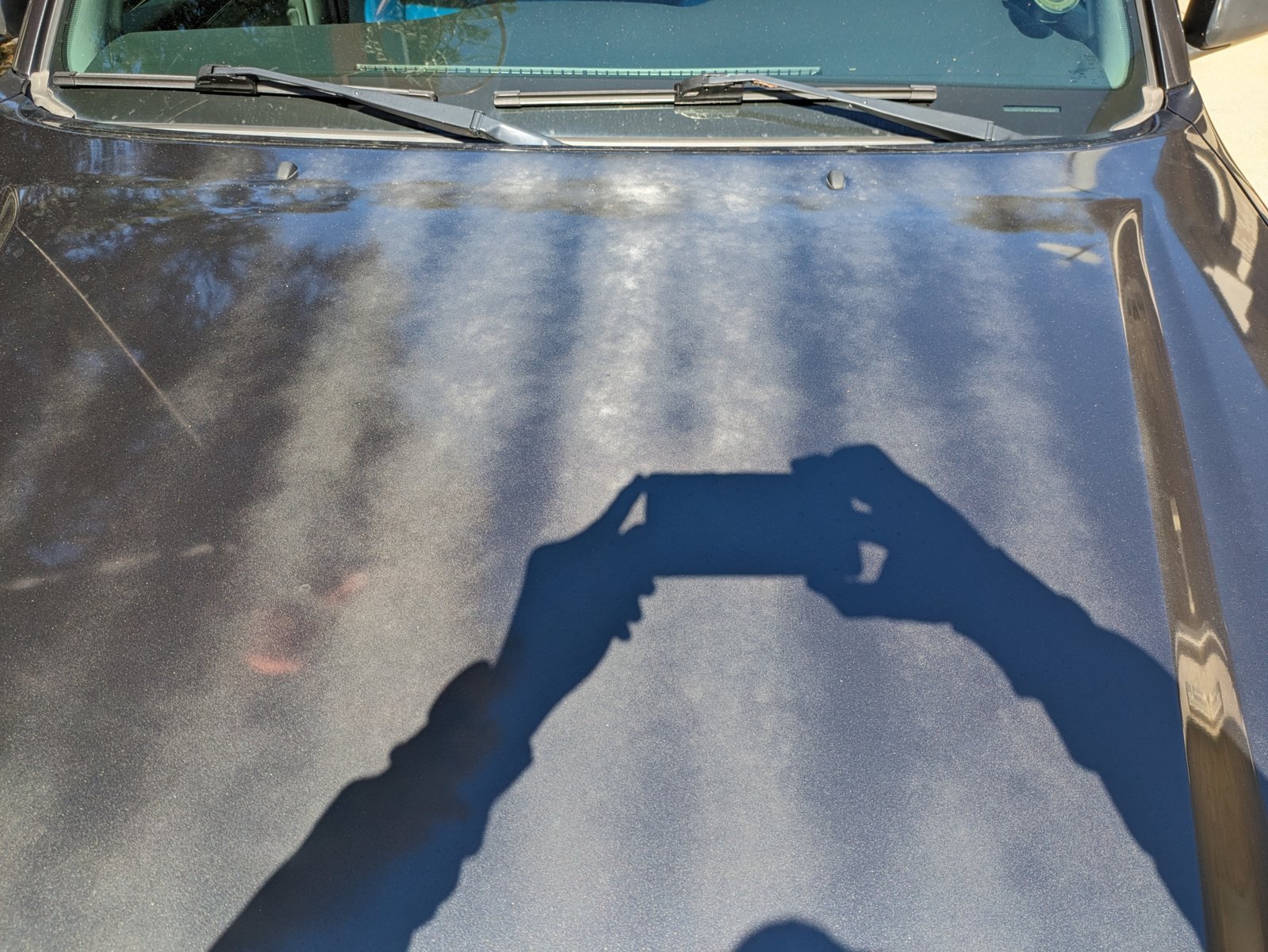

    I get what you are saying, but I'm not that guy.
    I took care her. Washed and waxed religiously.
    Here is a pic for those interested:

    If you have it repainted by a pro, I would think the freshly painted hood would not match the rest of the truck.
    The pattern of the damage seems like it was caused by a DA polisher maybe?

    Do you take it through an automatic car wash? My 2014 paint still looks really good and it's been parked outside for the last 3 years through snow and summer. Something has been scrubbing away your clear coat.

    I dont think I have ever taken it through a car wash, ha. Always hand wash.
    The clear was perfect while we lived in NY, but since I moved down to NC almost 4 years ago, the clear really started to degrade around a year and half ago.
    The truck lives outside and gets beat on with South facing sun all day long.

    Do you use a power polisher or anything like that? Soap and wax shouldn't be doing that to your clear coat. In any case, you could try to see if you can repaint the hood, but if you aren't familiar with the process, I strongly suggest a professional. $750 is a good price if the shop is reputable. The other thing to consider is long term goals. How confident are you in the DIY paint to stand up to your environment for the next 10 years?

    That damage is almost certainly just sun/UV damage. The paint on these trucks is not all that great in terms of durability. Normally, I'd think if it was waxed regularly with good products that this shouldn't have happened but there are a lot of variables here so tough to know for sure.

    Only thing I ever used was an orbital buffer to remove the wax, though I mostly used hand power.
    I do see more cars down south with failing clear. It may just be confirmation bias on my part, but I dont recall seeing as much clear failure up north.

    What wax were you using?
    How often were you applying it?
    Are you applying by hand or with a buffer?
    What type of compound were you using on the buffer to "remove the wax"?
    What type of soap do you use to wash the truck?
    Normally you wouldn't need a buffer to remove wax. It degrades on it's own and typically can be pretty easily removed simply by using the correct soap. You could have been unwittingly been removing clear coat with your buffer when you thought you were removing wax. Doing this a few times shouldn't be a problem but if you were doing it every 6 months that could definitely have contributed to the problem.
    It's not confirmation bias. Different areas have drastically different environmental conditions which affect our cars. Normally we talk about the rust prone areas but areas like Florida, Arizona, parts of California (and plenty of other areas) not only have intense sun but see more of that sun throughout the year. In my area, the sun is the number one battle to be fought. It wreaks havoc on paint, trim, rubber, headlights... pretty much everything. The switch to water borne paints (and specifically the 1st generations of this type of paint) is also a huge contributing factor. Older, oil based paints did a much better job standing up to UV rays.
