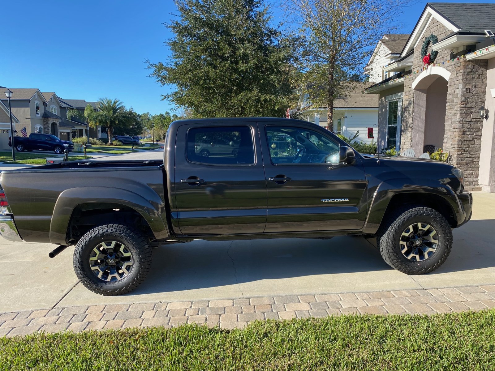

    Maaco full tacoma single stage paint job $2400 looks great and whole truck matches and shines with 3 year warranty. No dent repair done as did not care.
    Just do it and don't screw around yourself it will always look off and a pain to mess with.

    Nice work. Nothing beats a new shine. I do love a challenge, but considering the trucks we own are bad ass and a last of their breed, gotta have it done right for sure.

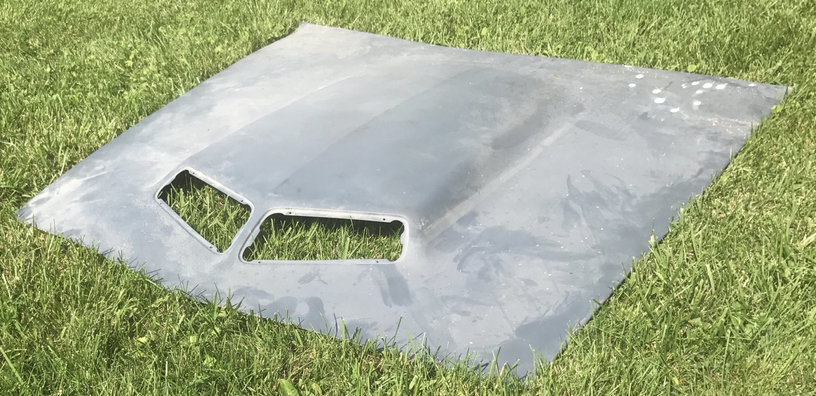

    This may be the summer i cut and pop rivet this ‘70 AMX hood skin I’ve had sitting around onIMG_4713.jpg then flat black and call it a day. We’ll see. I’ve been looking at doing this project for way too long.
