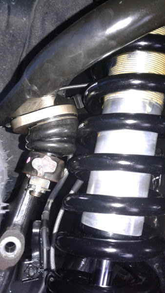

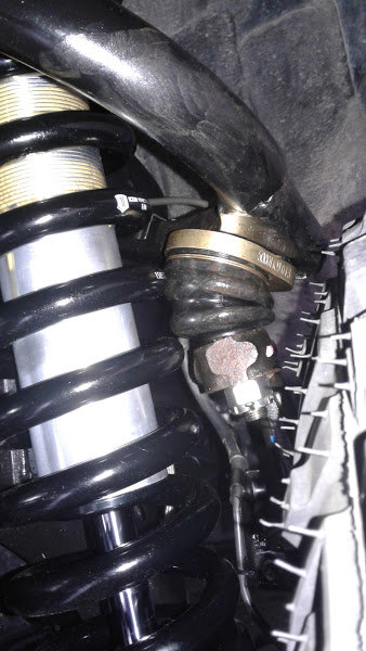

    3G Tacoma on 35"s, 5G 4Runner
    This. Most alignment techs are actually very ignorant - they just follow the vehicle-specific, step-by-step instructions spoonfed to them from the alignment machine UI. After I installed my 2" lift, the local shop made the alignment worse than my eyeballed settings - there was audible tire scrub even in slow-speed turns, and the upper ball joints hit the coil at full droop:
    2mL68ytfezjd95y3q-LQK8aFMJdfl9ONjz571Lxs_f7312f8028d829b4b66e6e5fc12a4f474364d809.jpg Ry2ubexhQ3zHMitSxANChllNmgNv12L64rPUGfN5_62d079da2ebe8095409dd9c4ca8234b4b7edf07c.jpg
    After talking with the service writer who tried to explain this was "normal", I decided to fix the shop's fuckups myself. Toe is set with fishing line to +/- 0.14 deg, using a ruler with millimeter markings:

    Damn! Even my extended travel shocks don’t have my SPC UCAs hitting the coil like that!

    The coils hit the upper ball joints because the alignment tech dicked around with the forward LCA cam bolts too much. Moving that cam bolt visibly moves the shock in and out laterally. When the LCA cam bolts are set for max caster (which coinicidentally also gives max tire clearance with the cab mount), the coils don't hit the upper ball joints.
    It's basic responsibility to make sure the parts aren't hitting each other as the suspension cycles. :facepalm:
    It's also beneficial to know a little bit about what each parameter does to the vehicle behavior rather than just trying to blindly match the "factory" numbers. My truck went in with about 5 deg of caster. My particular tech was trying to reduce caster to 2-3 deg because the software told him so. More caster is actually helpful on our trucks because it provides camber gain in turns, giving the truck more cornering grip.

    In my case I told the tech not to touch the LCA cams and make all adjustments from the upper ball joints. I also told him to leave caster alone and just get toe and camber close to zero. The tech was too arrogant to listen and did just the opposite, because that's what the UI spoon-fed him. Took him an hour and a half to make the truck drive worse than when it went in, and of course I got billed for $160.
