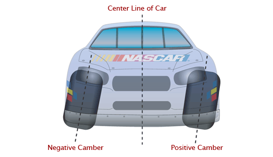

    That is funny. Using your theory, the picture that Stun posted of the Nascar means that the car would go straight I am guessing and I have no idea what should happen with the tractor. If either were pulling because of camber there would be a black tire mark everywhere it goes because that would be a whole lot of binding.
    It is kind of hard to support your position when science isn't on your side, isn't it? Here is another simple proof if you want to try to test you theory. Get a bicycle and lock the handle bars straight forward. Vice grips, tack weld, take your pick, but no ability to steer. Then ride that bike and tell me how well it turns. It won't. If you lean, you just lean. You will just fall over because it won't turn no matter how much camber you put into it. Using your flawed theory you should be turning tight circles putting some lean into it.
    I know, I know you have that song rageing in your head "I can ride my bike with no handlebars, no handlebars". Which is true. You absolutely can ride your bike with no handle bars and turn left and right with just a simple lean, but you know what, it isn't the camber that is turning you. It is the steering axis. When that steering axis doesn't exist, all the camber in the world won't make you turn.
    You don't have to take my advice. It is better you find out on your own. There was a time when I couldn't grasp the concept which is why I suggest getting the wood car demo from Hunter. It is probalby much safer than riding a bike that won't turn and you can see what happens with toe and caster as well.

    We’re still waiting on your proof.
    Unlike you, I have found out on my own. I prove it every time I align a 3 axle commercial vehicle.
    You’re the only one with less than zero credibility in this thread.

    To clarify (yes everyone is right)
    Camber can cause a car to pull for the following two reasons, only in scenarios where camber does not match in opposing angles right-to-left.
    Using Stun Guns picture (camber angles are parallel, not opposing):
    Assuming the rear wheels have no camber adjustments, and are straight up and down, the thrust angle between the rear tire contact patch and the drag of both front tire’s offset contact patch will cause the car to pull to the left due to the force vector between the front and rear contact patches.
    If all 4 wheels, or just the front wheels, were adjusted with the same amount of camber in opposing directions, Sungod is correct and the vehicle would track straight like it does on those crazy tuner cars.
    Secondly, if camber is so out of adjustment that the tread shoulder of only one front tire is starting to rub the pavement (after a crash etc), the different circumference of the tires tread shoulder will cause a pull, just like when you roll a cone-shaped object on the floor. It does not roll straight.

    Not everyone was correct. Because sungod didn’t spec his camber example. He simply said camber doesn’t cause a pull. And to be fair, not trying to be a dick, you did go get your truck aligned by someone else.
