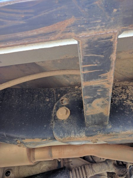

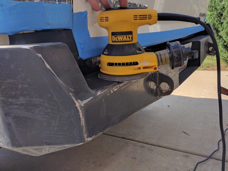

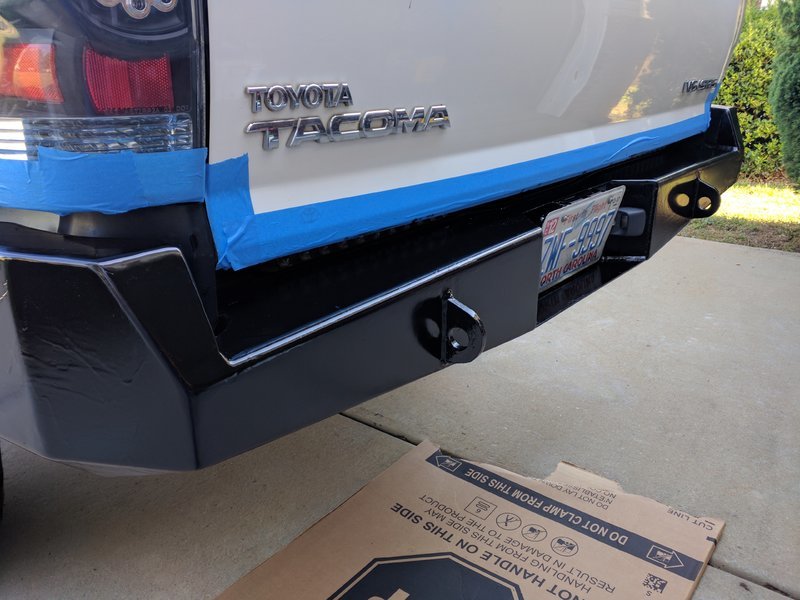

    I like KBS-coatings Rust Seal. I just sanded down and recoated after 2 years.
    unsanded slider legs
    Sanded rear bumper
    recoated/dried rear bumper
