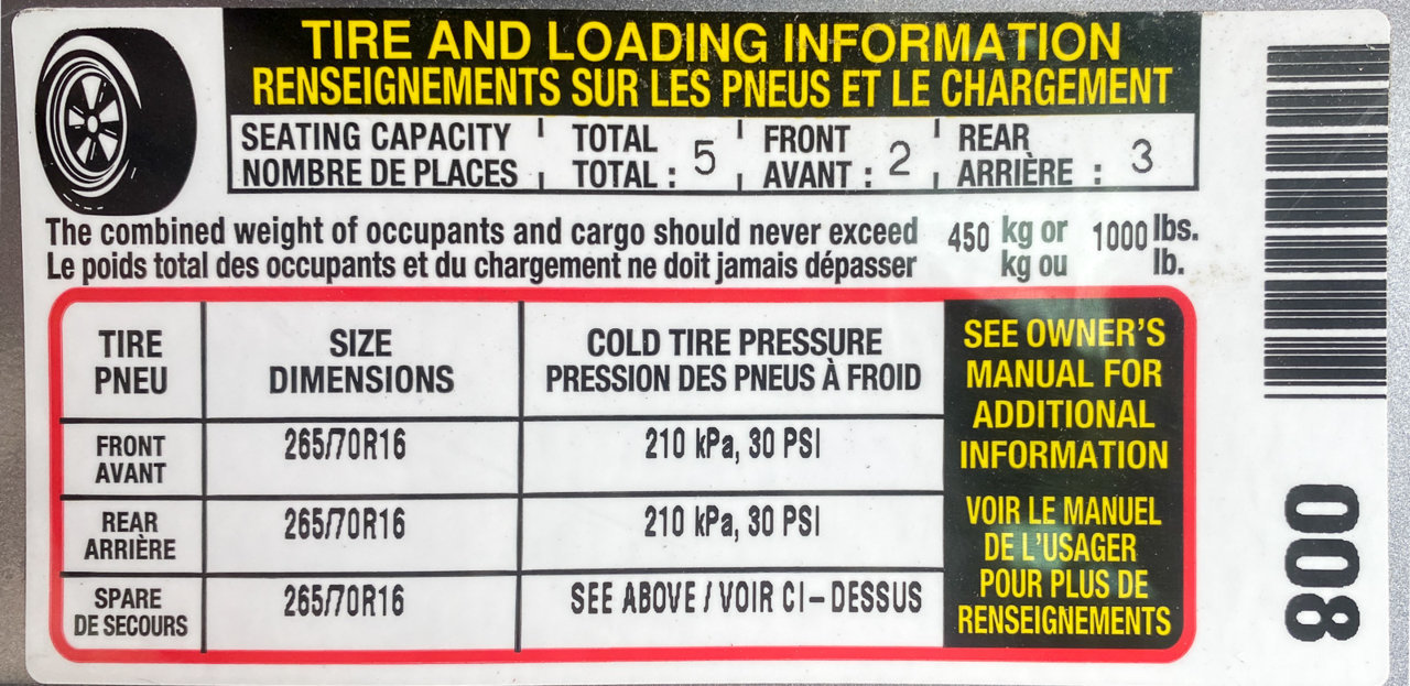

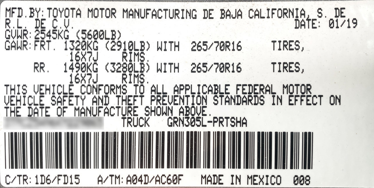

    You can find your Vehicle capacity weight (payload), Gross Vehicle Weight Rating GVWR), and Gross Axel Weight Rating (GAWR) on the front door jam.
    All applicable weights can be found in your truck manual for your specific model, along with Toyota's definition for each weight.
    Photos of labels on the door jam (the photos are from a dual cab 4x4 Off Road) -

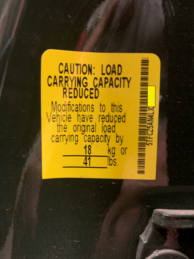

    You probably also have one of these stickers on your truck in the area of the tire pressure sticker that will show the reduction of your total payload weight (if any) resulting from options added at the factory or the port. Any added by the dealer will not be reflected here but would further reduce your total payload capacity.
