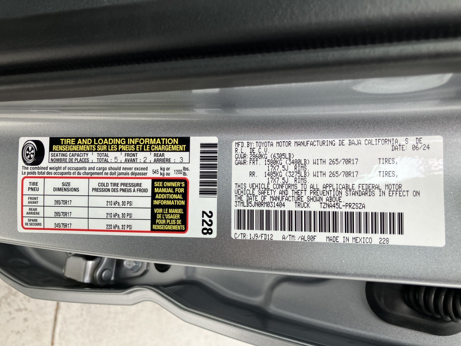

    Like a lot of you, I've been trying to figure out if the listed 1,600-1,700 lb max payload numbers for the 2024 are accurate, specifically for the TRD OR and the TRD Sport. I've looked at probably a dozen different trucks in different trims (SR5, OR, and Sport) at 4 different dealerships. For each one, regardless of how many options it had installed, the payload number listed on the door placard has always been the same...1,200 lbs. Trying to sort this out, I took a lightly optioned (heated seats, 14 in screen, mud flaps, and bed step) TRD OR double cab/long bed with a 1,200 lb door sticker, from a dealer to a scale nearby. The actual weight of the truck (without driver and with 1/4 tank of fuel) was 4,660 lbs. Given the truck's listed GVWR of 6,305 lbs, that yields a payload of 1,645 lbs, which is very much in line with what's listed on the Tacoma specs page. So, hoping someone out there can shed some light on this; if the "actual" payload is 1,645 lbs, why would the door placard show a payload of only 1,200 lbs? Do manufacturers sandbag these numbers for safety? If you happened to be involved in an accident, which number would define your "legal" payload?

    If anyone wants pics...

    thats super interesting. candidly i always thought the photo on the left was specifically for tire load specifications and not payload of the vehicle itself, with the right side GVWR calculation being the actual load threshold of the rest of the truck. maybe that's incorrect, however?

    After poking around some more, it looks like this blanket payload number thing isn't limited to just the Tacoma. A post I saw on a wrangler forum probably has the most likely answer; "I read somewhere that the sticker number is calculated based on base weight plus average of options added instead of weighing each individual truck at the factory."

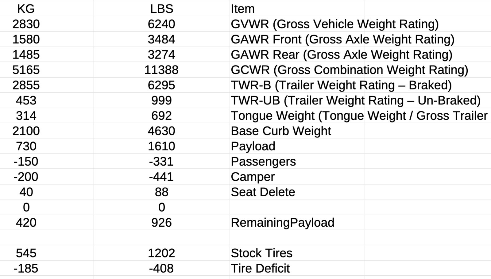

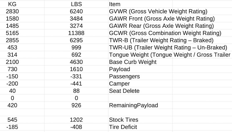

    This is the sticker and manual info for my OR. CW was scaled right on and going to rescale after build and fully loaded to double check. Remaining payload compares very well to other midsize with similar suspension travel/setup, but stock tires need upgrading. So easy to pack on the pounds.
