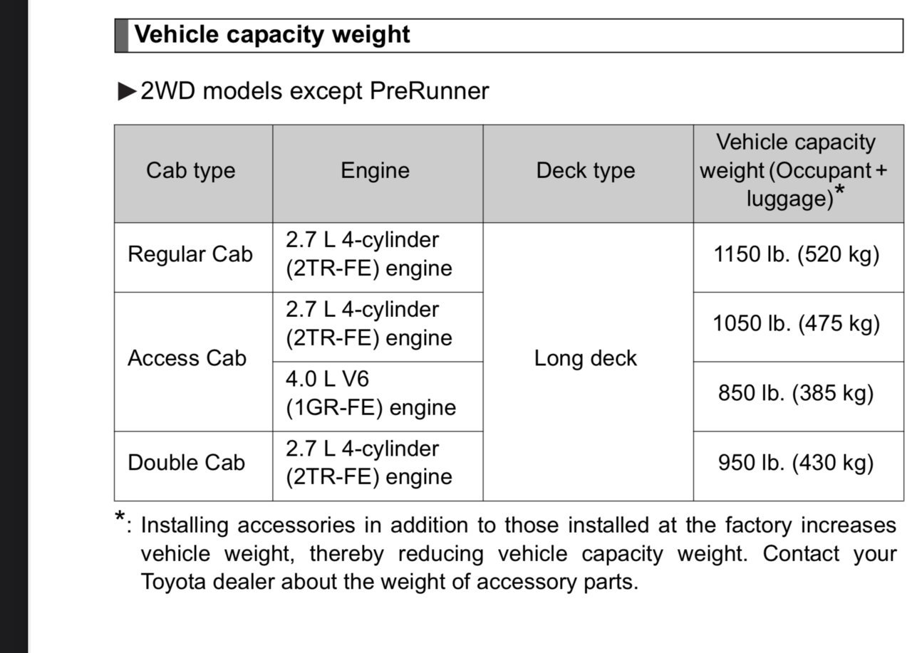

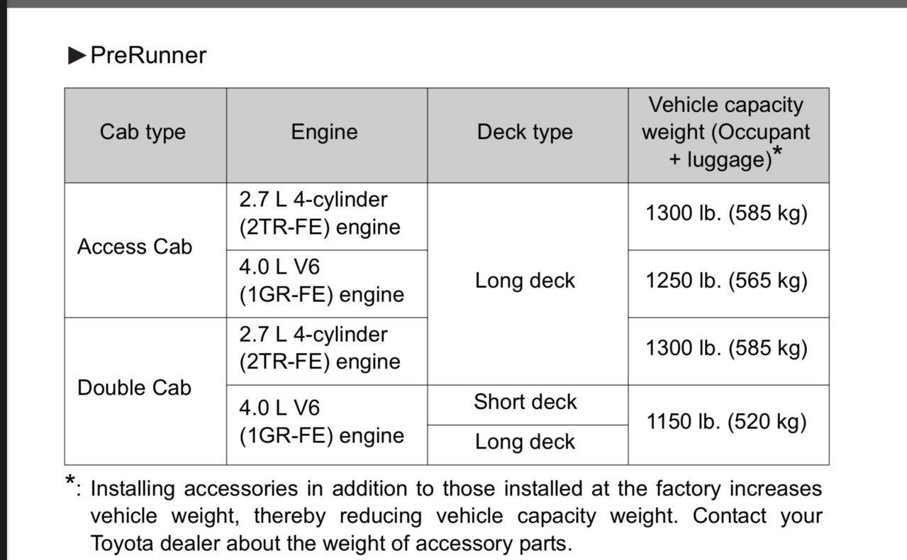

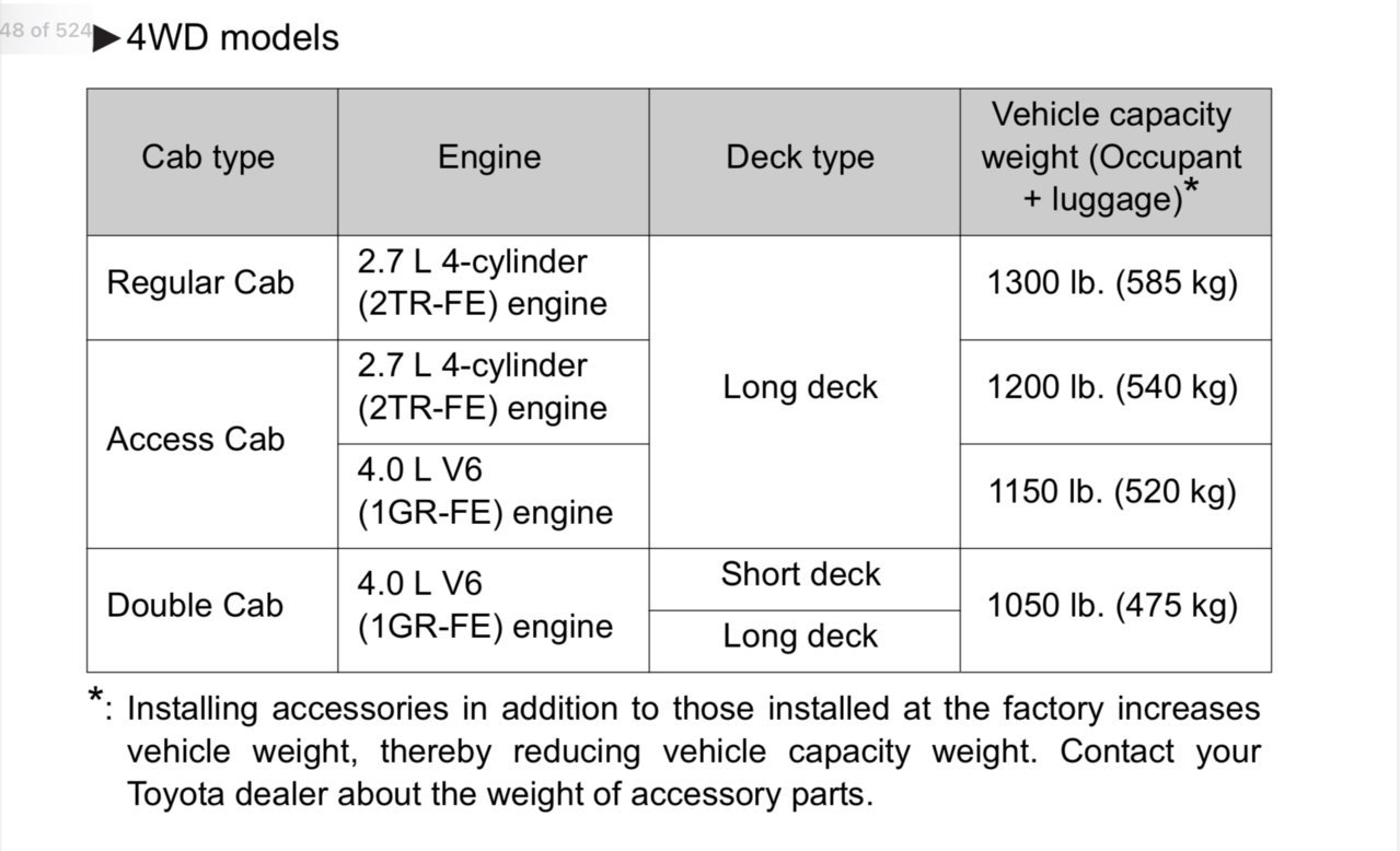

    Most of the owners manuals have it.
    Here is the 2013
    C32CBAB9-DE57-4B52-9BA5-6B74C0753053.jpg D1B5B888-C280-41CE-BA72-6FCA9B45E395.jpg 95C5B13D-73F9-4BD3-A627-15BEDDD1E299.jpg

    You're going to just have to look at the sticker on the drivers door frame because every truck that rolls off the assembly line is different. I don't know if they actually weigh the trucks, or already know what each option weighs. But if you take the trucks GVWR and subtract the curb weight that is payload. Trucks loaded up with options weigh more. 4X4 adds about 200 lbs to curb weight, and reduces payload by about 200 lbs. But a lot of little things add up too.
    You can look at the owners manual, or even Toyota's website but those will only show the MAX possible payload. Looking at current 2021 trucks a base model Access Cab 4X2 with 4 cyl engine has 1685 lbs payload. That is more than my F150. Go to Toyota's website, select different versions and then click on specs. Then click on weights/capacities When you scroll down payload will be listed among other specs. The numbers may be slightly different on older models, but should be close.
