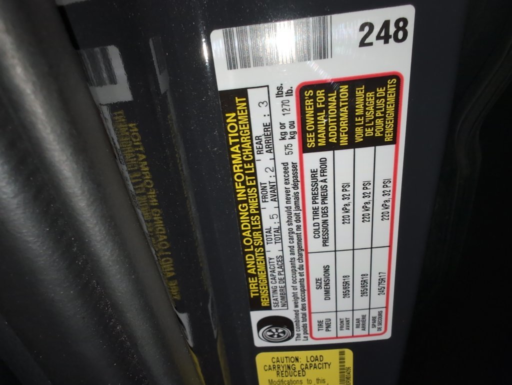

    I purchased a 2024 4 wheel drive long bed sport with premium package.

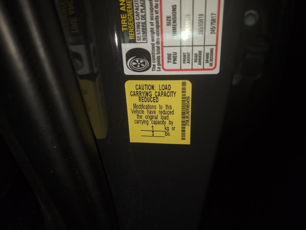

    The Tacoma website and documentation state approx. 1600 payload capacity. The sticker on the door however says not to exceed 1270 (with a payload reduction sticker of 3 pounds). Why the discrepancy and what is trusted source of truth? It can't be the premium package can it?

    The sticker is the truth. All manufacturers advertise the max payload(*) which is never actually attainable in anything other than a base model stripped down truck.

    This "recall" affects many years of Toyota and Lexus vehicles.
    My truck is a 2012 and had that sticker. I pulled it off. I've seen stickers with "0" as the change.

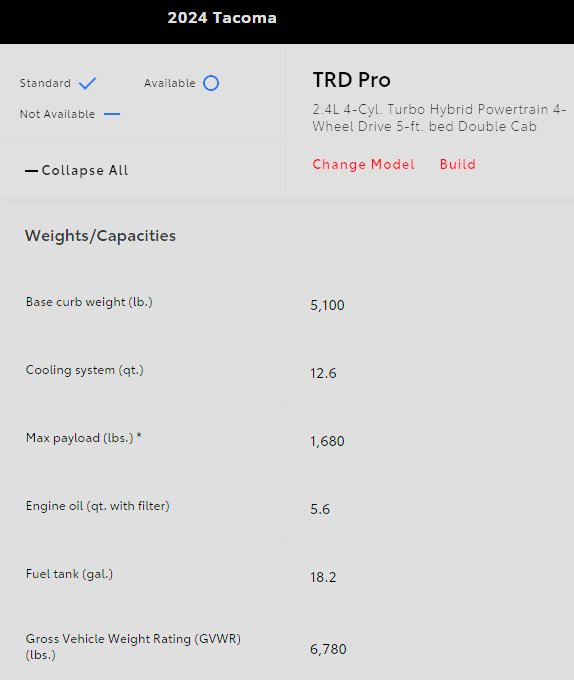

    The number on the website and literature is the highest possible payload. The GVWR of 6780 is the same on all trucks. They actually weigh the truck after it is assembled and subtract that number from 6780.
    A BASE trucks curb weight is 5100 lbs. Subtract that from 6780 and you get a payload of 1680. But you didn't buy a base truck. When you start adding options to the truck, they get heavier. If you're payload number is 1200 then your truck actually weighed 5550 lbs when it was assembled. You have 450 lbs of extra equipment on your truck compared to a base model. The 4X4 components add weight and a long bed is heavier than a short bed. FWIW, you're doing pretty good. I've seen some Tacoma's with 900 lbs of payload.
    Low real world payload numbers are a negative with Tacoma. Around 1200 lbs is pretty typical for a 4X4 crew cab Tacoma. But Ford Ranger and Honda Ridgeline will be typically a bit over 1500 lbs. That's real world payload, not paper specs.
