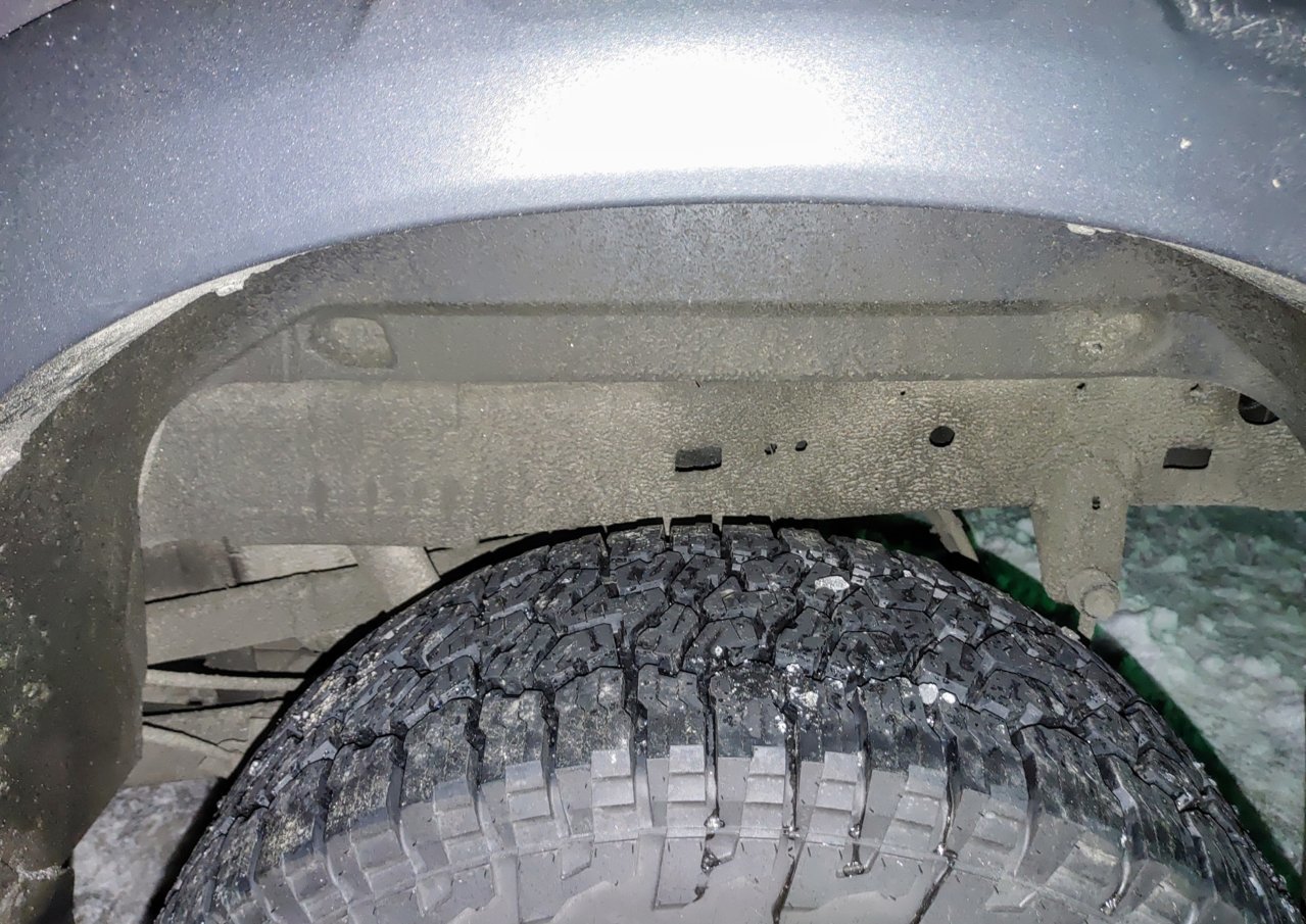

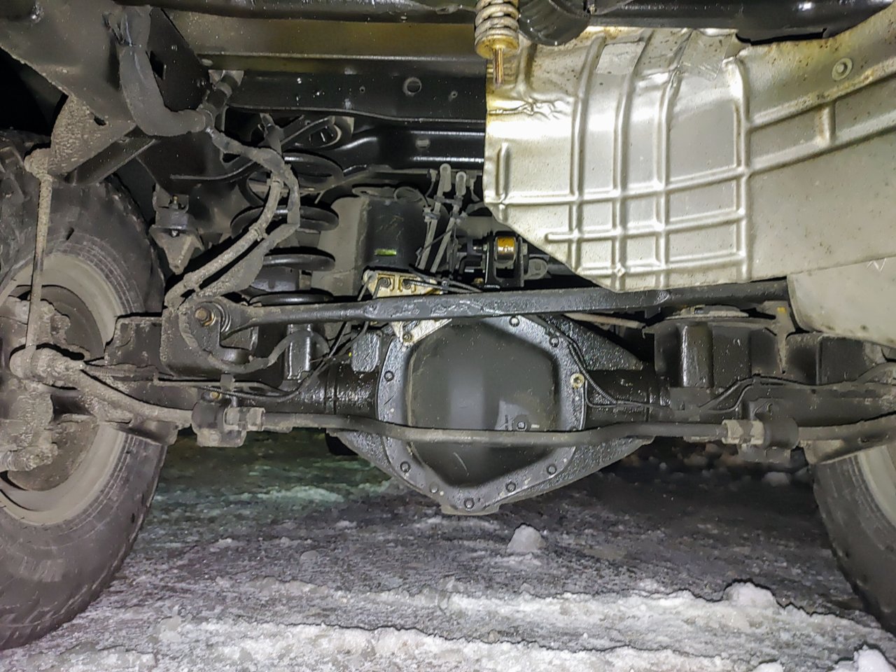

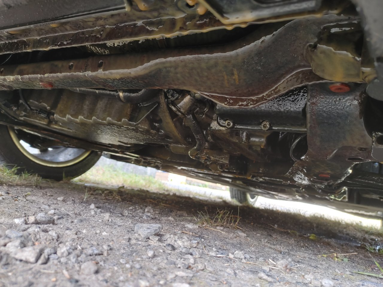

    For those that undercoat or live in the salt belt, a family friend had me spray his brand new 3/4 ton Ram in PB Blaster Surface Shield this fall to try it out. We used a 5 gallon bucket with an undercoat gun, used roughly 2.5 gallons for his Ram, about a gallon total to touch up my runner and my old man's Tacoma (Used FF last year), and another gallon for my Volvo.
    Ram owner came to visit today, and so far I'm very impressed with the stuff. Even with this incredibly salty and wet winter we're having in northern VT, it's showing absolutely no signs of coming off. High spray areas just built up a nice layer of dirt as expected, and the rest is still glossy. Holds up way better than FF / NHOU in my opinion, and doesn't reek when you spray it on either. I've used the other 2 for years as well and both work just fine, but just seem to spray off much more easily.

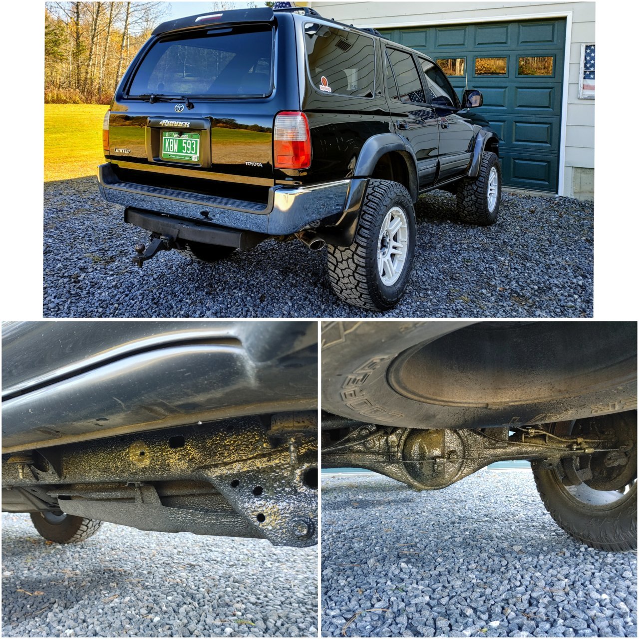

    The roads here have been soaking wet with salty brine almost every day since late November, and it's still just as thick as when it was sprayed on. My Volvos coating is holding up just as well, as is the 4Runner, though that doesn't see much winter use.

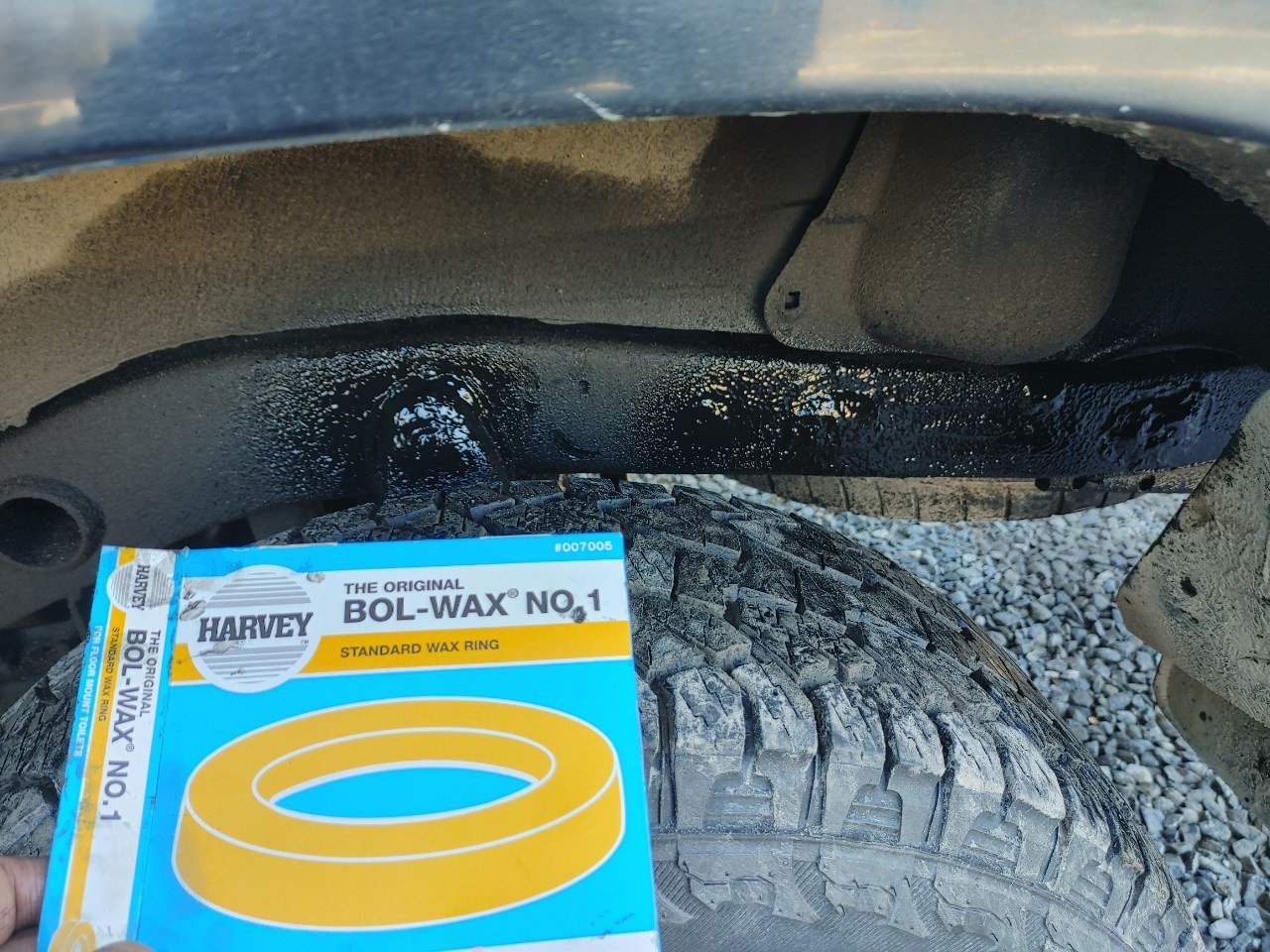

    And just as another apparently controversial tip, you can use sections of toilet ring wax to plug up your factory frame holes in the high spray areas to keep the salt from your tires out of the boxed sections of your frame. Or really anywhere else you don't want it. I've been doing it since 2014 with great success. But take that with a grain of well, salt :notsure:

    Volvo, fresh it looks just like regular FF:
    Runner with FF Black and plugged factory frame holes, fall of 2020:

    Good to know. Might look into it next year. Any sort of issues you saw applying over old FF? Ive got like 10 coats of FF on my truck haha
    Also thats a pro tip on the wax ring. Will look into that this summer

    If you get it in a bucket it is very, very thin comparatively. But still does a great job holding on. And yeah! Highly recommend the wax rings. Insides of my frames have always been clean come time to spray them out in the spring.
