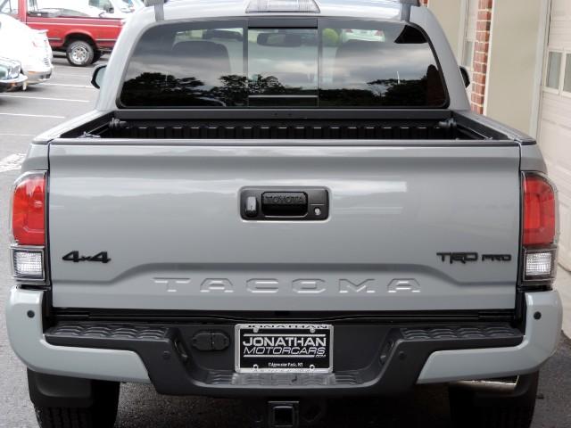

    • RE: SSO bumper
      • I’m not too worried about sag. The bumper is a little less than 60 lb and the winch is less than 100 lb. I’ve heard of others running stock suspension with the setup. Front bumper may sag an inch or so. I’ve heard of others say they notice it when driving but it isn’t a huge impact. I really hope it doesn’t cause any rubbing or any negative impacts to drivability.
      • I don’t intend on upgrading the suspension unless absolutely required. If I do, it’ll be a very mild lift/suspension upgrade to compensate for the bumper/winch in the front and topper/drawers in the back.
      • I’m not planning on keeping my hidden 32” light bar once I have the bumper. I’m almost positive that it’ll interfere with how the bumper and winch mount. I will be installing the 20” Heise lightbar in the SSO bumper which is coming with it. It’s not blacked out like I would like and not one of the high end brands but I can’t imagine spending $500+ on just a light bar that I rarely use.
    • RE:Baja fog lights
      • I use them for rain/fog primarily not daily use. I really think they are okay for daily use or rain/fog use without blinding other drivers. I’ve never had someone flash their high beams at me.
      • The biggest thing I’d recommend is angling them down (more than you would think) so that they light up primarily in front of the truck and not overpower your low beams by stopping behind them (they normally shine out pretty far when they are perfectly level). With that setup, I don’t think you’ll have any problems.
    • RE: Rear Rigid lights
      • I don’t have have BSM but I don’t see why it would affect it. Those are in the outer bumper caps I think with the reverse signals in the outer and inner bumper pieces.
      • I’m planning on installing these in the center plastic parts of the bumper (no cutting of metal). See below for where I got the idea and some other good installs. I haven’t had a chance to install these yet.
      • For now I’m just wiring them to a switch but I may wire them to the reverse lights (to come on when I put the truck in reverse) as well with a diode if I can figure out how.
    • RE: Amazon rock lights
      • I’d love a Switchpro but I haven’t been able to justify the cost. It’s definitely a much cleaner install than the way I’m doing it and pretty much necessary if you want to install more than 3-4 lights/accessories.
      • I’m not a hardcore offroader by any means. They are definitely a little gimmicky but that’s okay for me since it was less than $100 for all of the parts.
      • My main use is to light up around the truck at night when I’m working on it or around the campsite when we camp. It’s really nice having all of that light around/under the truck for those purposes. I also have it for at night if I find myself on dirt roads/light offroading after the sun sets. It’s nice having light around the truck to help see any ditches/rocks to avoid (both for me and whoever may be behind me).
      • For now I’m just wiring them to a switch but I may wire them to the interior lights (as courtesy/puddle lights to come on as I unlock/approach the truck) as well with a diode if I can figure out how.

    ah... cool, thanks for the pictures. I think there's extra sensors in the bumper besides the blind spot monitoring for the reverse sensors (maybe?), but I don't think they live in that black piece in the pictures you shared.
    pc3coyote[OP] likes this.

    It looks like there are 4 reverse sensors in the rear bumper and 2 are in the black plastic portion. As long as you installed the Rigid lights below them, you shouldn’t have a problem. See below.
    The BSM sensors are on the far ends of he outer bumper caps so no issue with those I don’t think. See below.
    Another option is to install only 1 to the right of the license plate like below. That definitely wouldn’t interfere with any sensor placement. It looks plenty bright as well. See below.
    Hextall[QUOTED] likes this.

    FWIW I’m fairly certain those 4 black things are reverse sensors, and the BSM radars are behind the plastic on each corner. That’s why the bumpers are plastic, so it doesn’t interfere with the radar.
    pc3coyote[QUOTED][OP] likes this.

    You’re right! I wasn’t familiar with the sensors since I don’t have the tech package. I updated my post above (included below).
